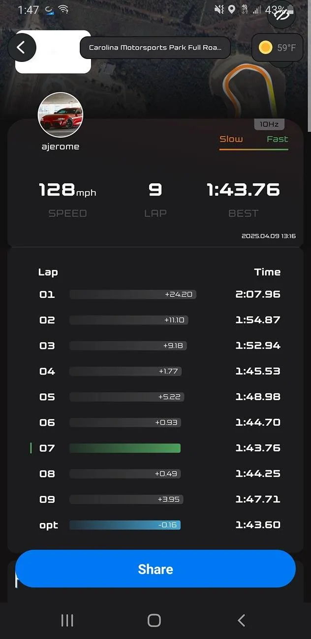

Managed to consistently hit 1:44.6s last month at CMP as I got more comfortable with proper track tires and brakes. Went back yesterday with goal of low 1:44s or God forbid breaking into the 1:43s as track conditions were similar. Was able to achieve my goal with a 1:43.76. Shoutout to @Traxion and @AHP for their advice and help along the way.

man that's awesome-nice win!
