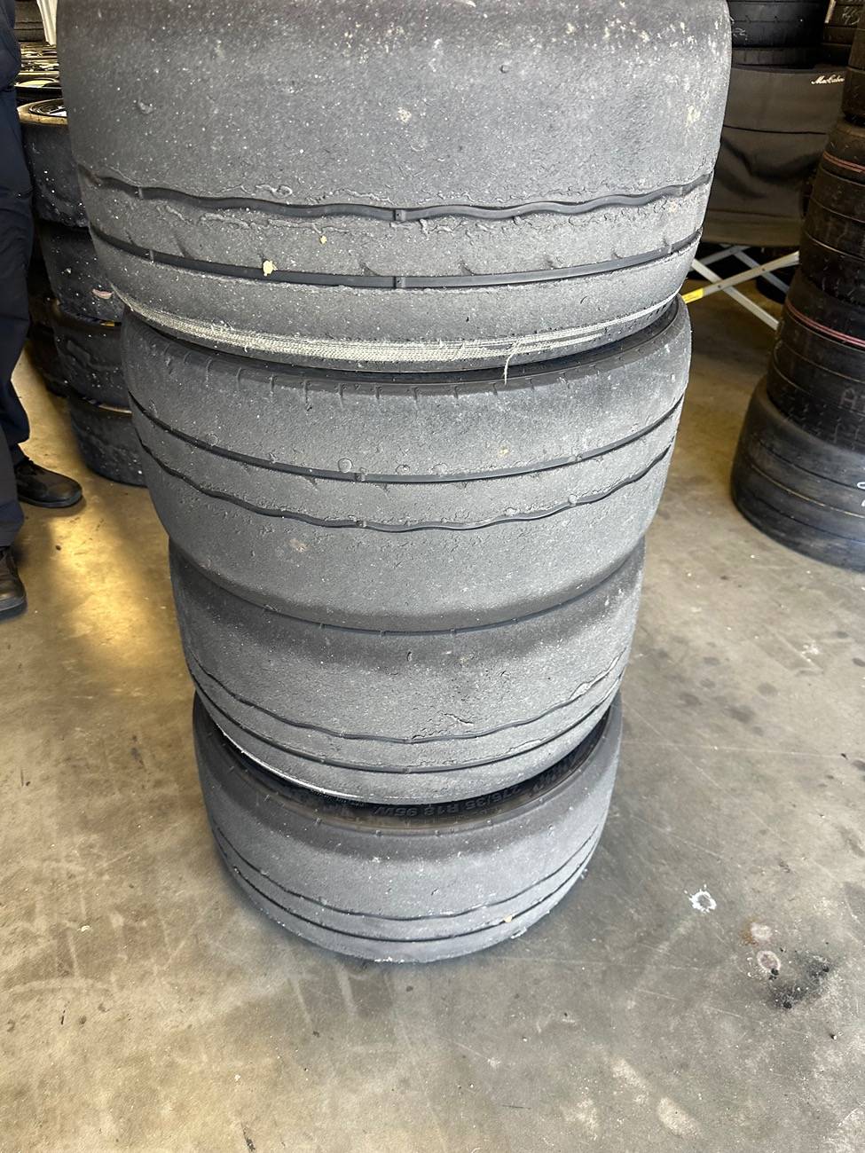

Well this was a 1st for any car I’ve owned…

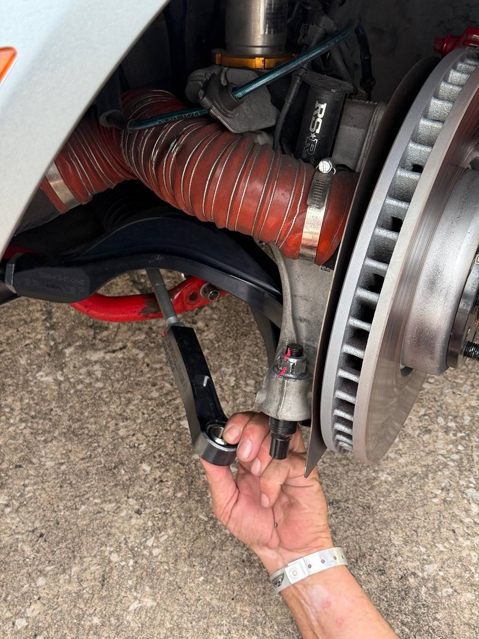

Corded the inside left (driver’s side) tire. Granted I did a lot more in town driving than I usually do and busted an end link while driving at Sebring (turn 17). A button screw (they called it something else) came off on track.
Luckily a friend had extra parts (lug nut & spacers) in his truck and we matched up the thread size and pitch. Had to take the other side apart to do it ofc. Anyway, that has now been fixed. Verkline sent me the parts from across the ocean (took 4 ever). It was odd because the part came preassembled. So we asked them if they had a service bulletin or to start one.

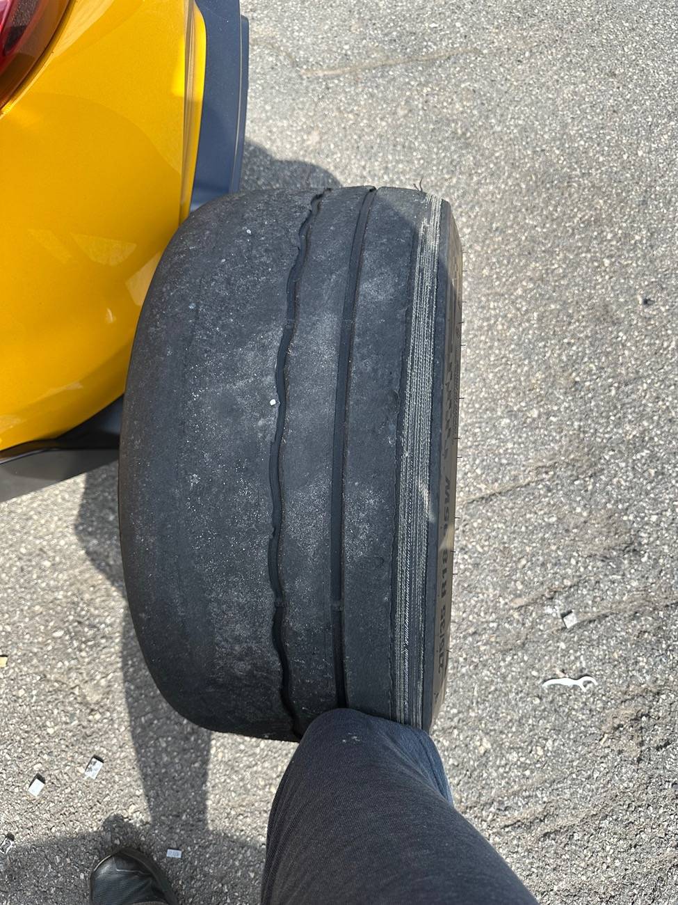

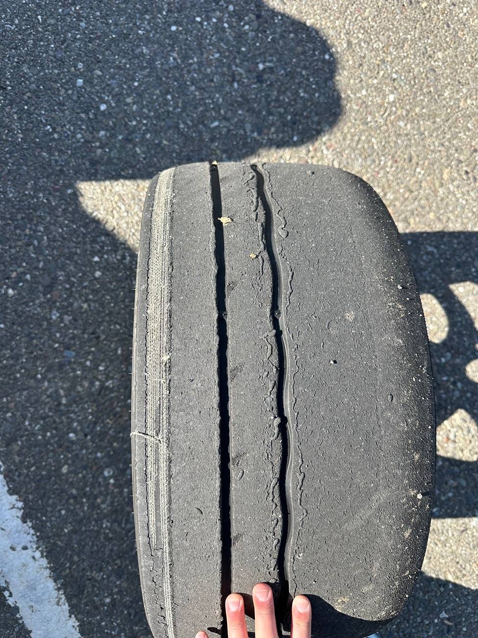

Regardless noticed my tire yesterday when they were installing the replacement parts from Verkline ?. I’ve never corded on the inside. My camber is approximately -3.6 up front and we put some toe out, which I like. I had to emergency counter steer (scrub) under hard braking while slowing her down entering the turn. She was forced to go straight from 145 mph with that tire not being able to move until about 50 mph. I finally got enough small turns in to make it off track to the pit out (happens to be right there off turn 17 at Sebring).
I believe I did about 5-6 track days on those tires, 2 other weekends. I knew this would be the last 3 days (weekend) on them and brought my backup set. I did get a full day Friday before this happened. It was an all you can eat (drive) buffet style track day, so I did put in a LOT of time. But I’m having a hard time believing this happened from that end of day incident.
Any ideas or thoughts on to why I corded on the inside? I didn’t get a chance to talk to the head mechanic yesterday when I picked up the car. I’m thinking it couldn’t be too much negative camber. I know Guthrie, Bob, Bryan and many other peeps runs with just as much or more neg camber than I do and drive just as hard (fast) or harder w/out cording there 1st. I’ve always corded on the outside 1st when looking for tire wear. In fact I was really happy to see (or think) they were wearing much better, lol. I’ve got replacement tires but now it’s getting a bit late for me to go back out ?. I might do a day with Chin just to try out the new seat again in a few weeks. My times were off that day and something felt off. I should have known just to throw in the towel and check under the car sooner. Hindsight is always 20/20.
If anyone else needs the entire Verkline catalog diagrams for our Supra, see below for what they sent me. The Stateside company is a middleman for the main company over in Europe.
https://drive.google.com/drive/folders/1bEiiArbMPhojfa_vtYBemcDk9GCau7bb
I‘ve got all their parts except the bushings and subframe, been happy otherwise ?. I’m currently working with them figuring out why this preassembled part came undone. Will let y’all know what we find out and/or hopefully a service bulletin will follow.

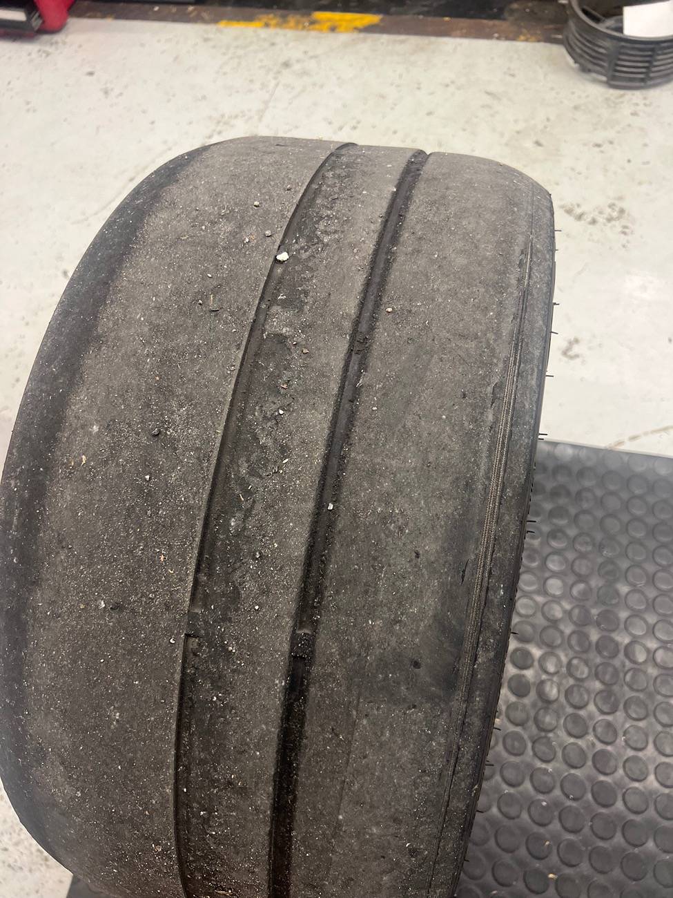

I also corded the inside tires on track last weekend. Thankfully had the tire guy on track and went back on next session.
I only have camber plates for suspension fyi and 2.6ish front camber
I've noticed a pattern that it's the V730. @Rensuhlo, @FLtrackdays, @rwense and now you.
