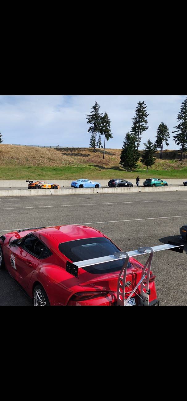

I don't have any good pics but will get some.
It's a prototype and I am no master fabricator so don't look too close or you'll see all my back yard hackery. First dry day shake down was yesterday and it stayed attached to the chassis so next will by making or perhaps buying a carbon wing to replace the aluminum one that weighs ~20 lb.
whoa whoa whoa you can't waltz in here with that neat reverse swan (goose-neck ?) wing mount and not show us more pictures

Yessir!

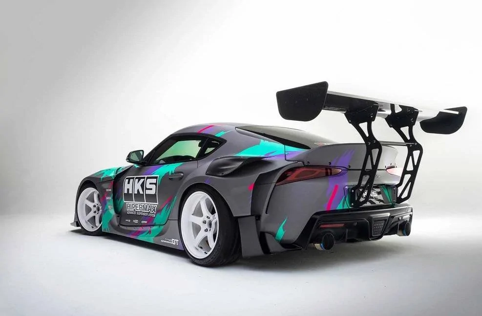

Works great and especially for the price and nice people to deal with. I'm just not keen on having that weight sitting that high up
Stole the chassis mount location for HKS. Funnily enough I met a guy yesterday at the track who built a similar wing but MUCH more professional and refined. Also much faster than me
I spy with my little eye... a winglogic sticker?
