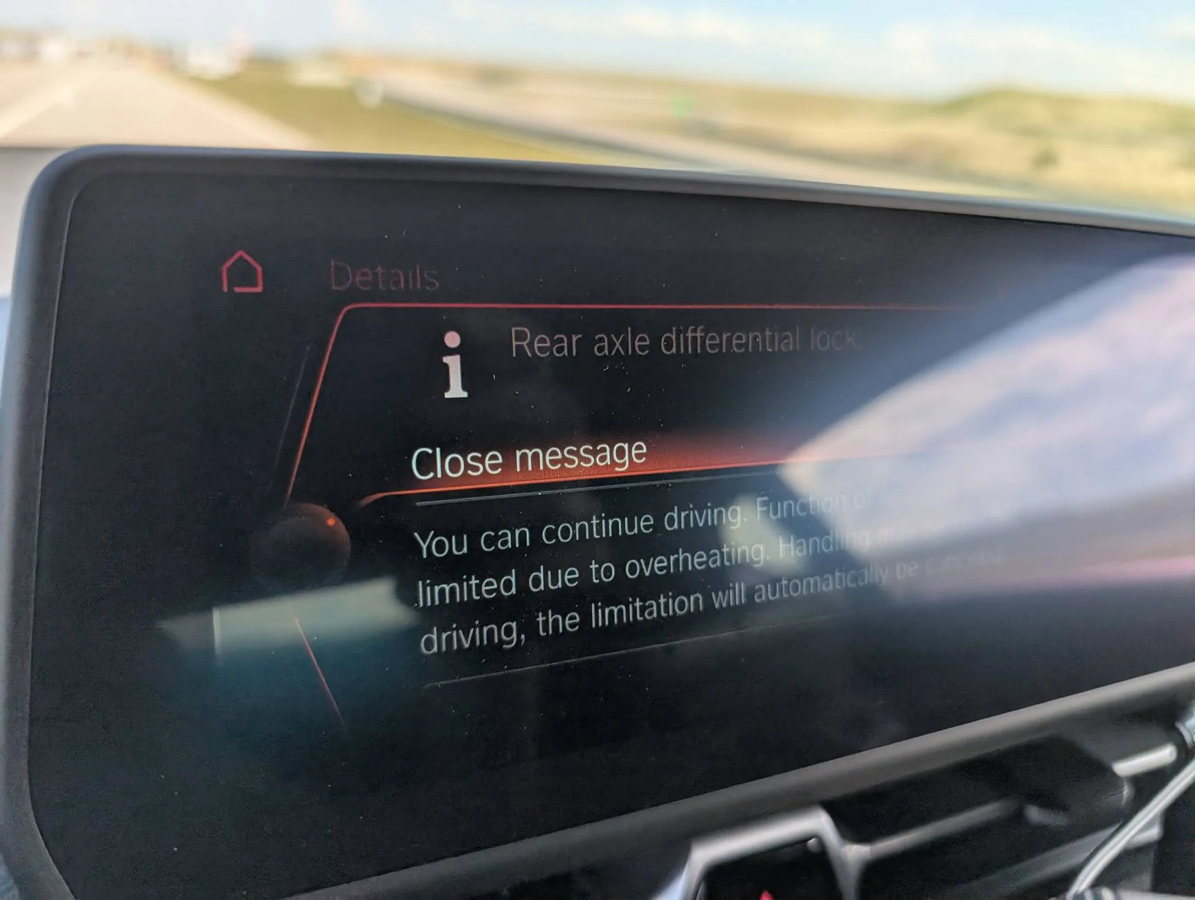

Anyone ever have this happen? This was a longer session, maybe 25mins but it wasn't hot ~75°F ambient. I was driving hard for most of the session. This was the last session of the day, I parked the car and 45mins later when I went to drive home the message was obviously gone.
I do change my rear diff fluid at the start of each season but wondering if I should be doing it even more frequently? Only 2 track days this year so far, with another 3-4 planned.
My car is at the dealer for this specific reason. It happened to me for the first time on a wet day where I wasn’t driving with the TC all the way off.
It’s gotten worse over time - now I can replicate it at will by punching it from 30-80mph and dismiss it at will by driving under 20mph for a few minutes.
EDIT: Although your error specifically calls out overheating - mine does not. I’d look at the Verus rear diff cooling plate and change your fluid again since it’s likely toast.
