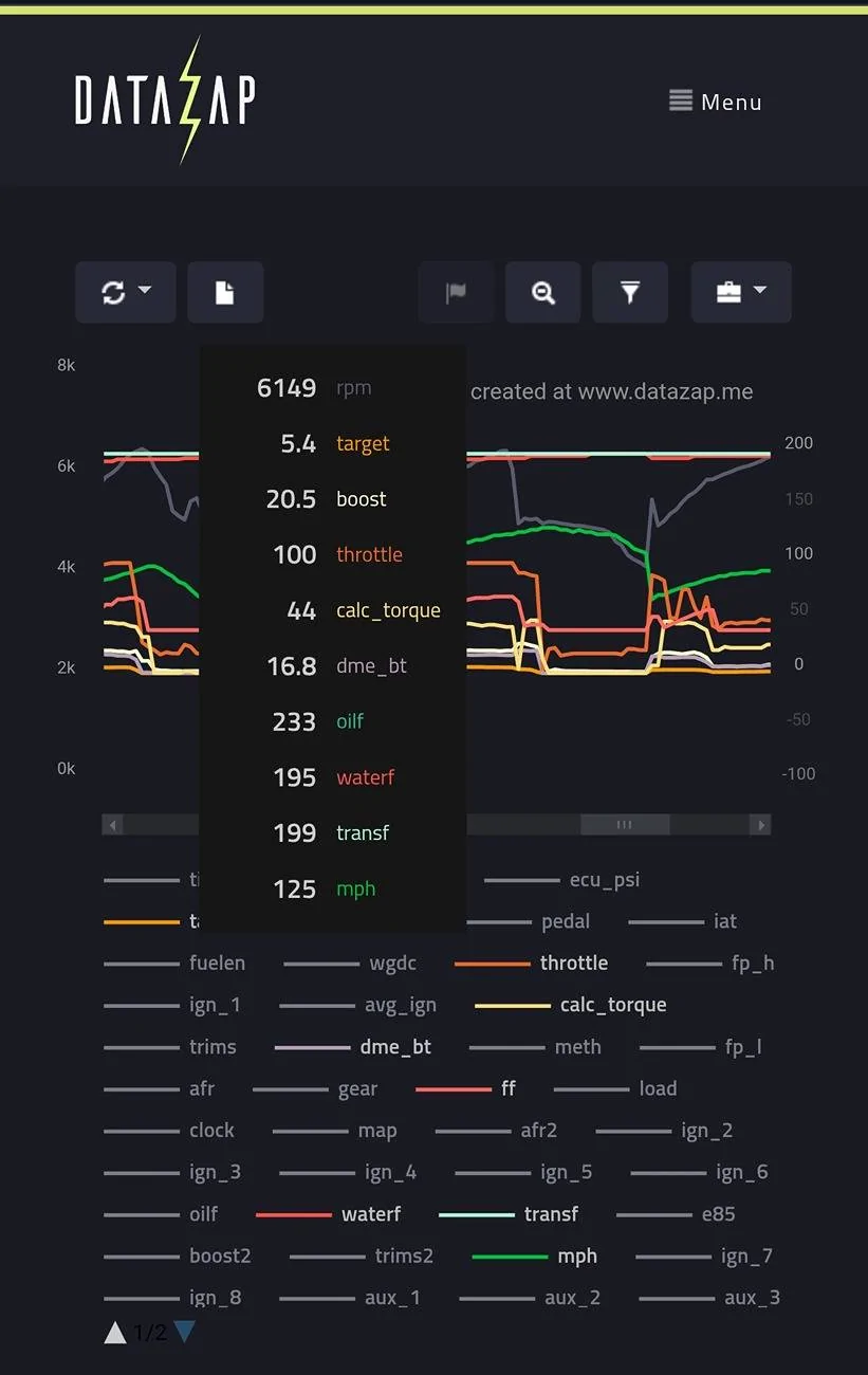

Learned this weekend that 22psi is definitely too much for the stock turbo especially in upper 80s ambient temps. I saw 243F coolant, 296F oil, and 148F IATs, even with the Verus oil cooler and a Wagner manifold.
After setting a boost max of 19 psi in BM3, temps dropped 10+ degrees on both coolant and oil and IATs stayed under 140, and the car was actually 1.5mph faster on the straight at Mid Ohio vs the higher boost map.

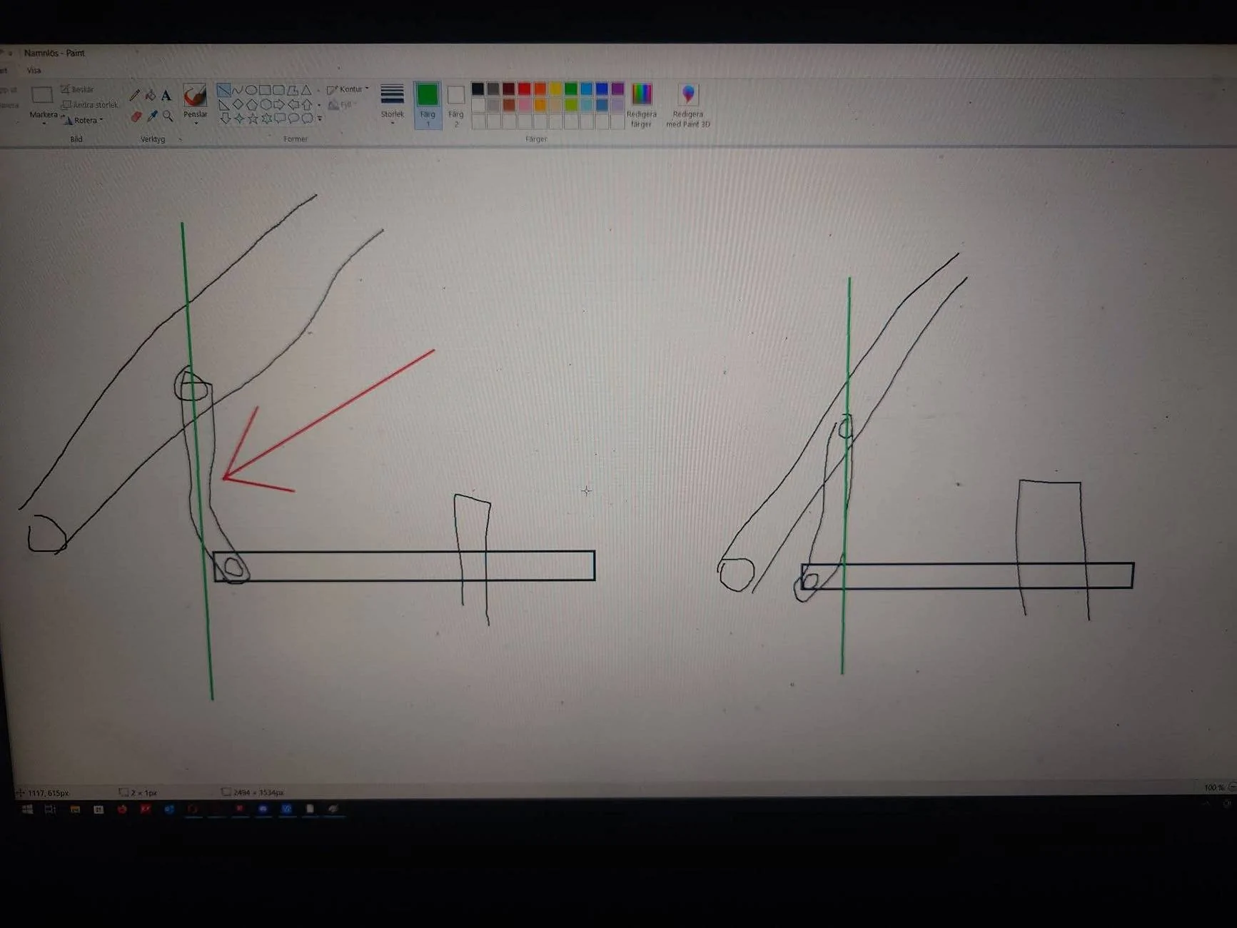

Not my video, but this has summed up my experience for the past 15 years with these aqful goddamned things. The issue is that the mechanism's geometry causes the connecting rod to toggle into a binding position, that you need to poke at the pin with a screwdriver to toggle it back.
I would have hoped that one of the knockoff branda would have figured this out and fix the geometry now, but according to the PA Facebook group, no such luck. Between that, the plastic getting brittle over time (even on the genuine ones), and the fact that you have to cut two giant holes in your hood meaning that you are stuck in the aerocatch ecosystem. These pieces of shit bring my piss to a boil.

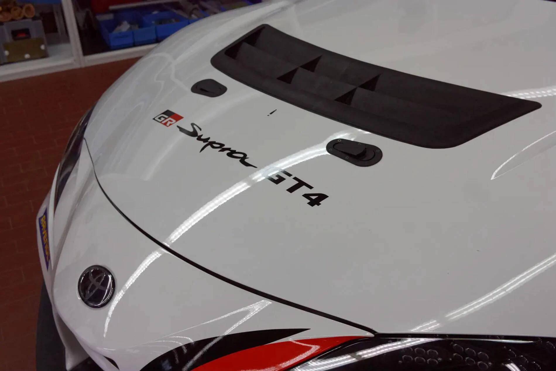

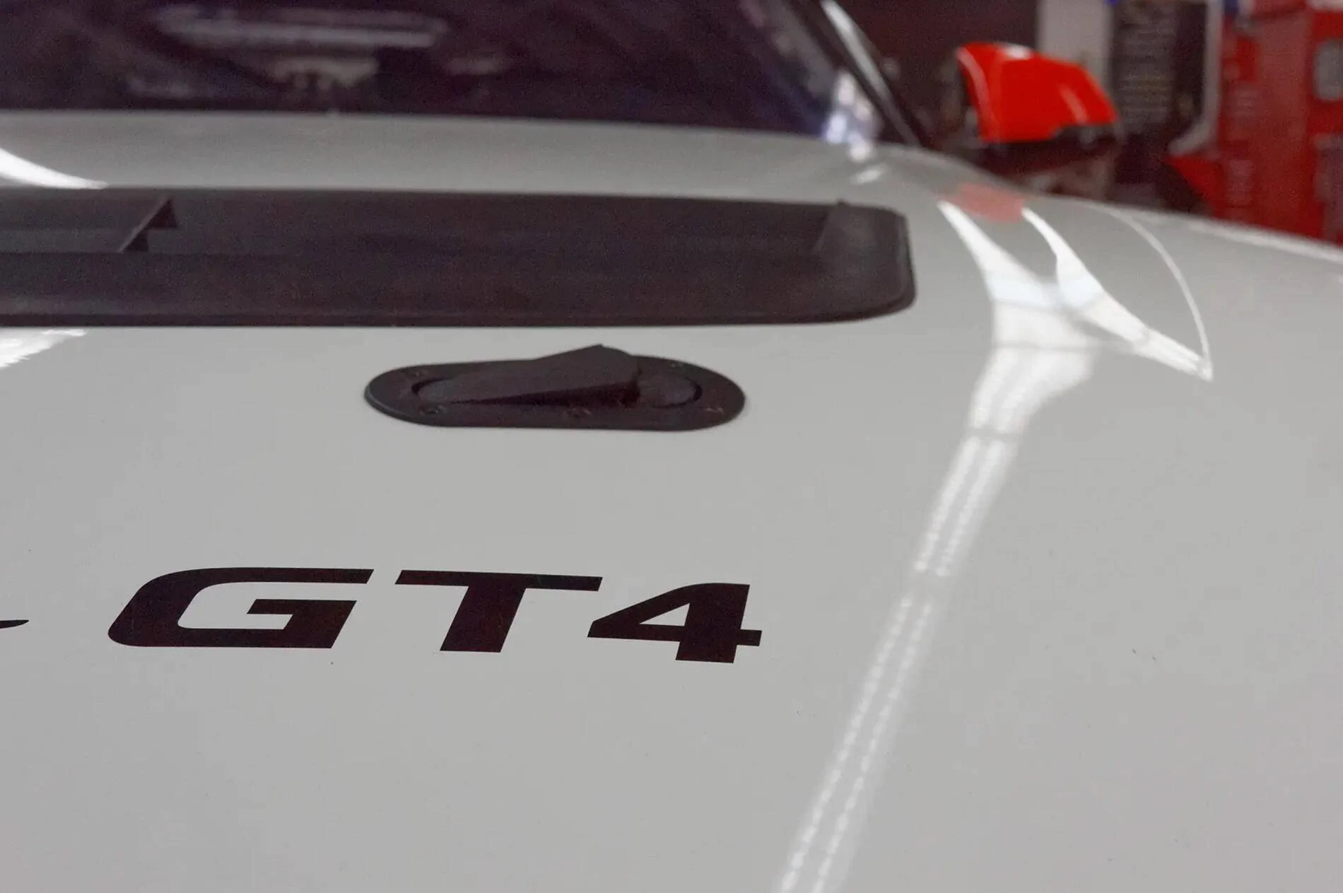

Saw a street A91 (nice track prepped one) with Aerocatch latches on the hood. Not sure why… is it cosmetic?, was the hood a custom one?, or is someone suggesting a track car should have them for a security reason I don’t know?
Probably trying to be like a GT4. FYI, these mount where the "Strut bars" mount.
yep. That’s exactly what it looked like but in Yellow. I think the idea was more for the looks than anything else. Which is totally ok.
