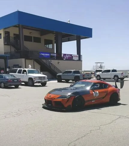

NASA event at Buttonwillow a few weeks ago. No on-screen data. It was my brothers first track day in his Integra Type-S and I tagged along to do a shakedown with some suspension changes I've done.
second half of the video, the group leader/instructor for the intro group played cat and mouse in the silver M3
