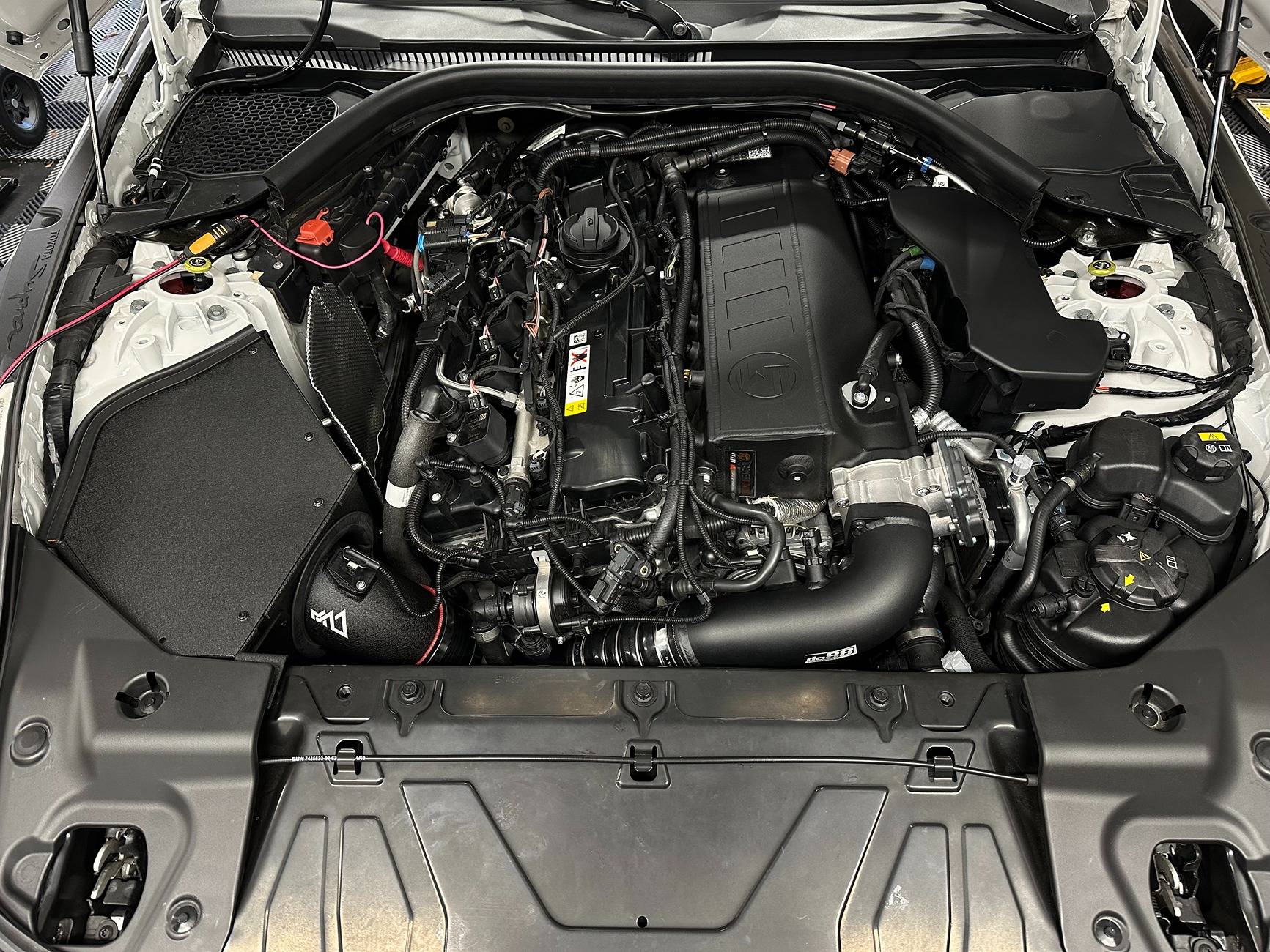

Doing some reading about intake panel filters along with general intake stuff, it appears like a stock tune car with a panel filter is fine, but there might be other options (full intakes) for slightly more power that don’t affect IAT. mostly it was me being annoyed there only seems to be oiled options for the panel filter as I’m a big fan of the AEM dry flow stuff.
I read about the MAD intake/inlet and was curious if it had similar IAT as the stock box. The S2 rules allow intakes up to the turbo inlet and if it’s good for a few more hp without hurting IAT then I’d be interested. If it has the same heat soak issues as the other intakes then I might just stick with a panel filter.
for the panel filter, I’m guessing they’re all about the same and it’s just pick your favorite brand and don’t over oil it?
I chuckled as my intake muffler cap design for the stock box is just about done now too.

Stock tune, don't even bother unless you want the turboski sound.
The BMC panel filter worked well when I had the stock airbox still.

Don’t care a ton about sound. Was mostly looking to optimize inside the rule set and figured instead of $60 on a panel filter I didn't mind putting it toward a full intake instead assuming there was one that didn’t cause IAT issues. Building some heat shield and dropping weight was the main idea behind the intake muffler idea. I usually try to do simple things that make life easier for future me along with cleaning up the engine bay for better airflow and weight loss.

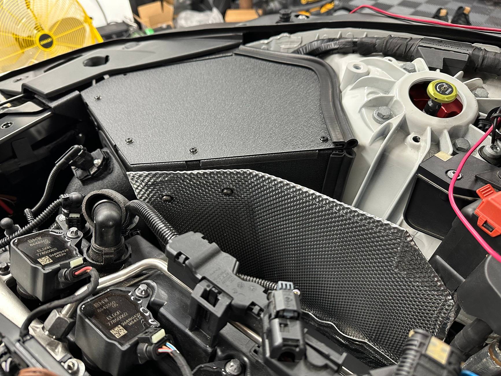

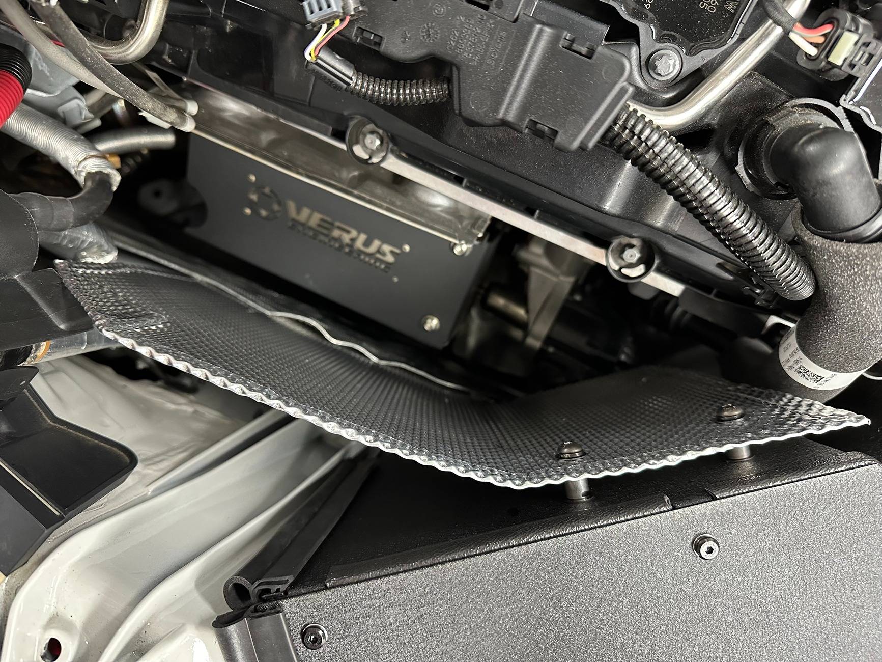

Again, you won't see anything worthwhile on the power front but will on sound.
I use the MAD intake and fabbed up a heatshield since I track the car a lot.
