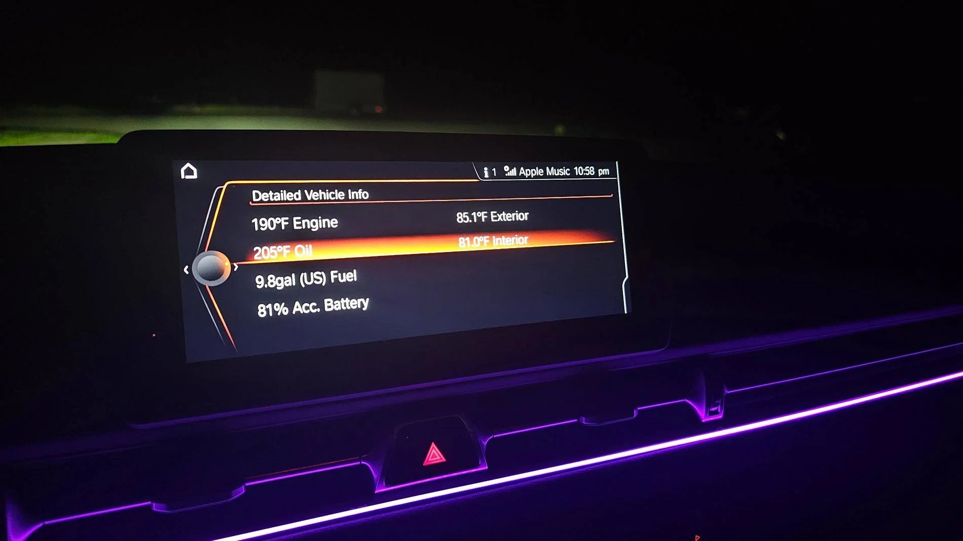

The plan is to prep to S2 for SCCA TT which (for me) amounts to springs, wheels, tires, and alignment. Intakes, ECU tunes (sadly no piggy backs), sway bars, oil coolers, general coolers, and exhaust are allowed as well, but I'd like to just get it on track with my first round to see how it fairs against the other cars I've driven. Without the ability to change the manifold in S2 I don't see a reason to spend the coin on much else power wise. Exhaust is mostly for weight savings and sound, and the intake designs all seem to ingest more hot air (although it would be nice to get a different intake panel maybe). My winter projects will be determined by whatever oil temp I see (after I figure out how to log it) on track, but I imagine I'll do a cooler sooner or later given I live in the SE and don't have a lot of mechanical sympathy on track ?
The dashboard can display oil and coolant temp in C if you long hold the trip odometer button until the menu comes up, then go to unlock. The code is the sum of the last 6 digits of your VIN #. Then go to Temperature in the menu.
Shit, that's exactly what I was looking for. Thanks!
I had bought one of the OBDII modules for bimmercode thinking I'd need to monitor it through there, but main coolant and oil is plenty for me. Easy enough to glance down on one of the straights and do a quick sanity check.
Does it stay unlocked or do you have to do it each time the car is power cycled?
You have to do it each time the car is power cycled which is kind of annoying, but I just do it as part of my "in grid" routine when turning on garmin/data, etc.
You can pull it over OBD2 as well via something like an MXLink+, or your tuning software (MHD, Bootmod, etc), but this is free and OEM.

If you record sessions with something like TrackAddict or Harrys, pair the phone with an OBD reader via BT, you'll see a bunch of counters show up in the software that you can add to your session data file. I know for sure IAT is in that list, and I'm assuming some of the other temp counters are available as well.
You can also display it on the car screen and your phone if you setup AAIDrive. Don't have to fiddle through menus, just open the app. I saved the car screen to one of my programmable buttons.
