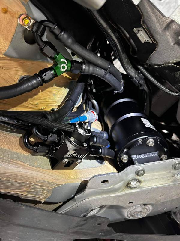

Is this a known issue? Any solutions that do not involve surgery on the fuel tank?
Known issue and nothing you can do to avoid it besides fill up every session or spend a ton of money on a surge tank and the hassle of the install. Gas jug with a battery operated pump at least made refilling the tank after each session a lot more manageable.
