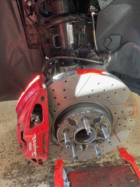

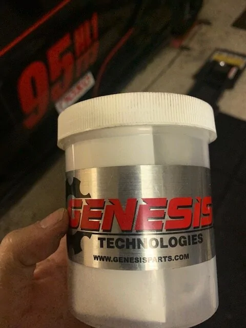

I posted this on another thread, but if you really want to know what is going on with your brake temp based on your driving levels and track etc. look at heat painting the rotor. Here is a product that you can get. I also do not recommend drilled rotors - they will crack. I tried them in this pic. Did not last very long. Slotted only or even flat ones. Knowing our heat range helps on Pad selection.

drilled and slotted are for the car shows. (see)
