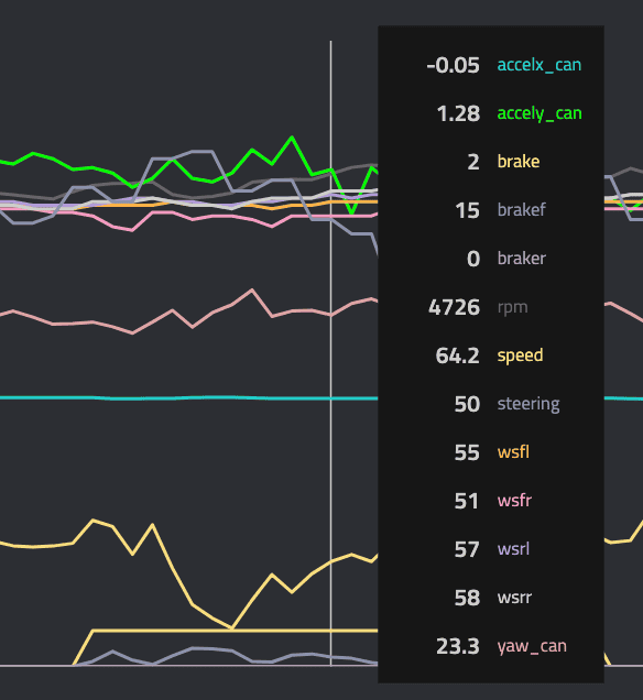

I don't find it intrusive one click off. I'm in advanced group and I have 20+ years of experience and don't drive like an ape. Now, traction control fully on is way too intrusive.
I also took a look through some of my data. In this instance, it's actually actuating the front brakes, not the rears at all.
This screenshot I am mid corner, 1.28G, I have the steering wheel at 50% lock. "brake" is the amount the brake system is requesting in %. "brakef" is line pressure for the front brakes. "braker" is line pressure for the rear brakes. You can see what I feel is the system preloading at 2% request, and 15 psi pressure to the front. For reference, when I am threshold braking, it's around 46% request, 1250psi front/980psi rear.
Note, the wheel speed differences at the rear and front right, in addition to the yaw, show you what is about to happen...

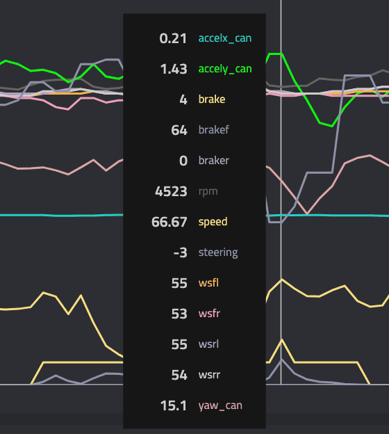

This screenshot is moments later where I am saving a slide, I counter steer as you can see in the data, and it also looks like the traction system intervenes a little bit more at 4% request, 64psi brake pressure on the front, still none to the rear.
