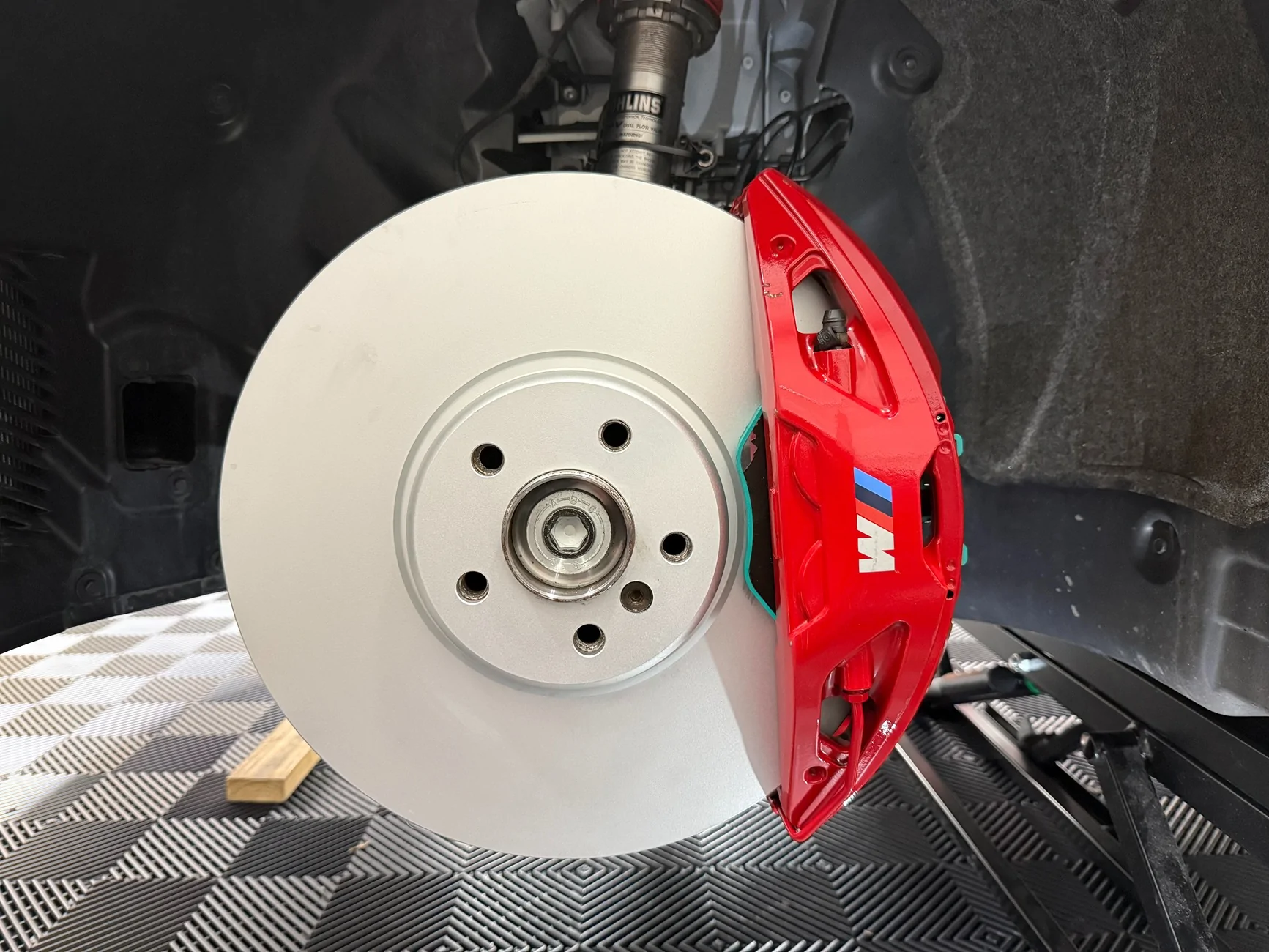

I ran them on my M240i with the larger 374mm front rotors/calipers and bed them in like a maniac like I always do. Brand new rotors. Did three track days and they shuddered all three days. Sometimes so bad that the whole car was shaking. That said, they did slow that 4,000lb boat down lap after lap.
Yeah mine was shaking pretty bad too, I bed them in quite thoroughly as well. Did it ever go away for you? I'm not optimistic it'll get better. Everything else is good though for the value
