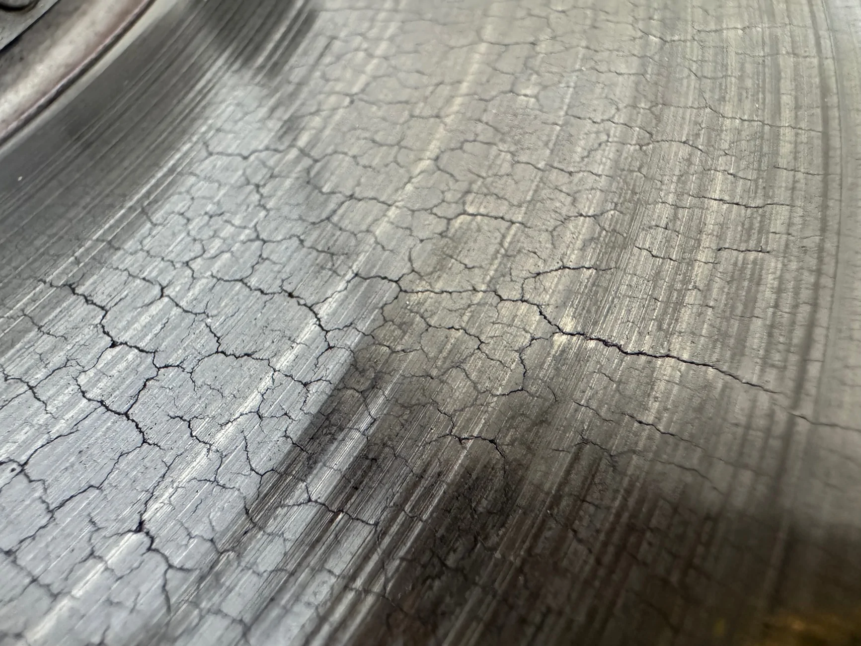

Also did an oil change, added magnetic drain plug, put 2 piece rotors on, changed pads, nut and bolt check, fresh brake fluid….. Just about ready for Laguna seca in 2 weeks.

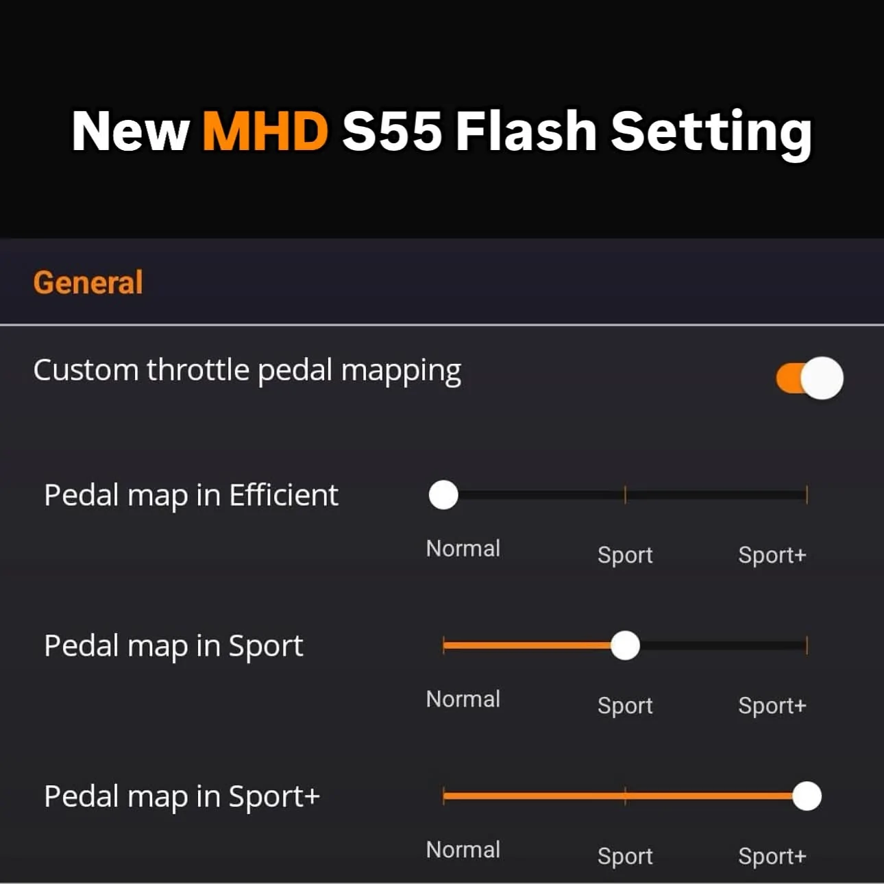

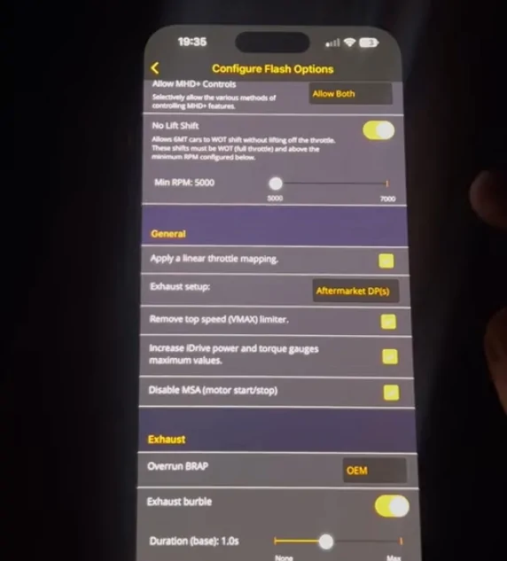

The drivability of OTS tunes leaves a lot to be desired. It’s still perfectly serviceable but I was slipping on low pedal positions. Custom will give safer and smoother power in general with a good tuner. If you’re adding an hpfp and injectors then that’s territory where you definitely would want a tuner.
Don't the new MHD tunes have an option for linear throttle? Looking at doing this and then digging into Razors self tuning guides to clean it up if needed.
The OTS tune is locked down so you can't take an OTS tune and modify it. Yes a custom tune can have the pedal torque request table adjusted. My custom tune has a pedal that drives like OEM non-sport mode and I love it. Super easy first 1/3 of the pedal. I find that I can modulate the pedal better once I'm already in it. I don't want it requesting max torque in the first bit of throttle position.

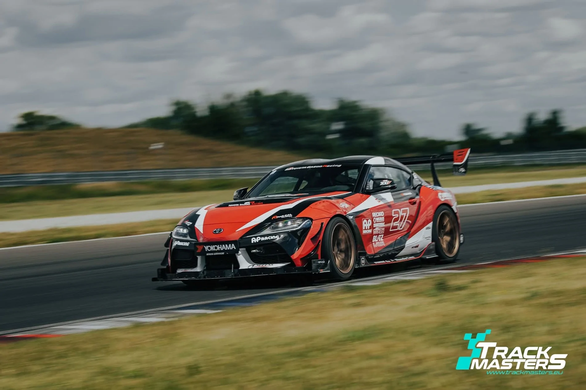

Livery update (still all my own design), official Yokohama Poland car now, running A052 :)
