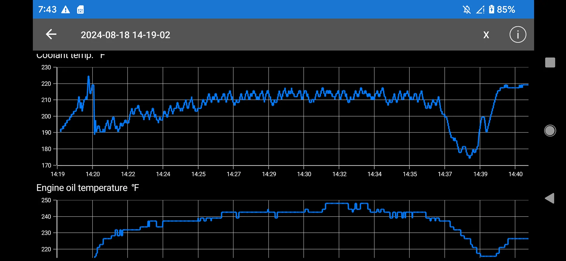

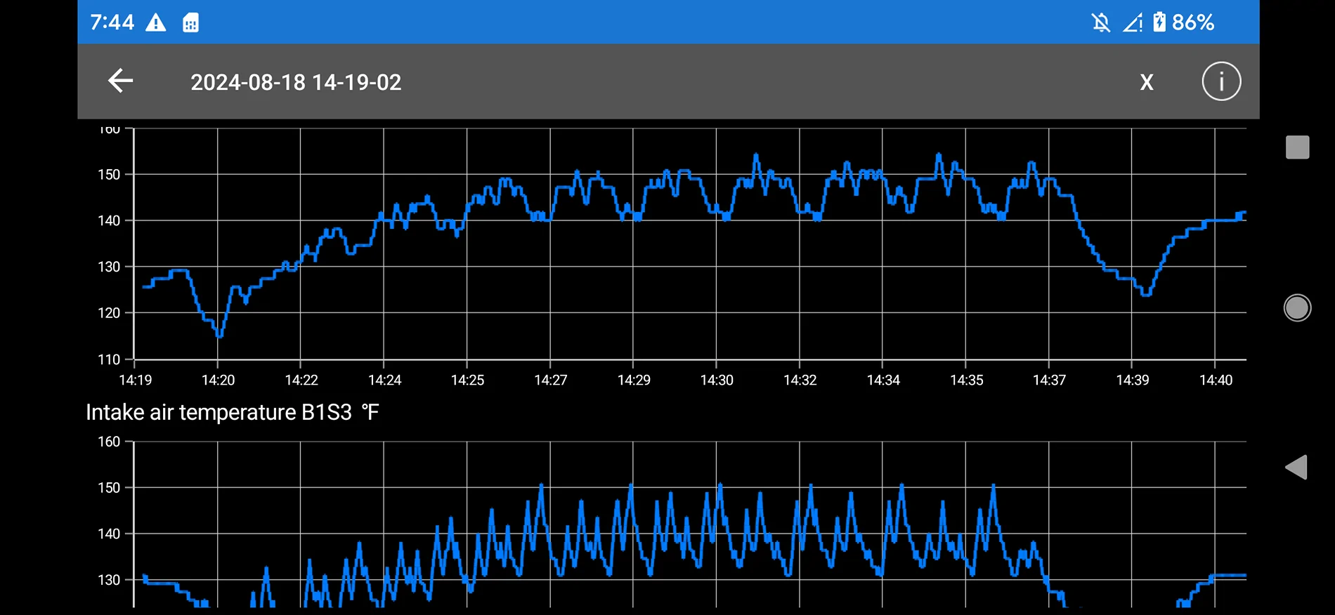

On a good tire (200ish TW or better) and stock power, fuel starve is very real at 1/2 tank or less. For instance a long right sweeper like between T13 to T14 at CMP, I've hit fuel starve/limp mode multiple times, ruining potential PBs.. The only other real weak point with stock hardware is low camber and soft front LCA. Temp management is perfectly fine at stock power. It slows down a bit in the heat, like everything, but coolant and oil temps are perfectly acceptable even in 90°+ for a full session. IATs aren't great but workable in those conditions.
~20 min session at CMP in the stank summer heat/humidity:

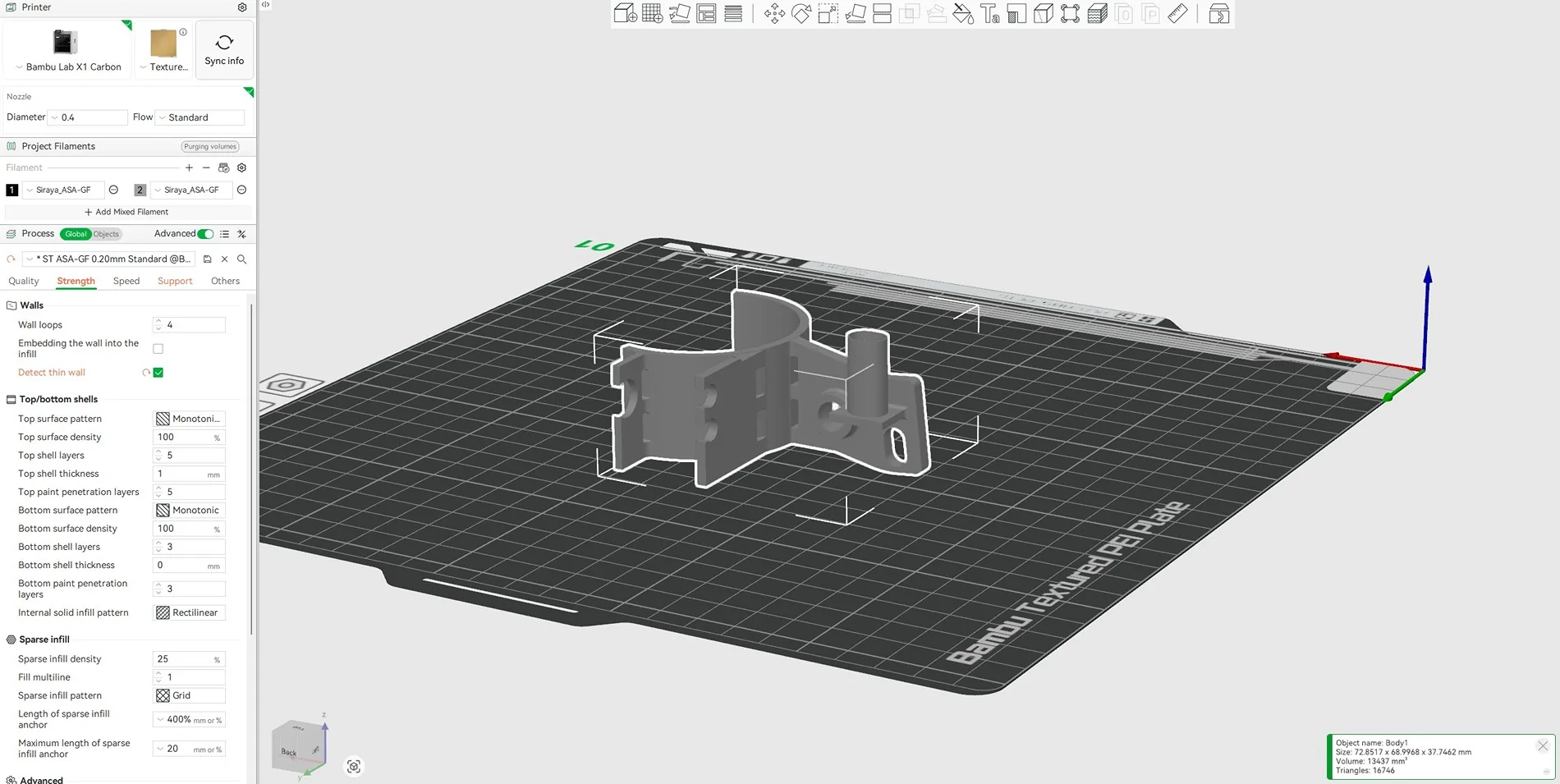

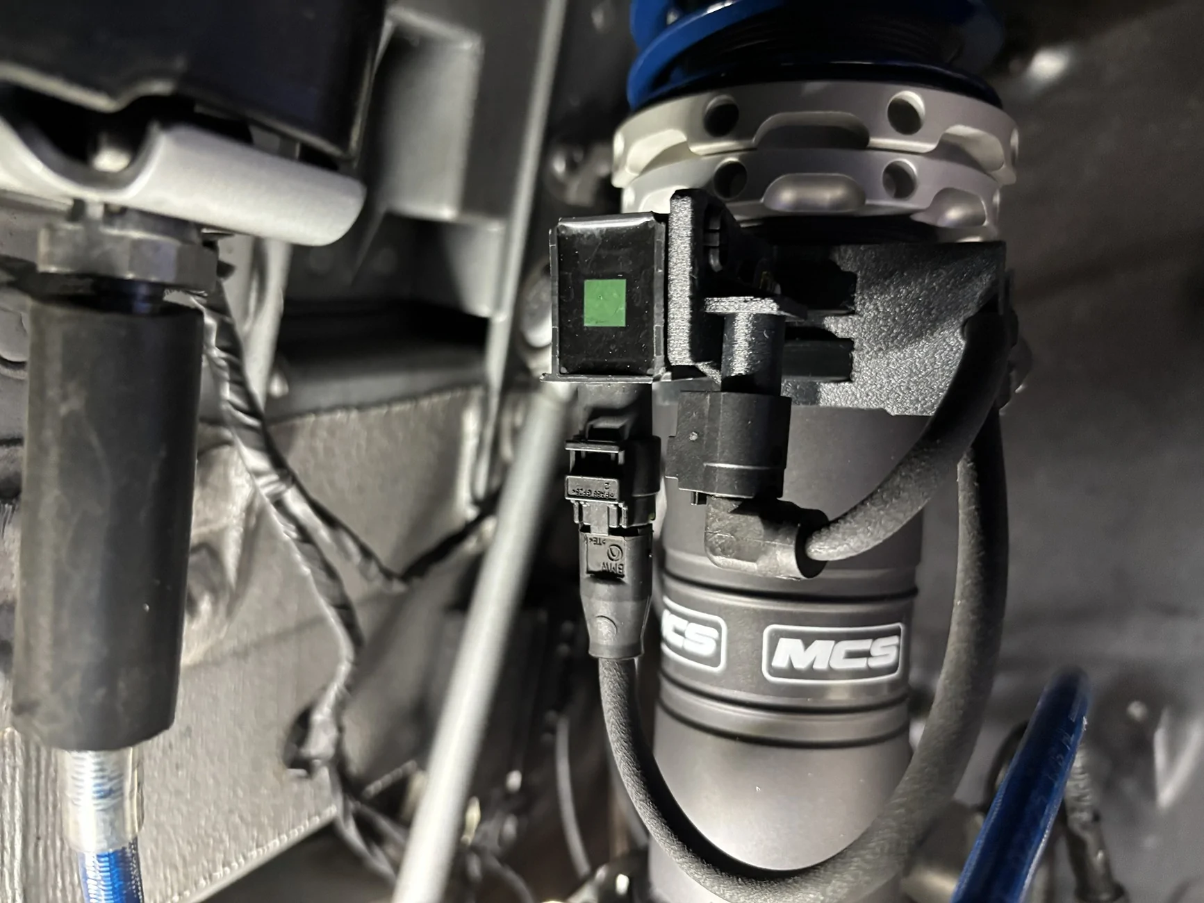

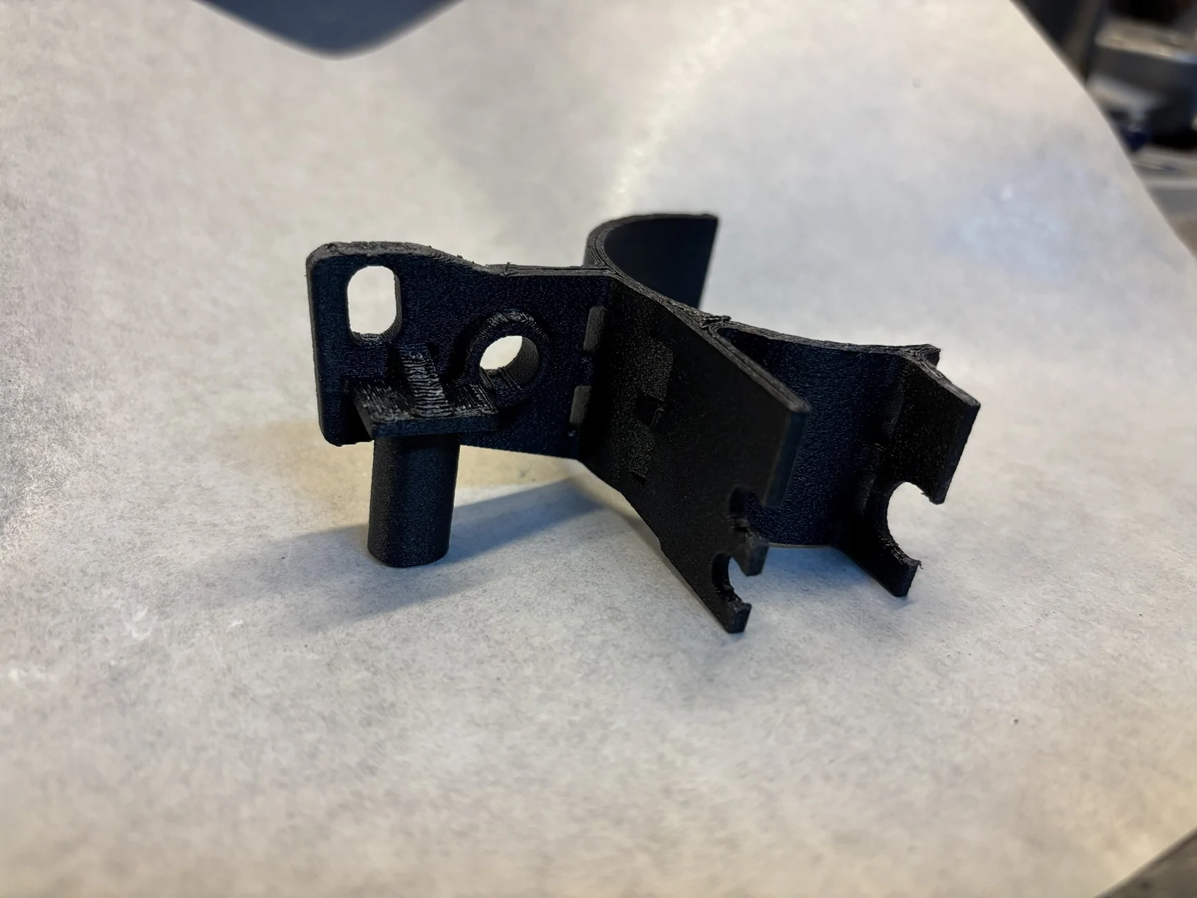

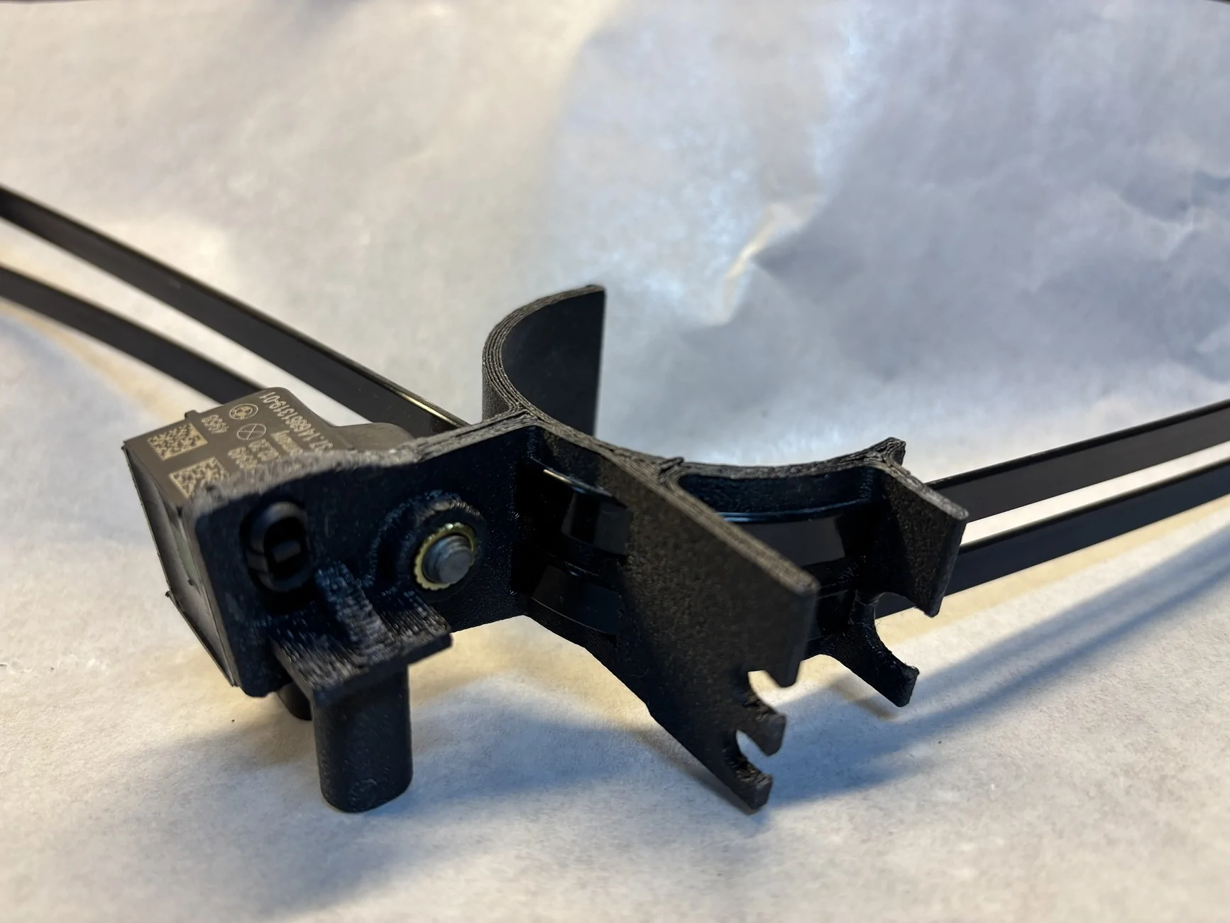

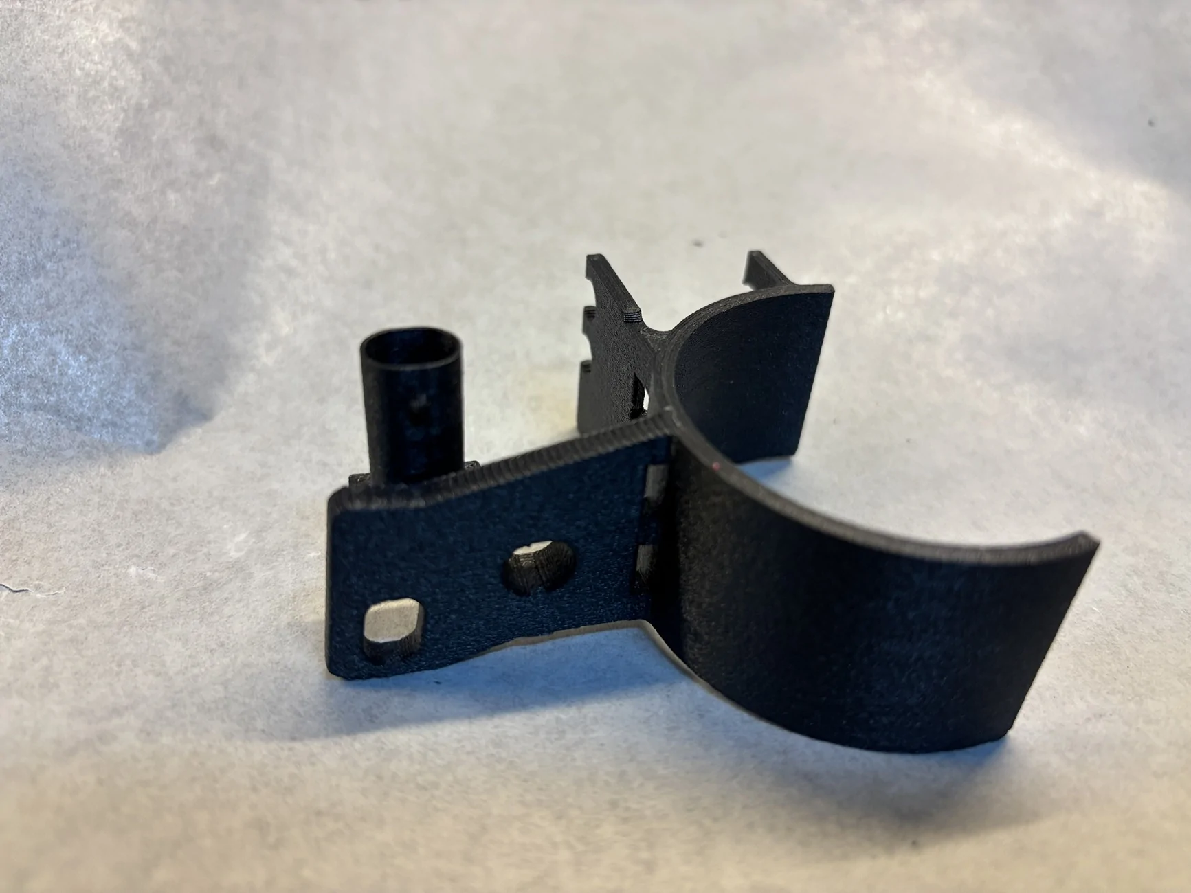

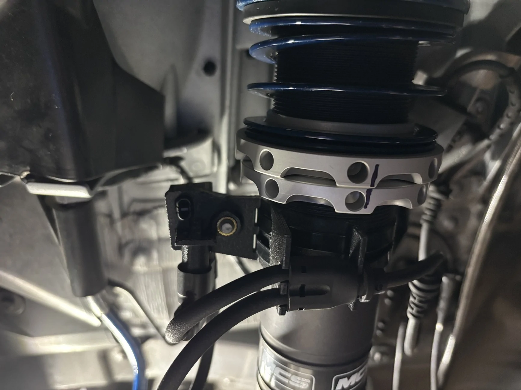

Hope it's OK to post this here since most here are doing coilovers and hopefully this will help others.
While installing my coilovers, I wasn’t thrilled with having a pile of zip ties holding sensors and connectors together, so I designed a bracket to clean everything up. It retains the factory acceleration sensor in the OEM location using a heat-set insert(or you could just use a nut), includes a dummy plug for the OEM shock controller (once coded out), and adds standoffs to secure the Y-splitter wiring.
It still uses a couple zip ties through the integrated wire mounts to keep everything secure, but the overall setup is much cleaner and more organized.
Printed in ASA-GF for added heat resistance and strength. If you print in CF or GF materials, you’ll probably want to add some protection where the bracket contacts the shock body to prevent rubbing.
https://makerworld.com/en/models/2763172-a90-supra-coilover-bracket
