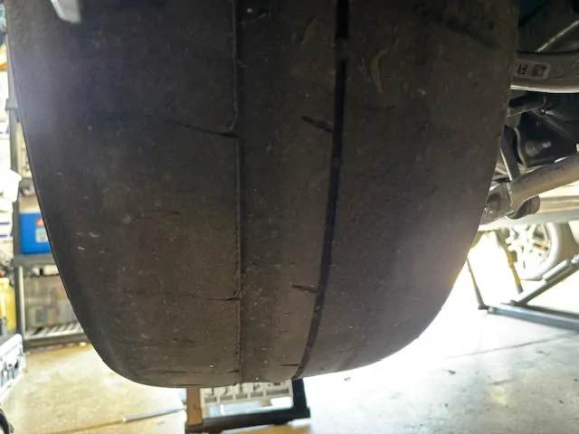

Am I gleaming the cube running these for another track day? Front RE71RS's.
Need more pixels but it looks like you've been touching the wear bars for a bit and the middle-left before you get to the outside shoulder is now flat and barely shows the ridges that used to be there. You're probably close to cording the outside. Not sure I'd bank on going another 4x 20-30min sessions.

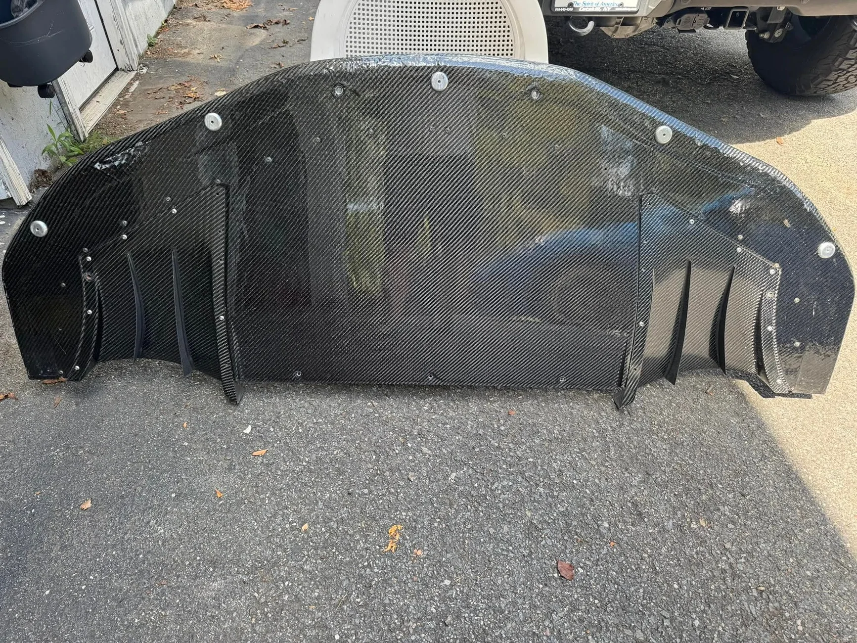

Good to know that there are good alternatives to Verus. Is not a matter of if, but when mine will be ripped out or something.
Zebulon, AJH, Verus V3 like Kyle has are 3 top choices. Also SydneyComposites from AUS.
V1/V2 verus splitters are meh/medicore at best, biggest benefit is strenght, not so easy to break. Heavy, 2 piece, flat, no real airfoil shape, mounting points r also not optimal, tunnels could be better.
For example AJ tunnels r engineered by KyleEngineers (f1 merc aerodynamist) and r max size possible for Supra without bigger cuts.
If i didnt want adjustability i'd do Zebulon probably but the fact they dont post any data puts me off a bit.
I'm re-doing all aero, when all on I'll post it here :)
