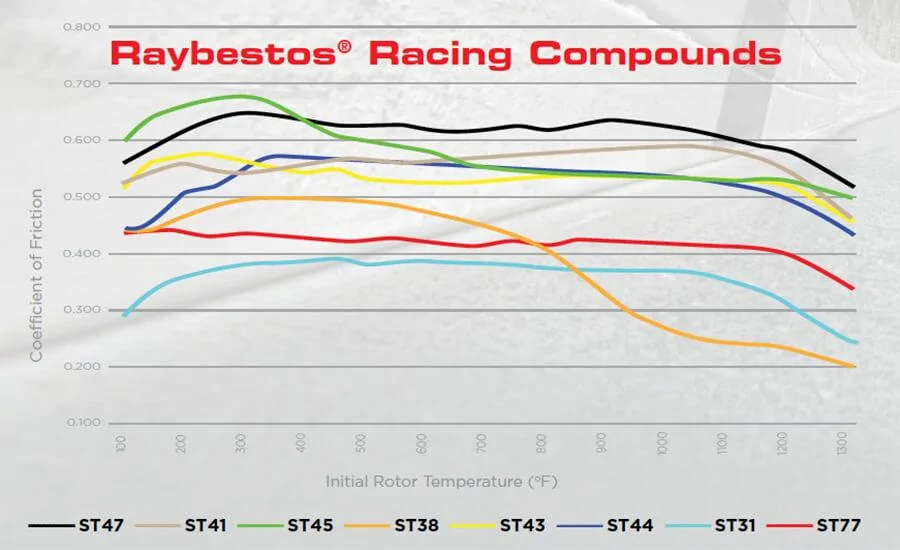

no matter what combinations of compounds you use they run in the 1000 to 1200F range on track.
Anyone serious about track use should be looking at pads with .40-.65 coefficient of friction and at least 1300F max ability.
The temp capacity are table stakes.
You'll notice that the beloved (but way too expensive) CSG C21 pads tick all those boxes. .42-.48 friction and 1760F max.
The Project Mu Club racers that I use are .42-.55 friction and 1500F max. So they also tick those boxes.
Think of the coefficient of friction number as your tuning guide. Some people like way more initial bite, some people like a bite that ramps up and releases quickly, or slowly. It all depends on your style and car setup.
Here is a good example. On my last car, I had used both the ST43 and the ST47 compounds shown above. If you notice, they both have the same horizontal plotting, it's just that the ST47 has a higher coefficient of friction. To me, the ST47 had way too much initial bite for my setup and driving style so I would lock up the brakes much easier at first until I got used to them. They also didn't release and modulate as smoothly because of the higher friction rating.
The St43's worked great for decent street track tires. The ST47's worked great with real R-Compounds because I could exploit the higher friction level more.

Good stuff - and for those that have not looked up all the heat ranges - most street/track pads go up to about 850F max or even less. Hence why you run out of brake pad. They still are better than stock but have limitations. So have to get something that works for you. Hopefully this helps the group as the could be a whole workshop on this one.
8,651
16,960
The ST38 in the chart above is a great example of that. .50-.45 friction until 800F then drops off a cliff to .20 friction.

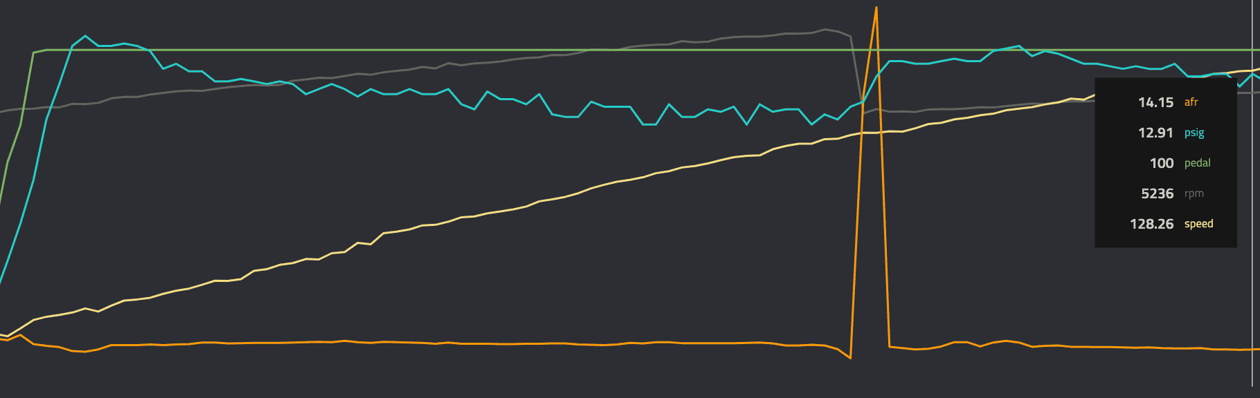

RE: Fuel Starvation -- knock on wood I never experienced that on a 200TW. I try to keep at least 1/2 a tank but I accidentally ran one down to 8 miles est. without issue, and have been at a 1/3 or less multiple times.

This talk about fuel starve/limp mode...thank you for the reminder. I'll start the day with as close to full tank as I can, so that should get me through 8 laps without having to think about it too hard.
I know Danny Kao had a limp-mode issue in his Supra at CMP last year, but I think that had more to do with bad gas, vs fuel level. For those who drive at CMP regularly, you already know to avoid the station right outside the gate if at all possible. After clearing the code and a fill up with top-tier fuel, it didn't happen again for the rest of the week.
It's on right turns when it happens. With 100% stock power this last season, I never had fuel starvation ONCE at Lime Rock, which is 99% right turns. It might have something to do with the 2020 oem tuning, which runs 14.5-14.0 AFR at WOT all the time, so the fuel demands are much lower. The 21+ richens up past 5500 rpm.
This is NOT me saying the problem doesn't exist. Like a lot of things, it's probably track, setup, and tune dependent.
I lost an engine on my last car (Evo 10) from fuel starvation, but ironically it's issue was on left turns. I was also running full E85 that has much more fuel flow demands. I ended up over building the hell out of the fuel system and never had an issue after that.
I expect it only a matter of time with my Supra as this season I will have much more power.
