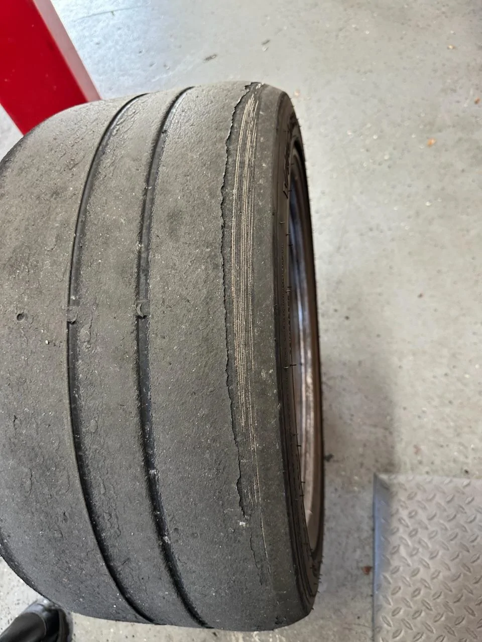

And speaking of starvation. I did finally get tread starvation ?
These poor tires did track days with a stock alignment and many many other setups. Even at the very end, they griped like a beast! Other tires I’ve used at 50% or more begin to slide easier on the edge. These suckers hang in there like a champ! Less counter steering on the high speed turns all the way to the very end… Putting on some new Maxxis rubber today and dial her back down to a -2.5 camber in the front, with a slight toe out ?

How much camber are you running and tire pressure. I have been able to get mine to wear pretty even so gave not been cording the outsides.
Yeah it’s really been a mix bag of try everything. Tire pressures all over the place. At lower temps (say in the 50s) I was starting between 28-30 psi. As the day heats up, went down as low as 24 psi. I did have a few sessions I forgot to pressure down and came back in after sliding around, only to find out my pressure was up to ~44 psi ??‍♂. Those poor tires have been through hell & back, and way too many setups. With and without springs, sway bars, stock alignment, -3 camber square, & just playing with lots of stuff. I used to do this with a race team in my other cars and really took them for granted (apparently ?) . That being said, I’m going to settle with -2.5 all around, pinch toe out up front and toe in rear. Found two race alignment shop in my town, great mechanic and started talking to some old racing buddies again. Appreciate everyones advice on here and especially you throwing this thread up! Looks like you’re having a crap ton of fun out there ?

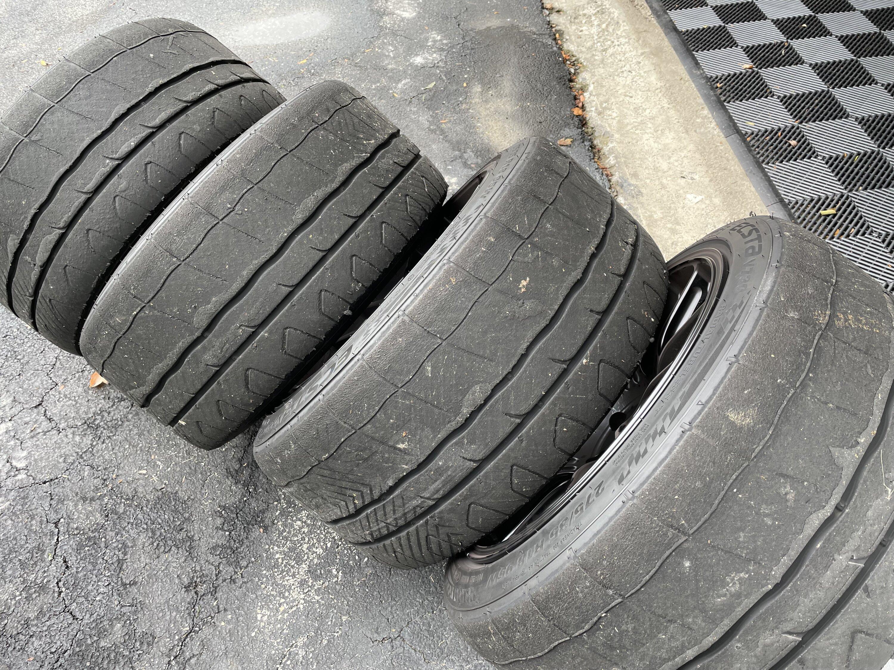

So I used 12 sets of tires in two years. Have tested the following - 275/35/18 square set up on APEX 10x18 rims. Federal 595 rsrss, Federal 201M, Nitto NT1, Hankook Z214, Maxxis rc1 and now rc2, Nankang AR1, Continental extreme contact sport, Hankook rs4, Kumho escta v730. Aligment set up that seems to work best -2.8 front camber - 0 tow, -2.6 rear, 1/32 tow in. Tire temps hot with a heat gun( I have pyrometer but to lazy to try and do this in the hot pits) are in the 180 to 200 degree range and fairly close all the way across and they wear down fairly straight until corded as I defiantly try to get all the use out of them. We are hotter in AZ so air temp is in the 80 to 100 degree range all most of the time. Even with all these different tires the starting cold temp that works best is 26/27 psi. Then on first run the usually come off at 35 to 36. I drop hot to 32. Check second session and may have to drop 1 pound to stay at 32 hot. Then are set for rest of weekend. I tried dropping Maxxis to 30 hot and rolled/ corded the left front before they were completely done so I think they are a little more sensitive and like a little higher pressure. So we could have a whole chain on tires if anyone else wants to jump in.

tires every 2 months for 2.5 seasons. lost track haven't tried as many different ones.
SC3r are magic
SC3 are really decent and wear well
AO52 are still king if you are going for a timed lap but fall off after 5 hard laps
OEM- meh
Nankang CRS my favorite so far for traction and not falling off
cold and hot pressure are about exactly the same for hot Humid VA. Cooler months not as much in between sessions. In July/Aug seems like they want to balloon after 3 laps- can't let enough air out some days

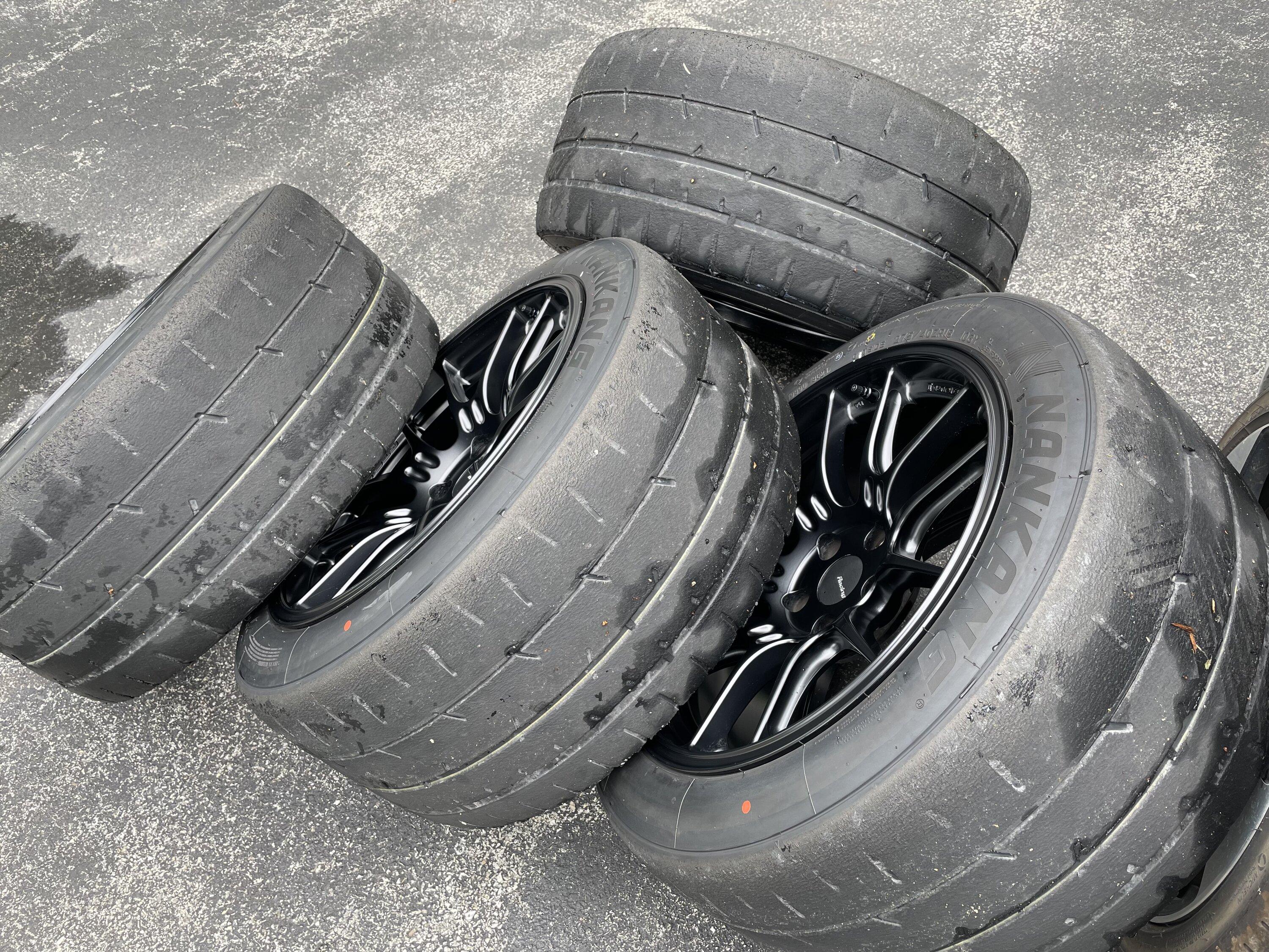

Nankang CR-S my current favorite 200tw track day tire. They are almost A052 pace but without turning into pudding 2 laps in like the A052's do.
V730 great for the price but off pace from CR-S. Probably the best "normal" track day tire for the price with a good pace but if you are going for PB's, I would pick the CR-S.

CR-S
V730
