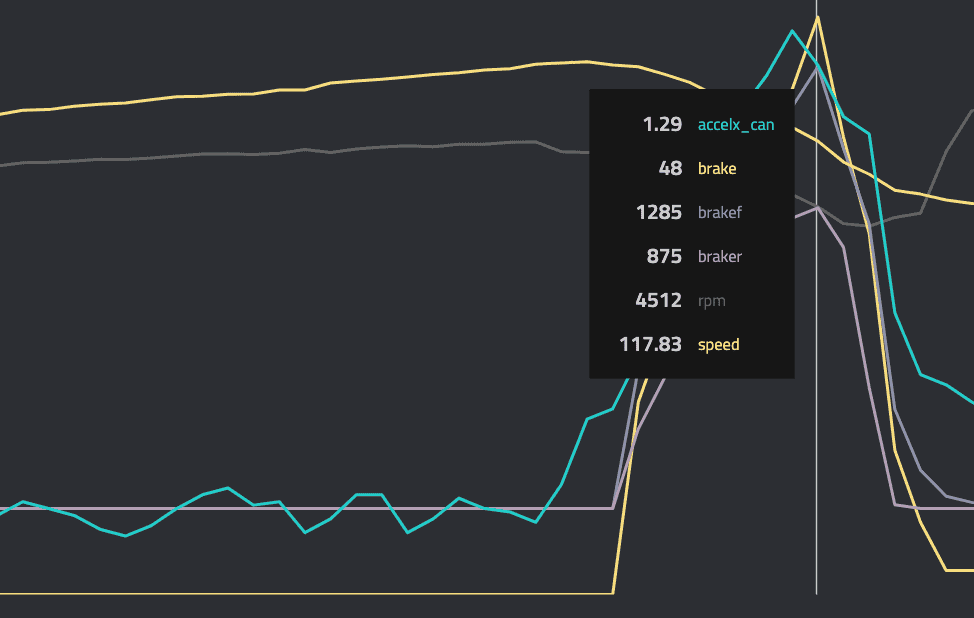

The break bias on these cars/ wight balance is almost 50/50. Bias cannot be adjusted unless you were to get rid of ABS and go to a full race ABS system. So it is really closer to something like 54% front and 46% rear.
I think you might be confusing brake pressure bias and weight distribution, and also static bias vs dynamic bias. The braking system uses a lot of factor in calculating pressure bias. If it was close to 50/50 all the time you would lock up the rear brakes very easily depending on circumstances.
Under normal straight hard braking, I would say the balance is much more to the front, but again, it depends on what the system is doing. Under actual braking, it's dynamic bias.
Here is an example from my Supra with the same brake compound front/rear, which changes static bias. Of course this is just showing brake pressure front/rear so not the full story but at least it gives us some glimpse into what is happening.
Here is threshold braking in a straight line from 130 mph, creating around 1.3g of deceleration. 1285psi front brake pressure, 875psi rear brake pressure.
I also have logged instances where the pressure bias moves around when the car is getting a little squirrely under braking (dynamic bias). Modern braking systems are pretty amazing.
You also have to remember our brake rotors are pretty close to being equal size front/rear.
