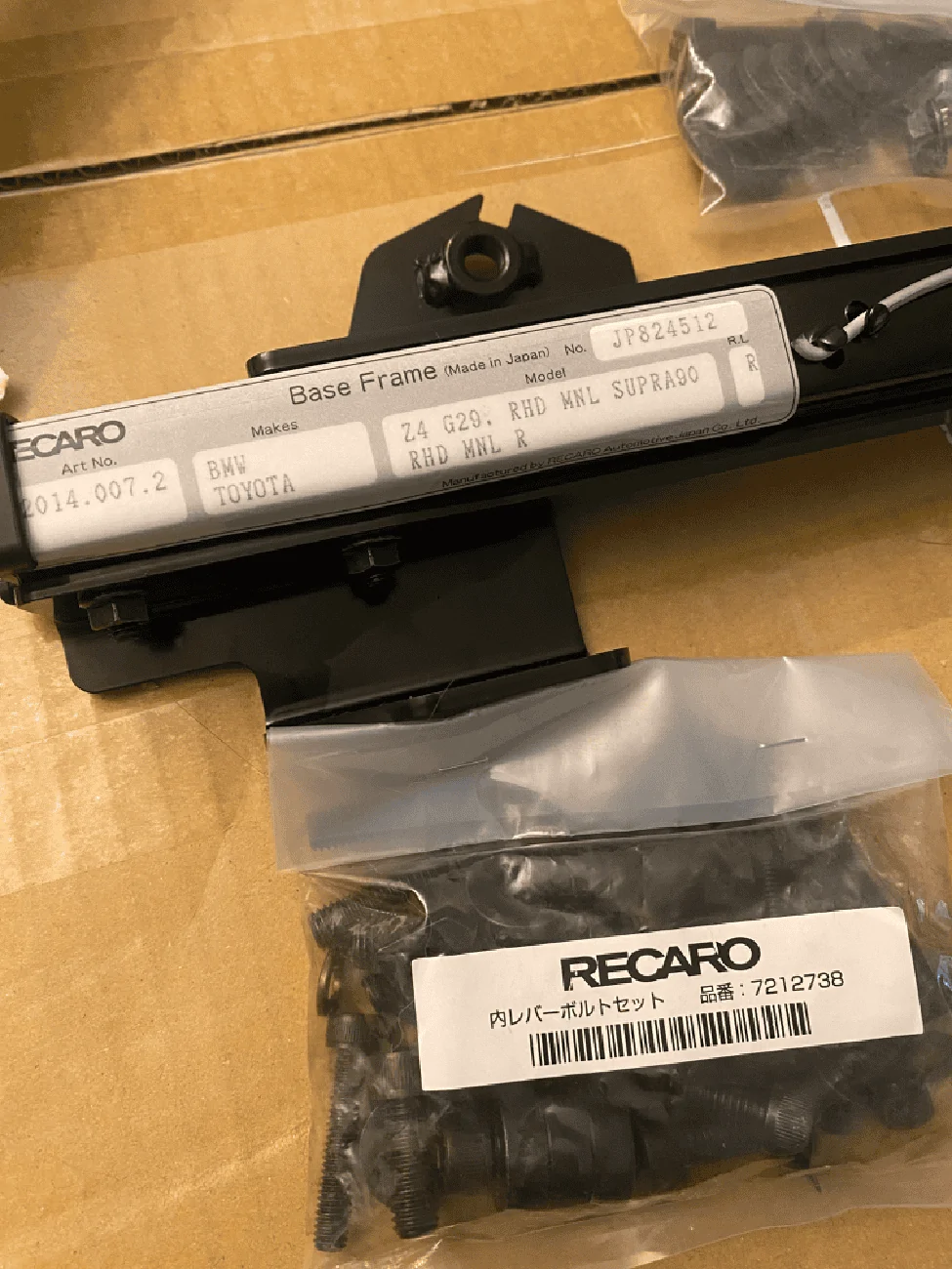

You should try the Recaro Japan “base frame” kit, it’s a slider with all the base mounts attached. The mounts also have the brackets (seat belt receptacle bracket shown in pic attached) to swap over your oem seat belt hardware. Recaro kit includes an airbag bypass(didn’t use), all the hardware you need (bolts, spacers, washers). Also no need to worry about play/slop, like you would with the sparco/universal sliders are known to have.
Install was a direct swap for me, just bolt the side mounts/seats to the Recaro unit and it dropped right in. I didn’t have to install/uninstall a bunch of times to get things setup/aligned like you would with the traditional milled base mounts.
Thank you for the recommendation. I ultimately went with PCI bracket and slider. I am mad at myself for not doing this the first time around. Live and learn I suppose.
