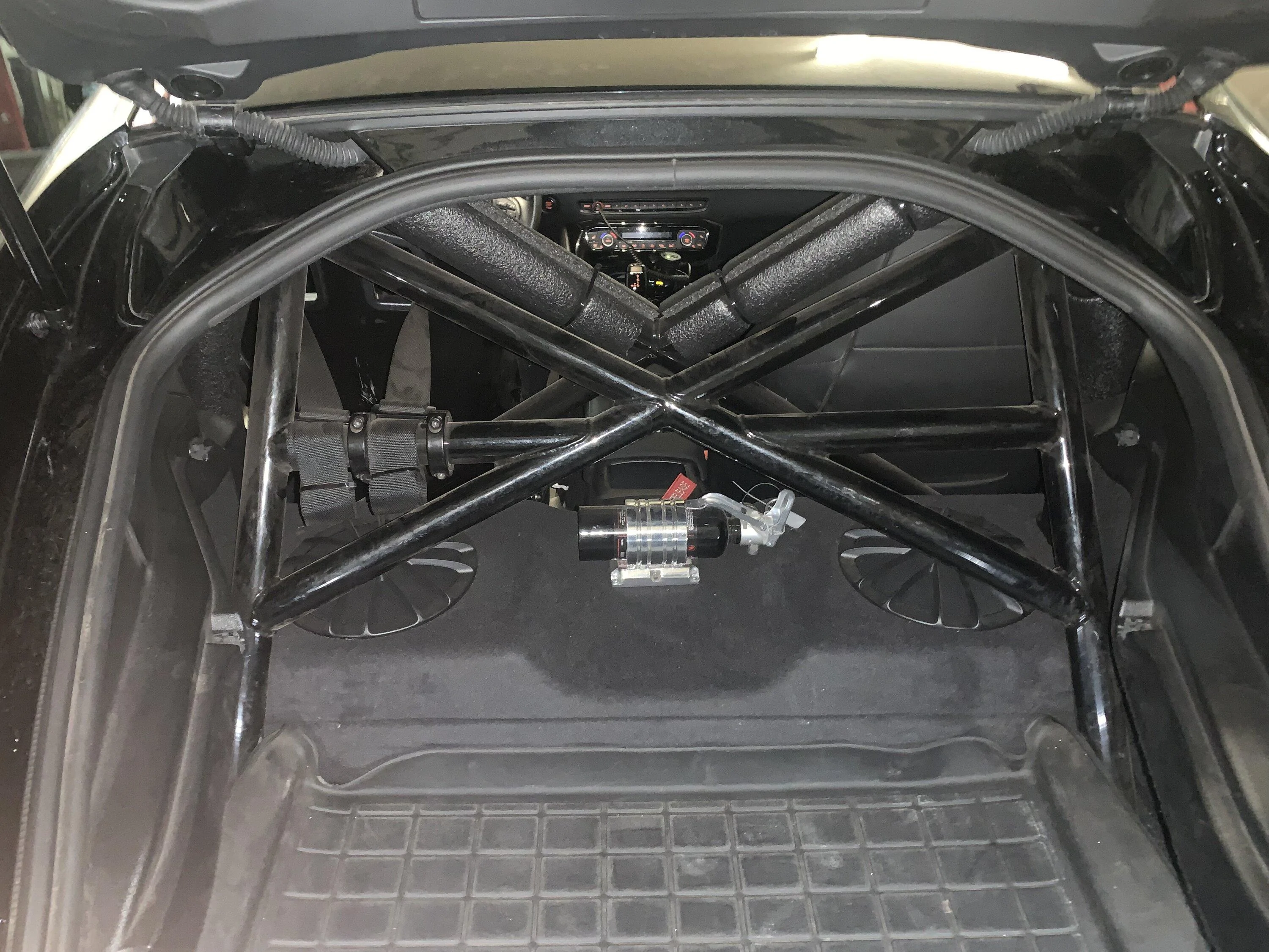

Well more to the story. I built a custom trailer hitch for my tire trailer. So that is probably 30 to 40 pounds plus studio rsr role bar. Plus all the strut braces etc so I guess adds up.

Yea that RSR rollbar is at least 70lbs.

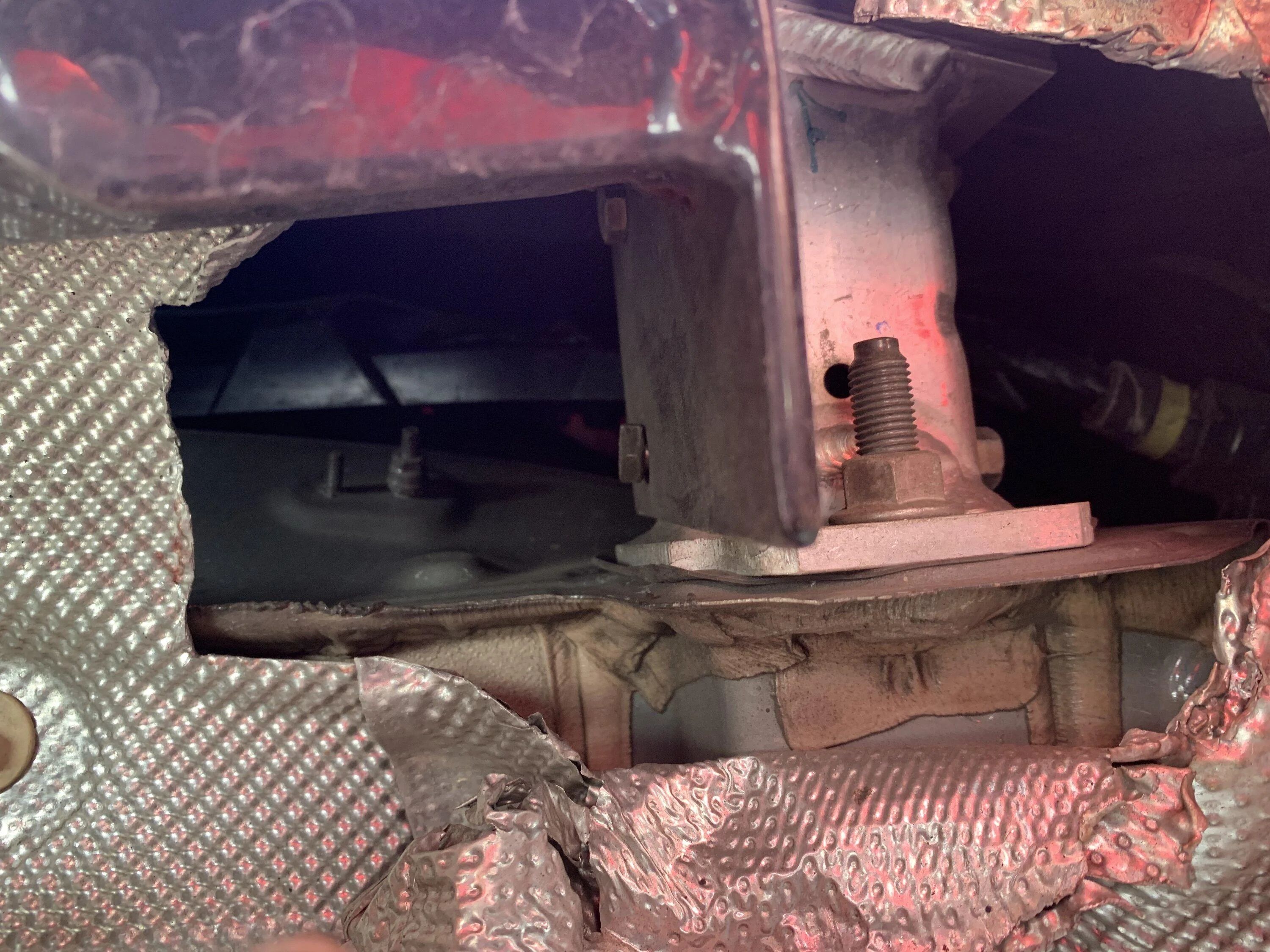

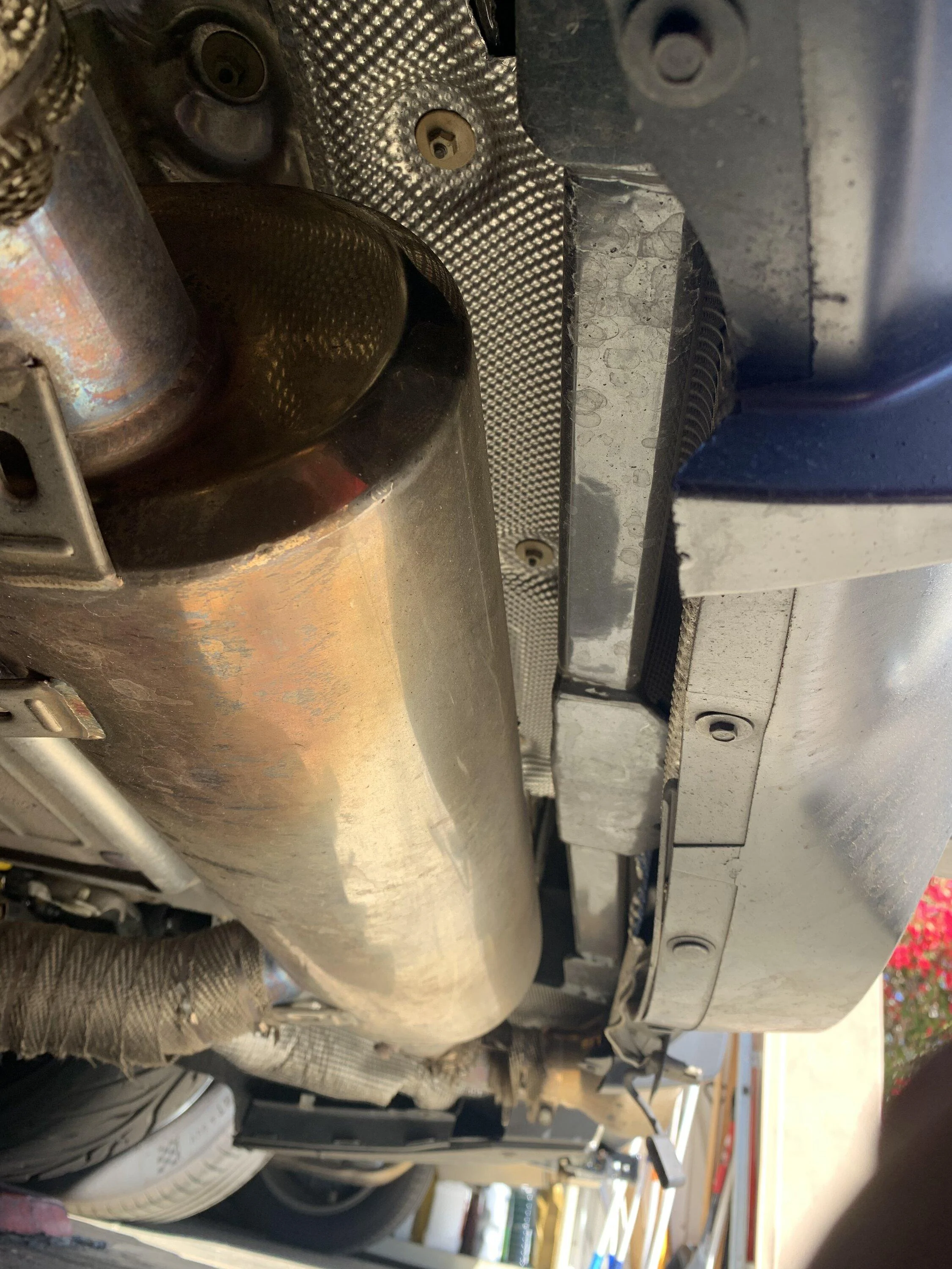

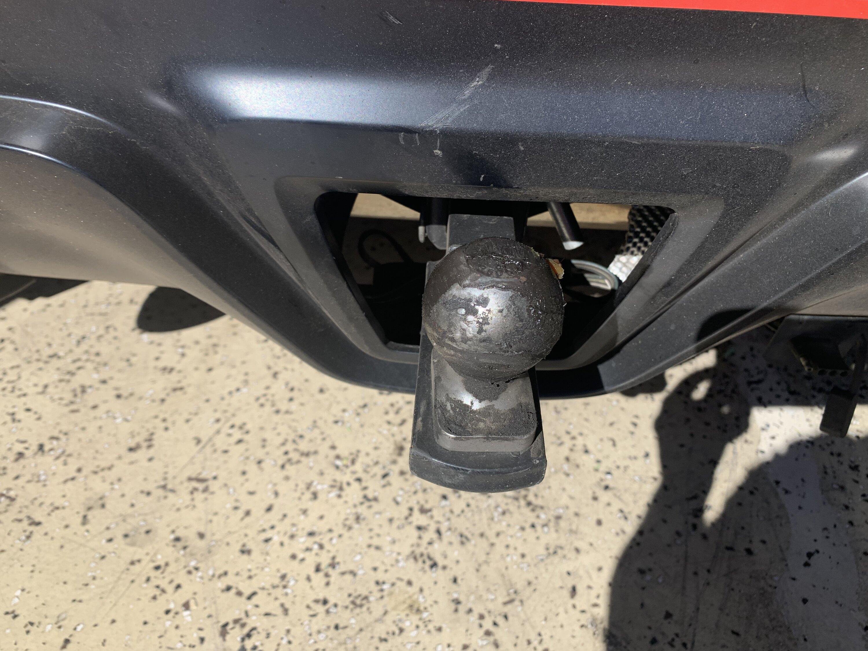

You guys are killing me, I am getting ready for track weekend so will try to describe it briefly. so if you take out the reverse light and then look up under the back there are 2 square cross members that hold the bumper that is where I bolted it too, 2 flat plates and then 2 bolts straight though those beams then I measured and welded 1 1/4" fairly heavy wall tubing from those plates over to the center where you see the receiver. I bought the receiver tube and hitch from e-trailer. Spent time over engineering so put gussets etc. Bottom plate under the receiver hole with 2 hole for tow chains. So took quite a bit of fitting, and welding. Then went and had it powder coated. Took car to U- haul to wire and they though I was crazy but they had done some corvettes so they got it wired. I will see if I can find any pics of the hitch before I put it on, as it is hard to describe. I did even take bumper or exhaust off. Cut shielding so I could get to those beams. I am sure this was a first!
