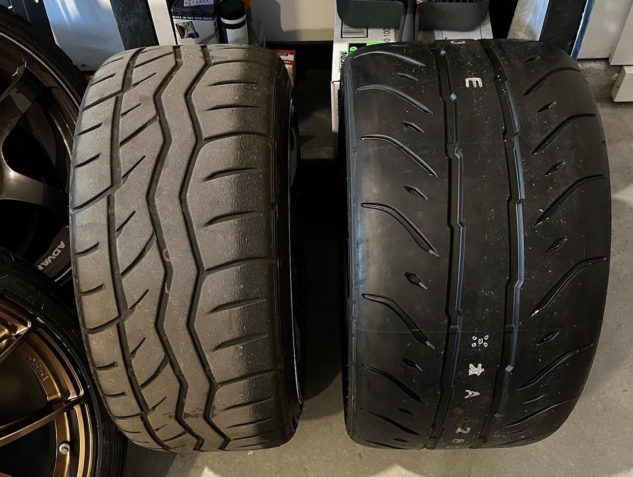

Heres some reference for the Apex 18x11+40 square on 315 RT660s. No spacers but after using them for a weekend, I recommend at least a 3mm spacer, as others have said, when using these wheels with tires bigger than 295. Heres a comparison to 265/35 rt615k+.
are you rubbing now with the 315 and wheel set up?

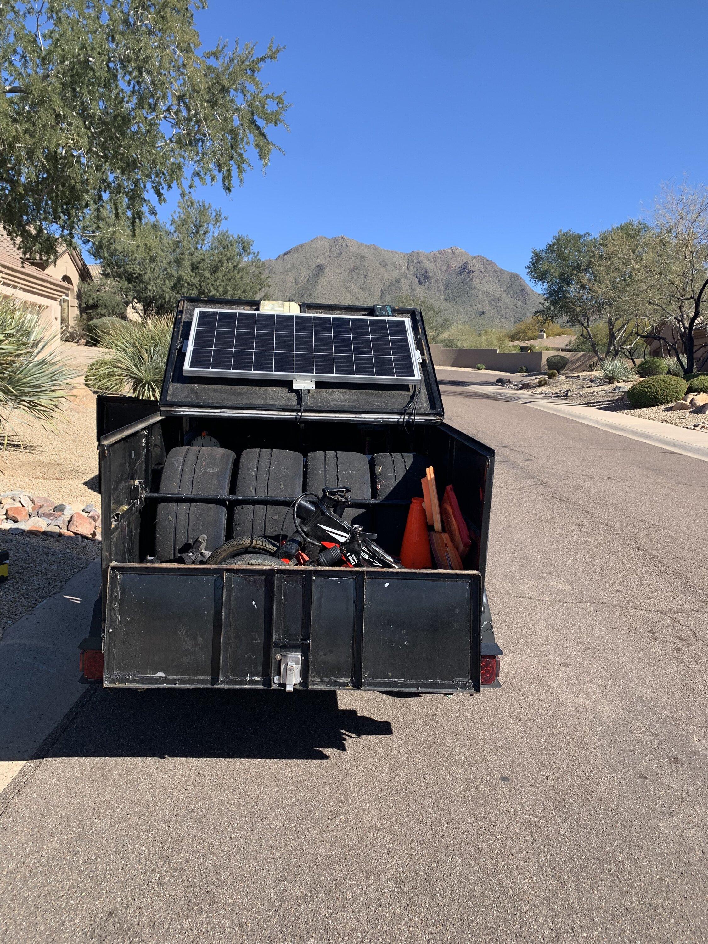

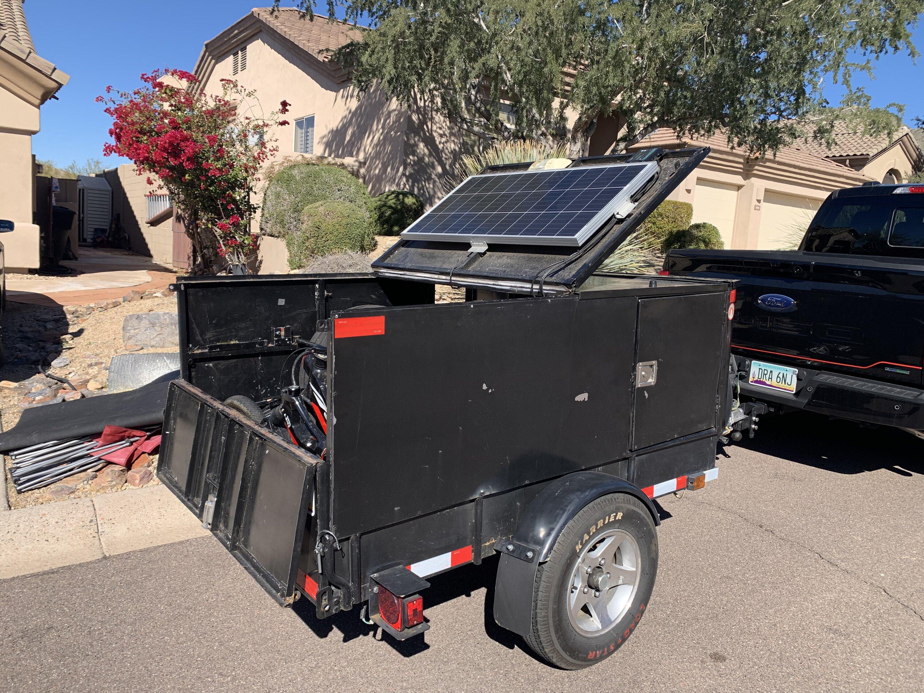

A few more pics if trailer. I over achieved. Has solar and 110 inverter. With one battery. Runs my brake fans. Coffee pot chargers etc fir the day. (lol)
and pit bike! very important item to haul - who wants to walk everywhere?
