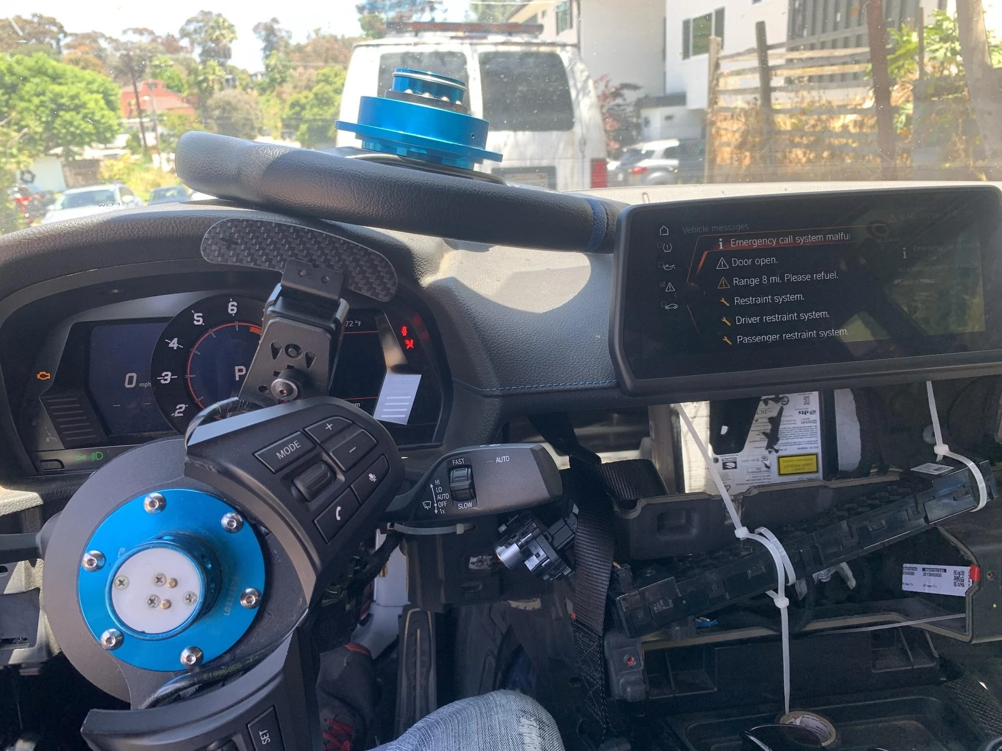

I use a NRG wheel (ST-024MB-R-BL), NRG short Hub adapter (SRK-f56h), NRG release adapter (SRK-257BL-BL), battleaero makes an adapter plate for the OEM buttons and shift paddles mount.
I went with this wheel for the extra leg room with the flat bottom
The screen with Emergency call system malfunction lol
