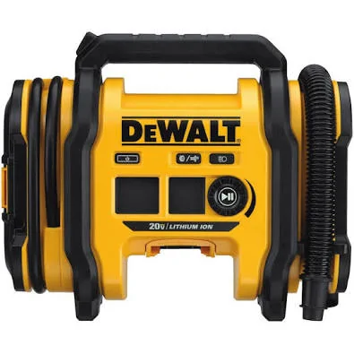

What do you all use to air up at the track?
I’m considering buying a compressor but don’t want one that sucks.
Also, any suggestions for starting tire pressure for PS4S on track?
I use this since all of my hand tools are DeWalt. This runs off the cigarette lighter or a battery. I set the PSI and it runs to that pressure and stops. It even adds as extra 0.2 psi or so to compensate for air loss when you remove it lol
Some to consider:
https://www.roadandtrack.com/gear/g44735782/best-portable-tire-inflators/
Personally… I’d start my pressure at 30-32 psi in the early colder morning. As I get faster & the day gets hotter, begin to bleed the pressure down all day long to maintain less than 36 psi hot. A lot of it is feel. Definitely go lower if you start to feel too much slide.
