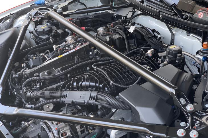

toyota only added the front strut brace to the ‘21s because auto journalists couldn’t drive the initial launch setup well without it. iirc the pro racers who track tested it were faster without the brace, hence the decision to launch without it. you get the same effect with a stiffer front sway bar, these are all just timing devices for which of the axles lose traction first. it’s why even the gt4/evo aren’t running the brace either.

I find it strange the a strut tower brace could have that much affect on handling. Certainly once you are at the GT4 lvl with huge mech and aero but short of that ? The chassis is a pretty darn stiff one. Now sway bars do have a huge impact.
Not because of journalists. Legit effort to add rigidity and fight corner pull down
Gt4 cars need access to engine during and between races. They have ever MORE rigidity due to integrated roll cages.
never heard of a race team making their chassis more flexible. Why do you think the engine and trans mounts are solid.
If they want a more compliant ride they adj suspension. Not chassis

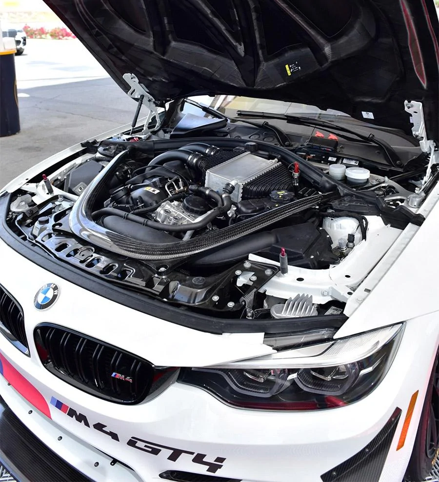

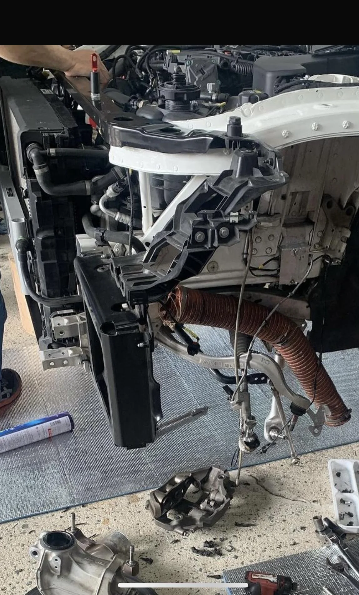

Current bmw gt4 strut braces is beautifully carved out of the way. They serve a purpose but repair speed during race weekend is important too. Watched a gt4 team friends replace a radiator couple weeks ago between races.
an off in traffic collected some gravel. The belt and fan threw a rock through the radiator 2 laps later
8,783
17,240
The top photo is the current BMW M4 GT4. They span the whole engine bay.
Technically the supra braces aren't in the way of the radiator either.

you're probably right, i don't know much about motorsports honestly, just read a bunch:
from popular mechanics:
Likewise, they’d rather not have you start drilling holes everywhere. So, for instance, there are already threaded holes in place for strut tower braces—on the passenger side, the airbox even has an indentation for the brace. But why is there no strut tower brace in the first place? Because the car is so stiff already that the extra buttressing actually makes it too stiff for the dynamic preferences of Herwig Daenens, aka “Master Driver,” the Dutch race driver responsible for the Supra’s sweet handling.
Herwig Daenens is a Toyota development and race driver. He has a 24 Hours of Nürburgring podium under his belt, so you know he’s legit. He did the chassis development on the GR Supra, and the first words out of his mouth to me were, “I hate understeer.”
it's one of the few areas i politely disagree with Mario on:
https://occamsracers.com/2023/07/14/understeer-is-faster-than-oversteer/
note the gt4’s front bar setting
