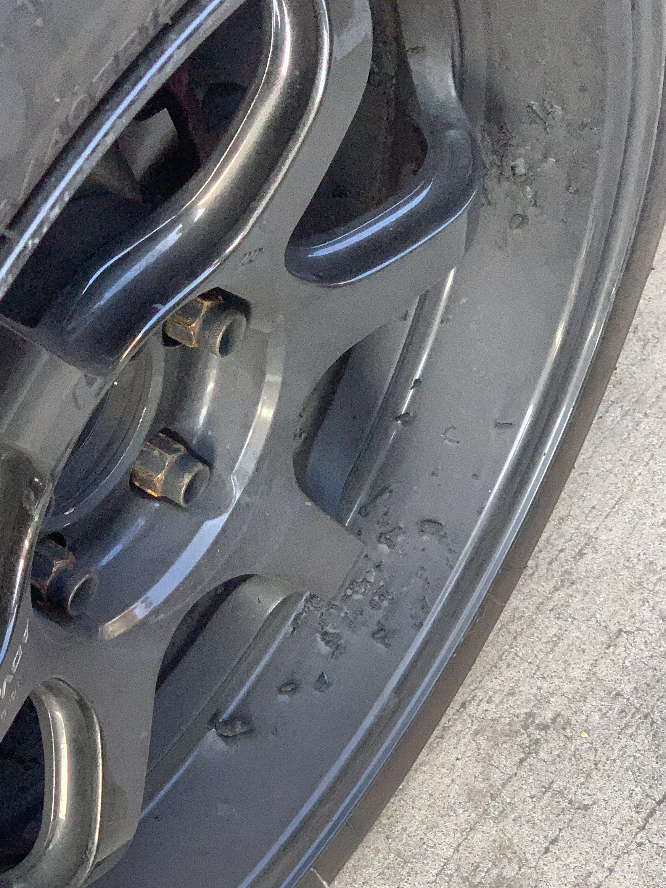

Sounds like I'll be wanting separate pads for street and track then.
Been there done that, many year ago. It’s such a pain in the ass. Just invest in some good wheel cleaner. Otherwise, exactly what Jason (kaj) is saying. I’m running Hawk DTC pads and finally got some street squeal after sitting for 2 weeks yesterday. Otherwise not much noise either.
I would keep it at 36 psi after your cool down lap and pulling in on trac
whoa- you clean the wheels?? What’s that like?
