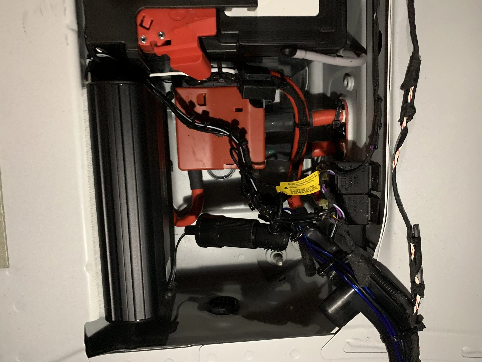

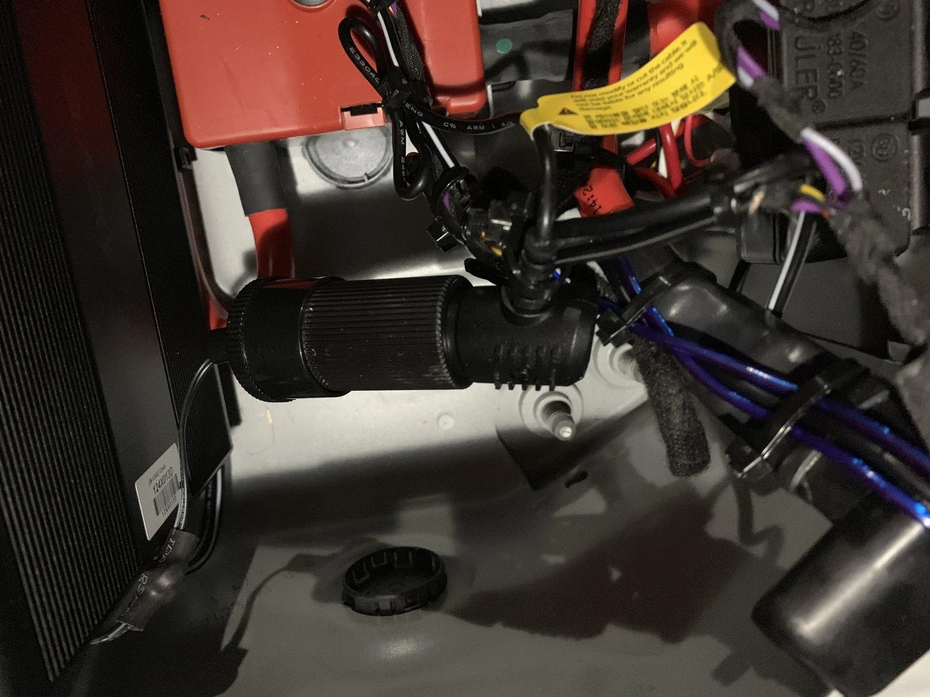

After reading several posts about people having issues with tapping into the mirror wiring with a ā€œmirrortapā€ kit, I provided my installer with the remote hardwire kit from Uniden and the mirrortap kit, and informed him I wanted the detector to turn off with the car.
He used the hardwire kit from Uniden and ran it to the rear of the car.
A 2 channel dashcam, BlackVue DR900S BlackVue DR900S-2CH with 16GB Micro SD Card | Power Magic Pro Hardwiring Kit Included | WiFi GPS 4K Recording CLOUD Connectivity https://www.amazon.com/dp/B07C3H8YXB/ref=cm_sw_r_cp_api_i_KetFDb9JZWG2W was mounted and hardwired to a Power Magic Pro battery.
BlackVue Power Magic Ultra Battery (B-124X) https://www.amazon.com/dp/B07TKYM2TT/ref=cm_sw_r_cp_api_i_eftFDb7MJ1HP8
The battery has a charge of roughly 18hrs at 4K with 2 cameras running. The car charges the battery when running. When the car is off, the cameras ONLY get power from the Power Magic battery, if that battery dies, the cameras shut off.
Some pics of the install...
Left side of pic is battery pack...
Pic of the battery to camera power connection

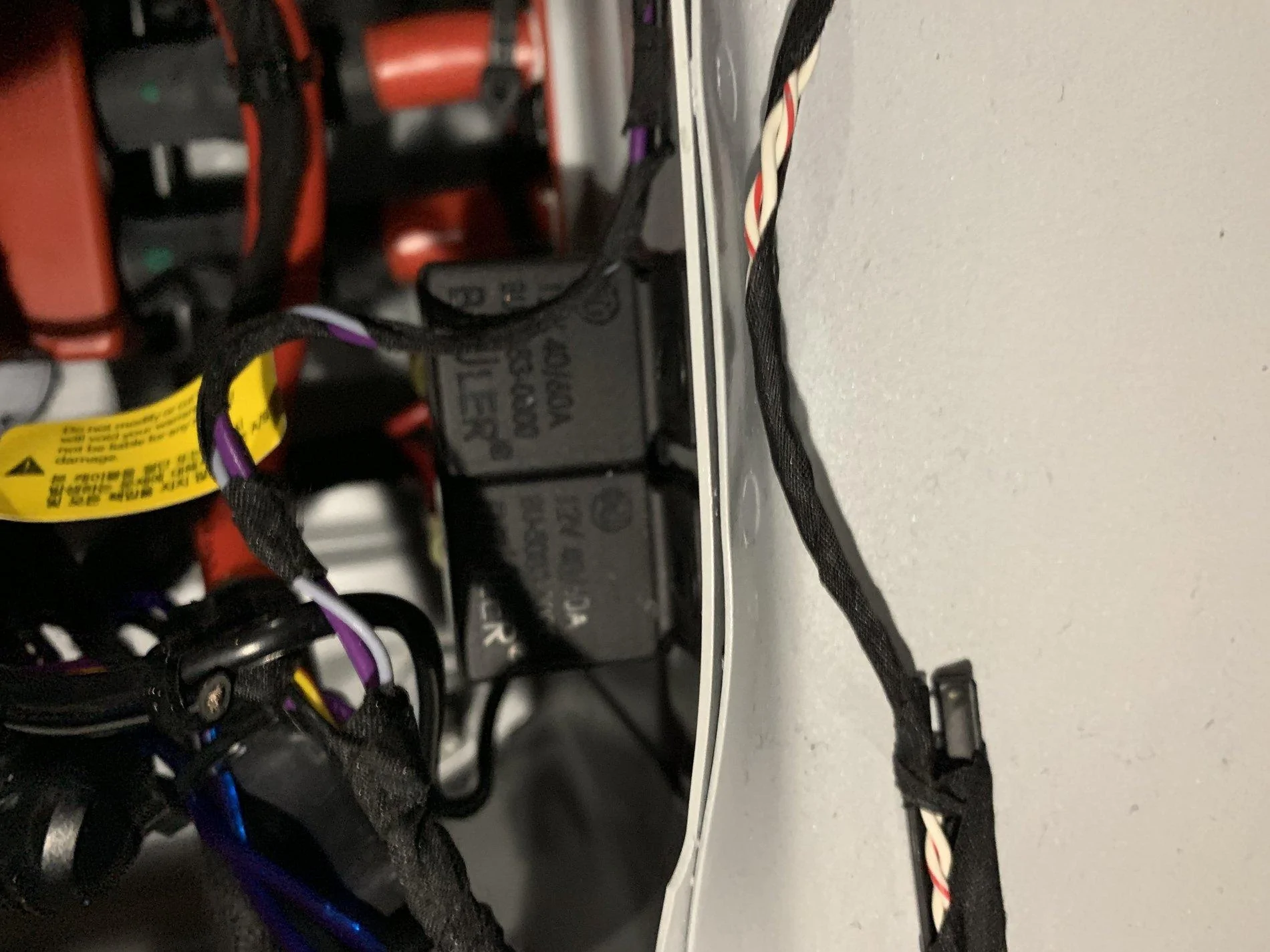

2 relays used for install.
The dashcam can simply be plugged into a 12v outlet if you wanted to....but I like things as clean and as non-cluttered as possible.
Also, the battery allows you to daisychain additional batteries for improved life. The battery isnā€™t cheap, but it is specifically designed for high/low temps, as well as fast and multiple recharges, compared to a lithium-ion.
