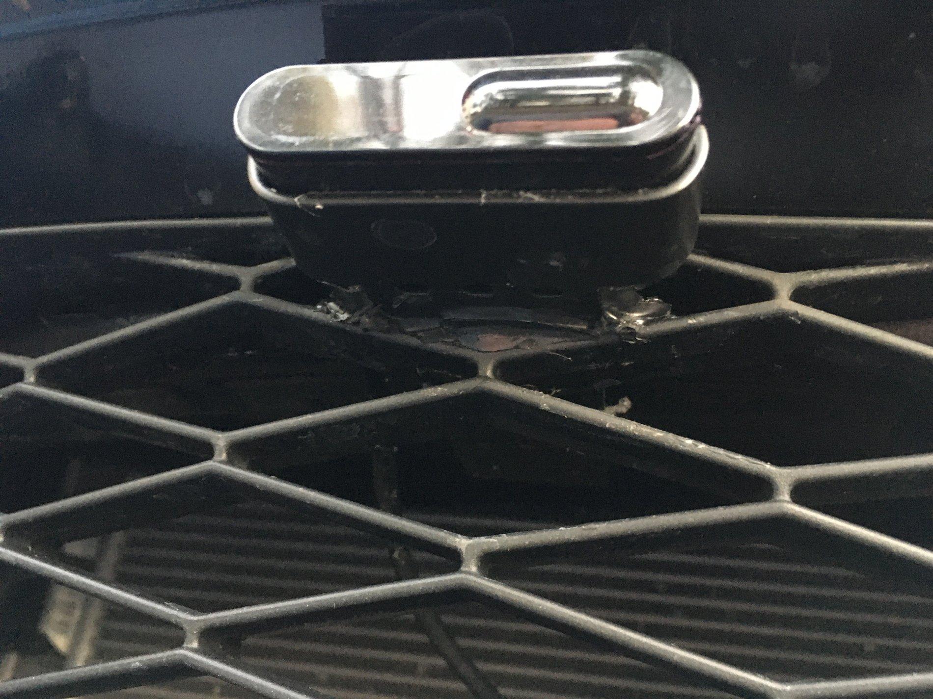

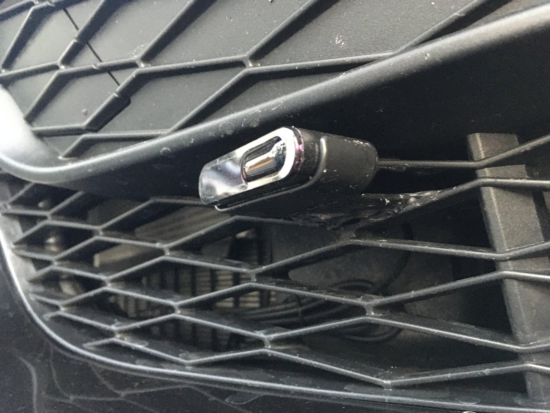

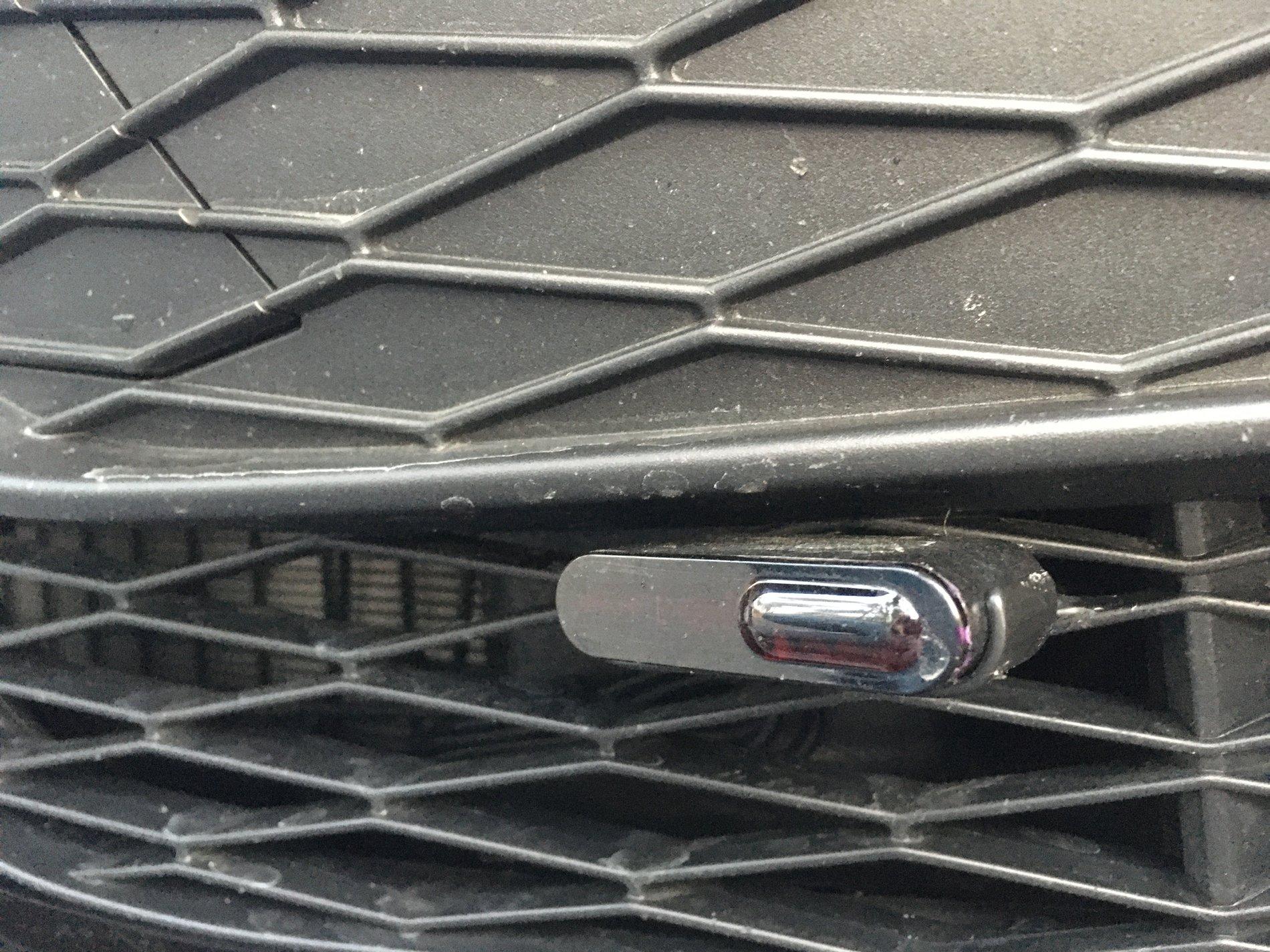

Did ya have to do any mods to the grill to get the sensors to fit?
sbodnar
Stephen
Sep 30, 2019
Boston
2020 Supra, 2015 ML400, 2014 CLA, 2007 G35X
No, I did not cut or alter the grills. I used the metal AL sensor mounts and some outdoor clear Goop adhesive. Used some temporary tape under the mount due to the angle shape of the grill, while the adhesive dried overnight, so it did not drip down. Pretty easy and clean looking. Not sure what the adhesive looks like behind the grill, but who cares. Just make sure you check the level of the mounts a few time, while it dries. Make sure the sensor mounts are out a little bit, so when you snap in the sensor with some clearance to the grills and they can be pulled/pushed a little to re-level. If you screw up, the Goop stuff can be peeled away and redone. By the way, I used Goop on my wife’s AMG 3 years ago for those AL sensors, and they are still good. Hope that helps!

Photos attached of the AL heads with supplied brackets.

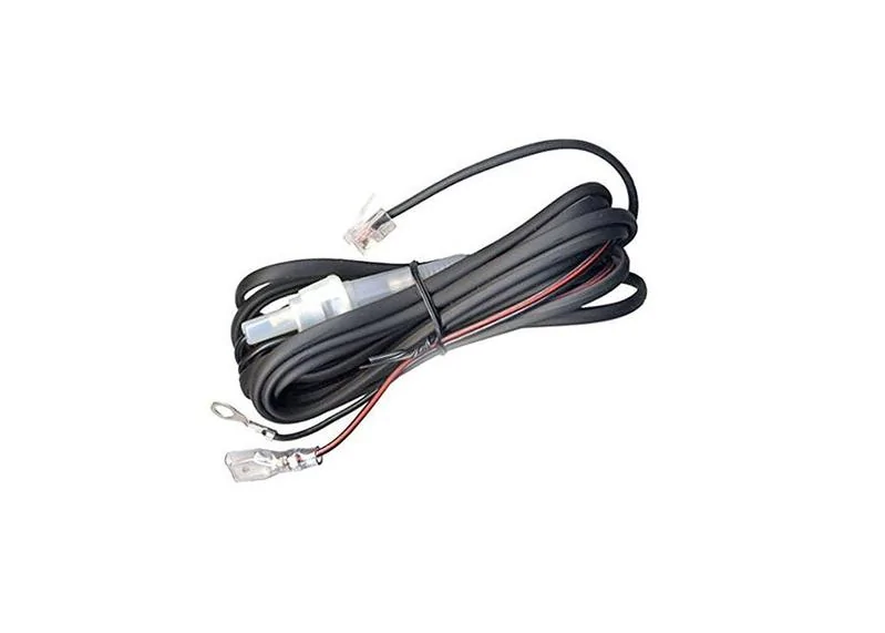

Okay, So i have a Escort ixc and wanted to know what I need to hardwired it to the car? Also, how much would it cost "estimate" to have someone hardwire it for me?
30MilesOffshore
Jan 27, 2020
379
316
Charlotte, NC

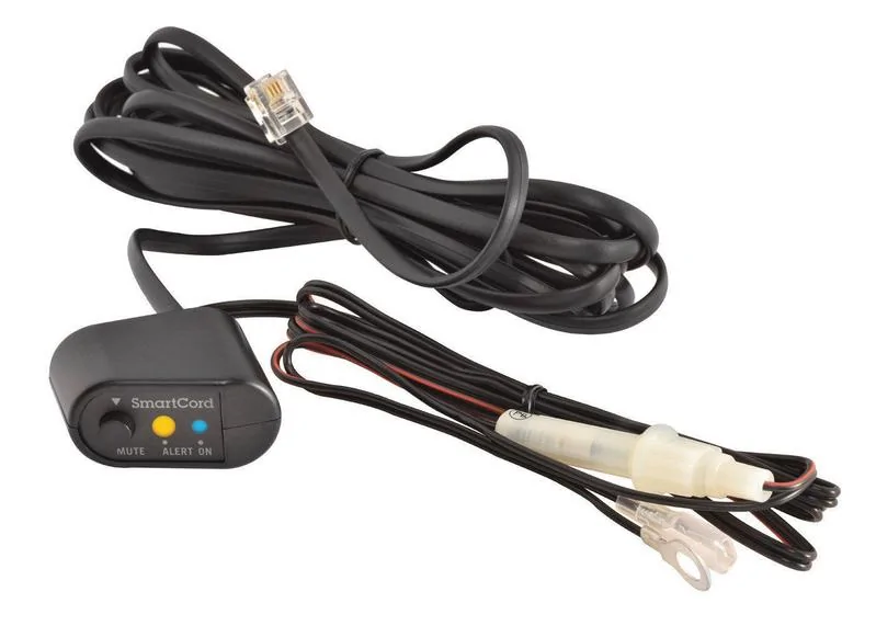

Ryco, it looks like you would only need two parts (Add-a-Circuit & Hardwire). About $7 & $30 for hardwire. Literally it's only two screws and one bolt that you have to mess with. It's a super easy install.
Per Escort webpage, you have two options to hard wire.
The Escort Direct Wire Smart Cord Item # 0010057-1. The only thing I didn't like about that wire was the mute button that's built into it. Not sure where you would want that mounted.
0010057-2_DIRECTWIRE_SMTCORD_BLUE_032618_973d878f-e7b6-4394-9452-7178683a5eff_800x.jpg
The other option is just a direct hardwire and you can tuck the cords all away stealthy in the headliner edge and down the pillar to the fusebox. Escort Direct Wire Item # 0010058-1
