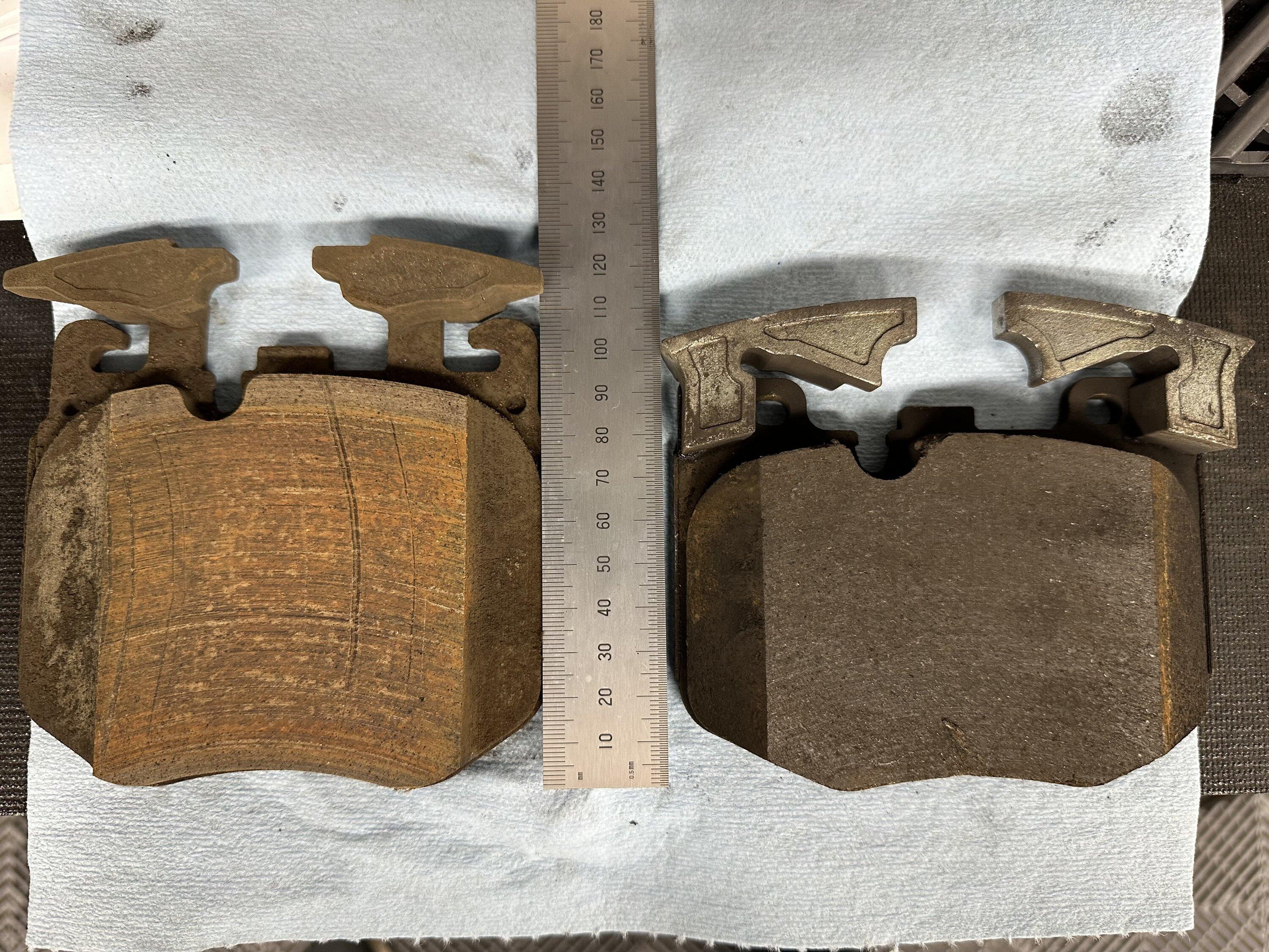

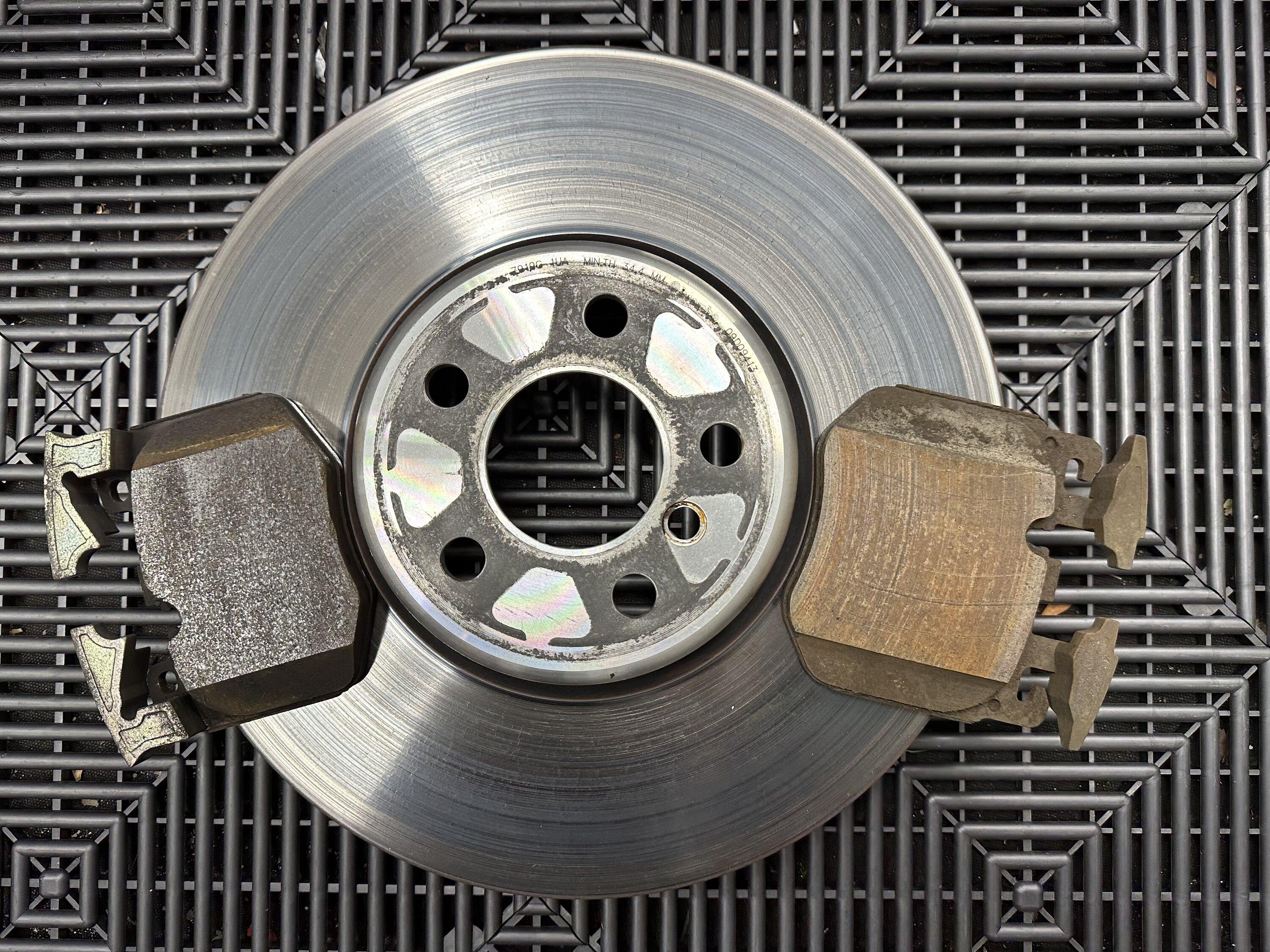

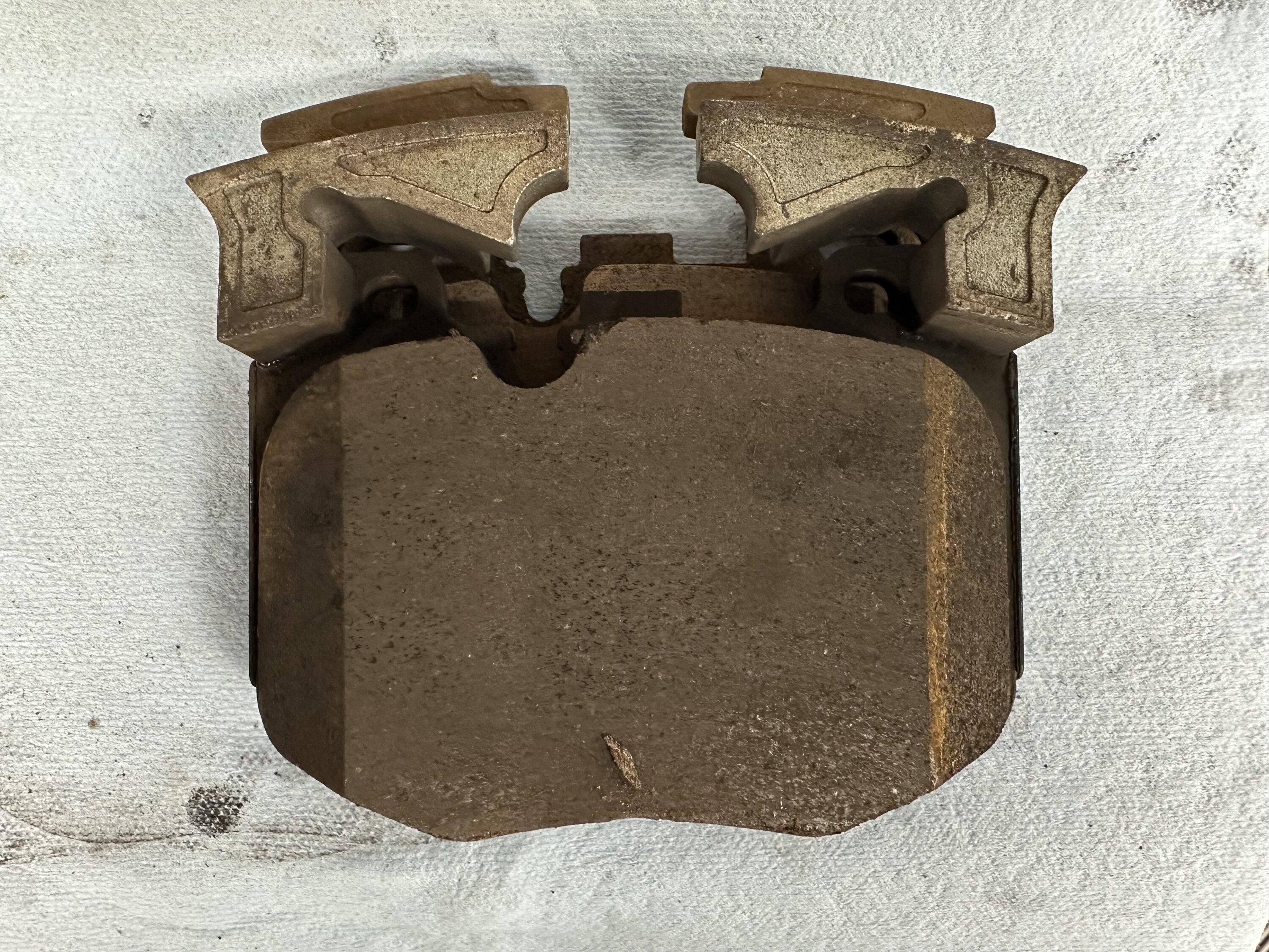

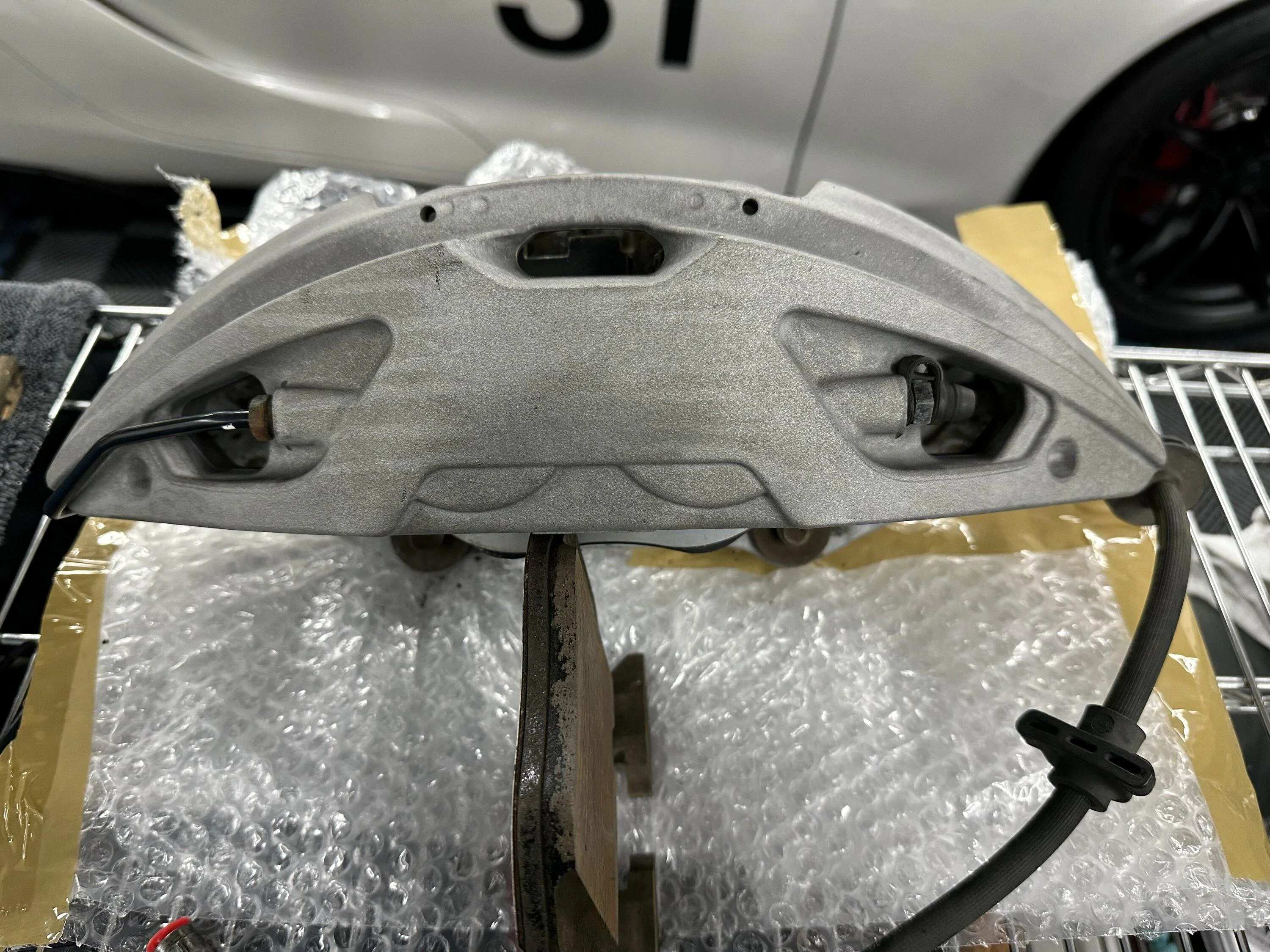

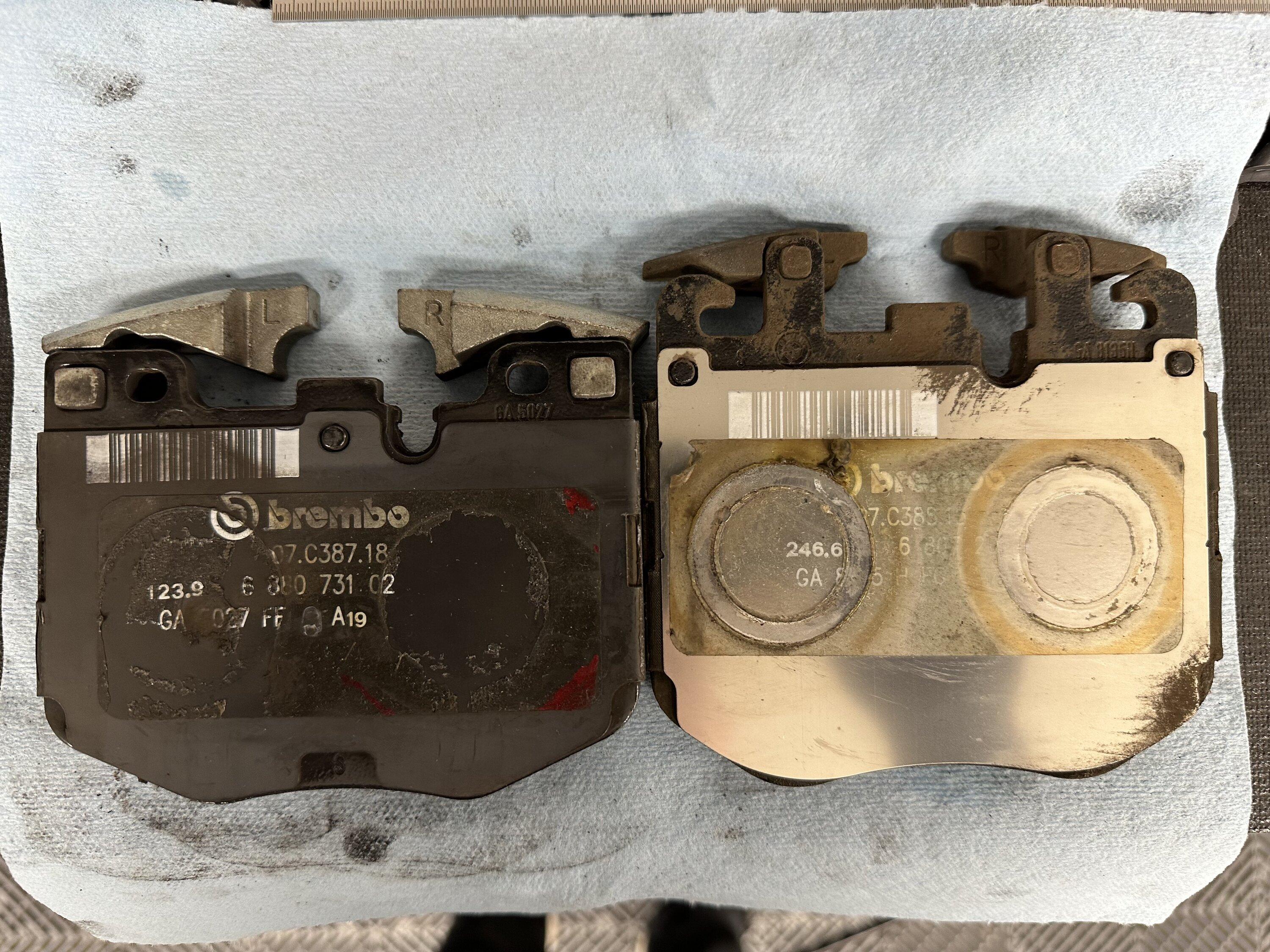

So the 374mm rotor caliper showed up today. As I stated earlier, this project is dead in the water for me because of the lack of brake pad options for both the 374mm rotor caliper and the 395mm rotor caliper (same pad part number) however, here are some measurements and photos...
Perhaps the new top secret Supra model with the 395mm rotor calipers will help expand the brake pad offerings.
348mm rotor caliper (OEM Supra, M240i, M340i, M40i Z4, and some others, considered "M-Sport" brakes)
Brake pad measurements
Actual pad material: 78 tall x 120mm wide
From pad mount pin center to bottom of pad: 85mm
Pad backing plate width: 125mm
374mm rotor caliper (M340i with Motorsport engineering package S33TA, 750i, M-Sport brakes on 840i,740i, 540i, X5, and some of others)
Actual pad material: 94tall x 120mm wide
From pad mount pin center to bottom of pad: 100mm
Some photos:
Caliper (these are available in unpainted silver like this example on the non "sporty" models. Available in blue, red and black on the sportier models)
Brake pads:
Stacked on top of each other:
Comparing them on a 348mm rotor (OEM Supra):
