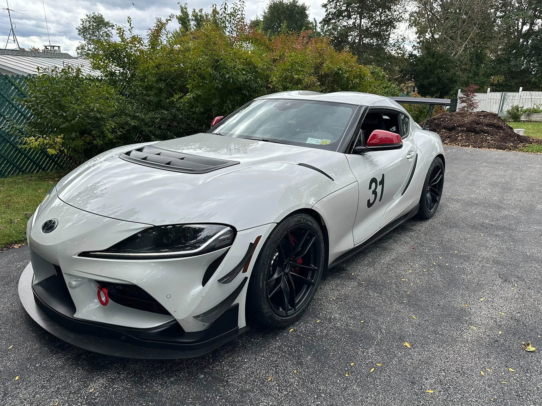

are you on stock suspension running those 18x10.5 up front?
tomfree
Tom
May 23, 2022
329
407
Gaithersburg, MD
'22 Supra 3.0 Premium
I have Verus Camber plates in front, but still on stock springs and dampers. I run a 15mm spacer at all corners Alignment in front is -3deg camber, 0 toe, 8deg caster. I've NEVER had rubbing with this setup, and there is room in all directions with a 275/35/18.
