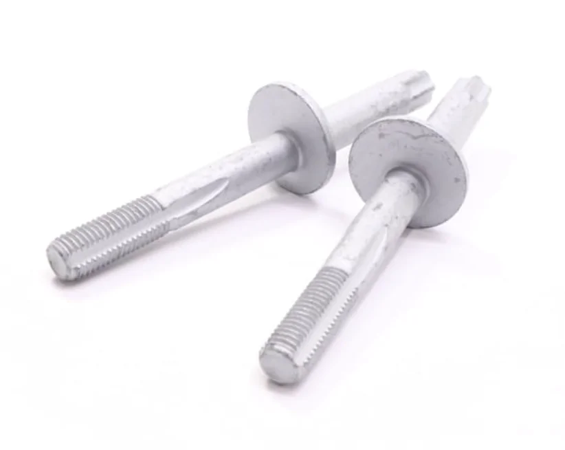

just an FYI if you go all the way one way the eccentric can basically flip to zero. It's actually pretty easy to spin them fully 360 accidentally. They can be finicky. Think of them like cam lobes, because pretty same same.

Yeah, I've worked with similar bolts before. In this case I spun them around 360 degrees several times while also pushing/pulling on stuff to make sure the adjustment was doing what it should be. Camber would go over -3, then back down to -2.6.
