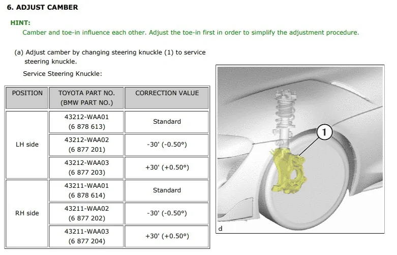

you can get different OEM knuckles.
Toyota #:
Right:
43211WAA01 (standard)
43211WAA02 (- negative camber)
43211WAA03 (+ positive camber)
Left:
43212WAA01 (standard)
43212WAA02 (- negative camber)
43212WAA03 (+ positive camber)
BMW #:
Right:
31216878614 (standard)
31216877202 (- negative camber)
31216877204 (+ positive camber)
Left:
31216878613 (standard)
31216877201 (- negative camber)
31216877203 (+ positive camber)

Does this make camber adjustable or it just changes the static camber value? Guessing this should be Street legal?

Nope. Not legal according to the 2023 rule book. I can see at least three areas that specifically wouldn't allow this part substitution.

It’s legal, unsure where these people are getting their info from. It’s a FSM repair part

straight from the toyota service manual:

I stand corrected.
Not worth it for an additional 0.5 degrees of negative camber IMHO, but to each their own.

Depends how competitive you are. When the competition is within 0.005s at Nationals, every last bit of edge helps.
