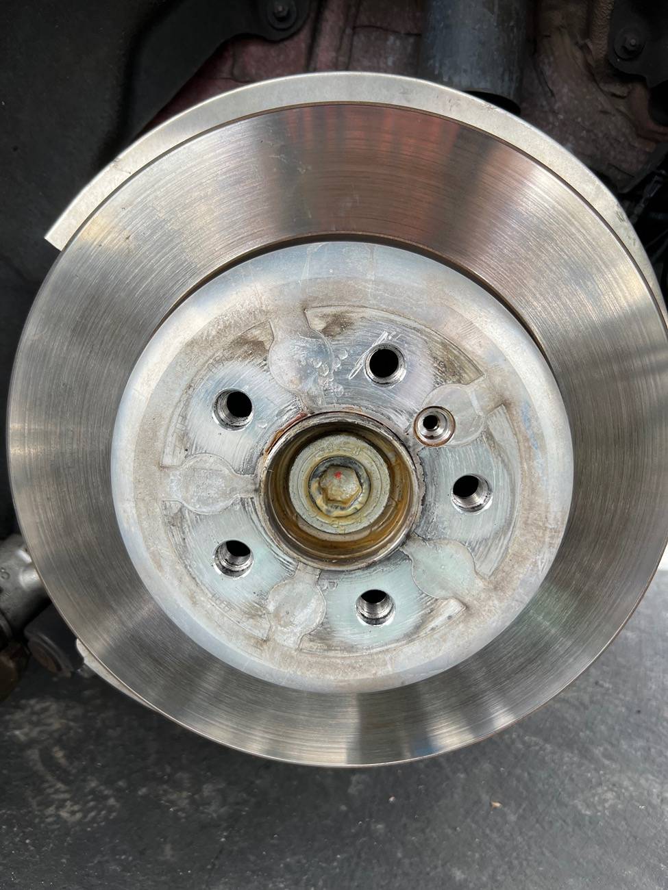

Rear rotor won’t come off, please help!

Using a purse never worked for me when trying to get rotors off.
Use the Brake bracket bolt hole, use a smaller bolt and a nut to create a screw jack. Use a cloth if you don't want to damage.
Do it a little then rotate the brake disk. Should pop off eventually. Be careful not to dig in to much into anything.

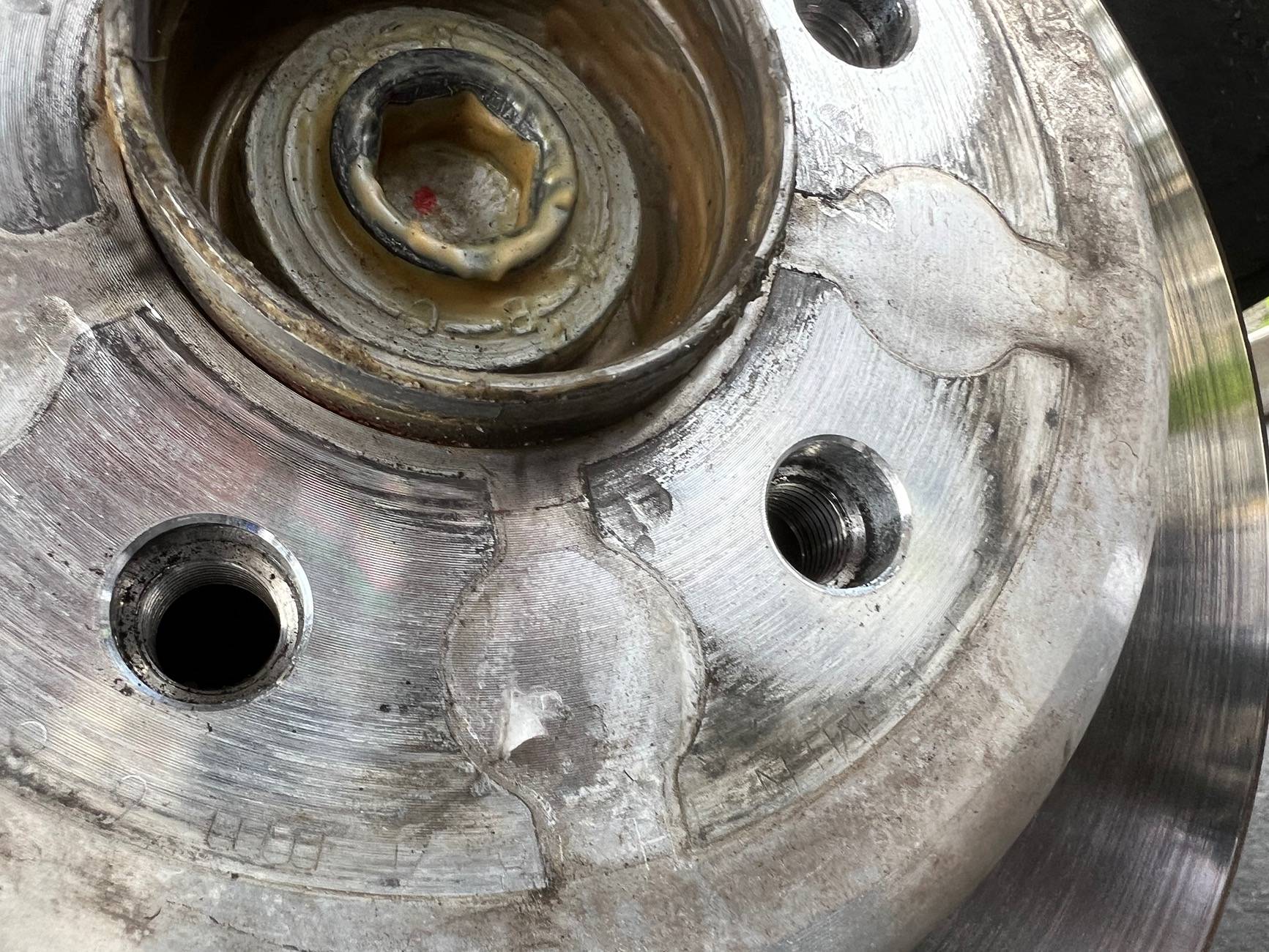

Not to mention the fact that common aluminum anti-seize completely liquifies at those temperatures and then gets slung all over the place.
Granted I personally DO apply some on the hub, and the mating surface of the rim, but I use Nickel-based anti-seize, a layer so thin it hardly exists, and ONLY on the known contact spots. I also don't track the car, so there's that.

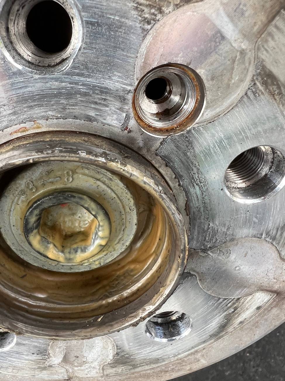

I’ve only seen this with OEM rotors, when helping friends. You figure those OEM rotors have been on the car quite a while, endured some good saltwater (in the air during transit), maybe salty roads up north or just driving rain. Regardless, as others said, good whack - outside & inside or both sides if needed will do it - easily and quickly.

Lmaoo I was able to get it off after a handful of hits with the purse.

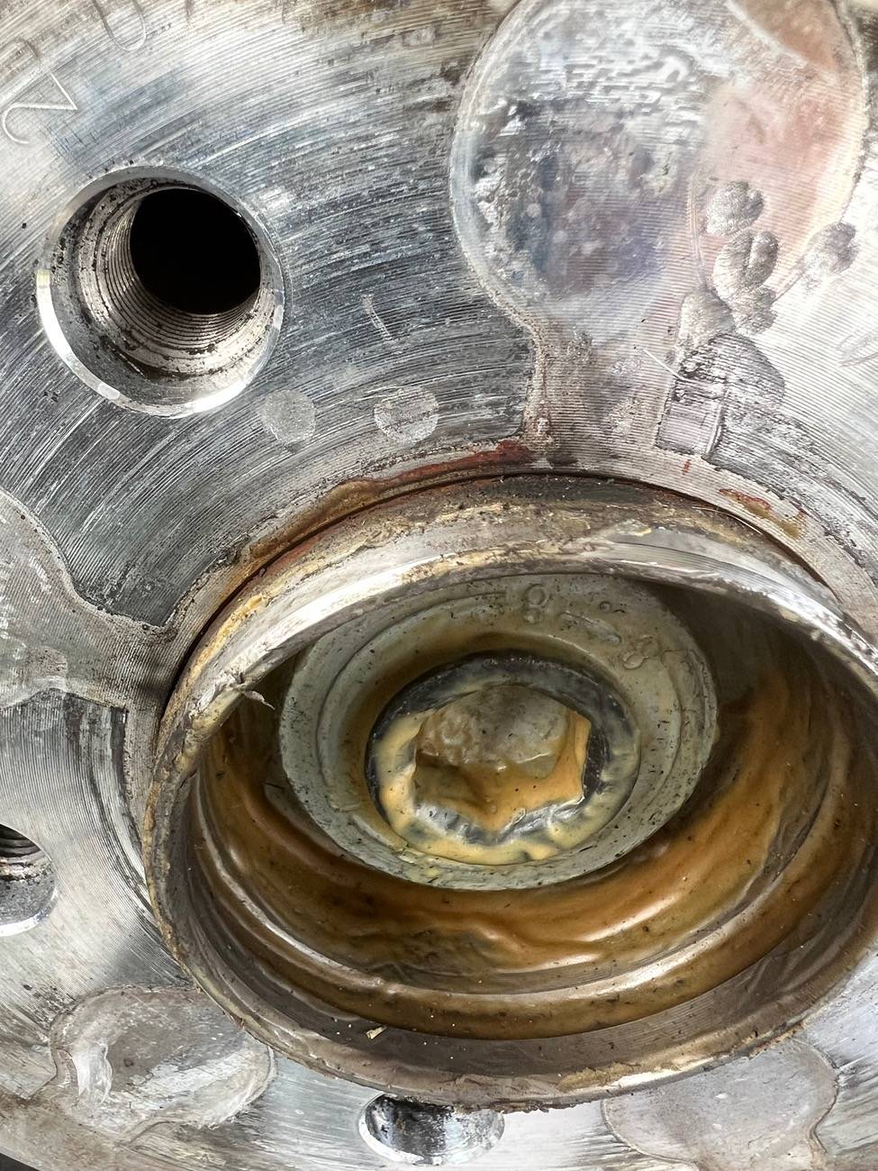

the dead hammer i bought worked wonders after a bunch of solid smacks and a can of brake cleaner I had laying around to spray between the rotor and hub to loosen the rust.
Thanks all for the support
