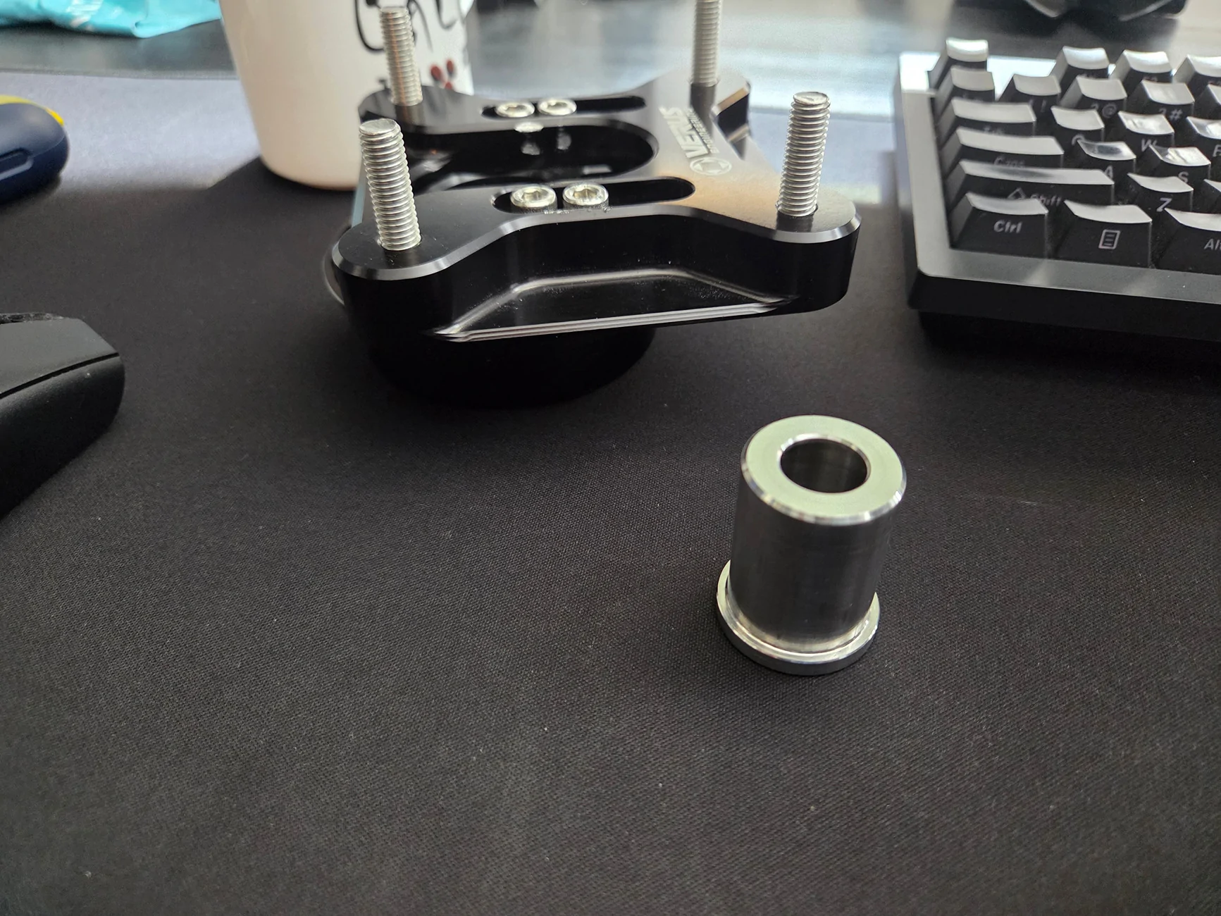

I have run my verus plates for 4ish years now and easily over 20 track days. No clunk. Maybe it’s cause I made my own misalignment spacer?
what is a misalignment spacer?
The little metal bushing you put in to offset shaft size vs bearing ID. I run ohlins and was the first to do it. So I had to make my own. I am the reason why they offer the ohlins solution. My design.
ah! Never knew that’s what it’s called!
I think the issue is the 4 four screws that mount the plate to the car can back out when you torque the top 4 nuts… but I even put loctite on them and it didn’t help so idk
I’m not messing with these no more
Is it this?

So did you figure it out. My driver side is clunking after versus camber plates
