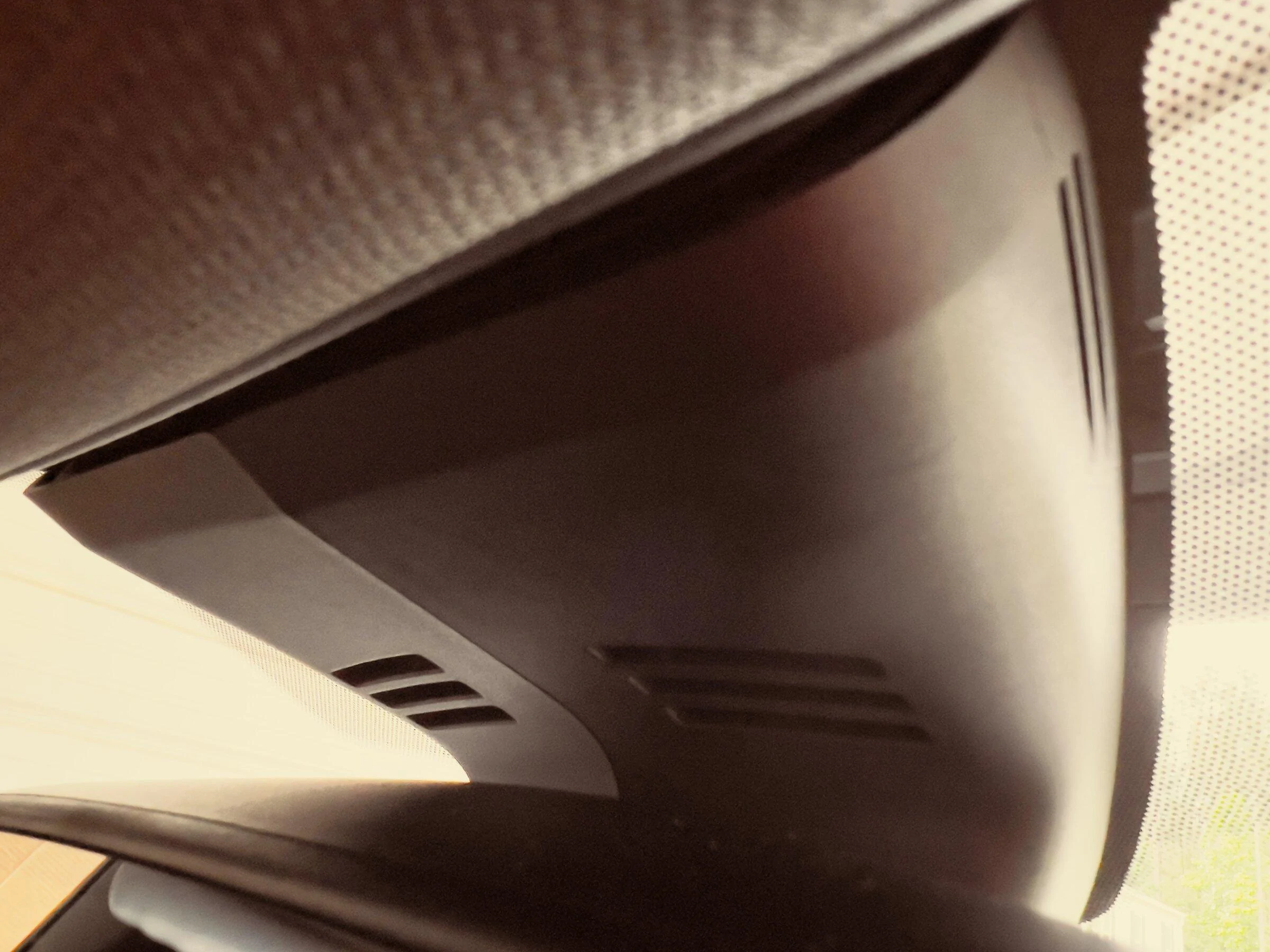

Sooo... Need a little more help. This is what I'm faced with with the rainshroud. I pressed and pressed until my face was blue. It won't come apart. Need some suggestions please. I tried to pry it apart but didn't want to break anything.

If i recall correctly, I used a trim removal tool on the bottom side of that cover. Once you get a good gap in between them, you gotta use a good amount of force
Thanks. Didn't happen to make a video, did ya? 😁

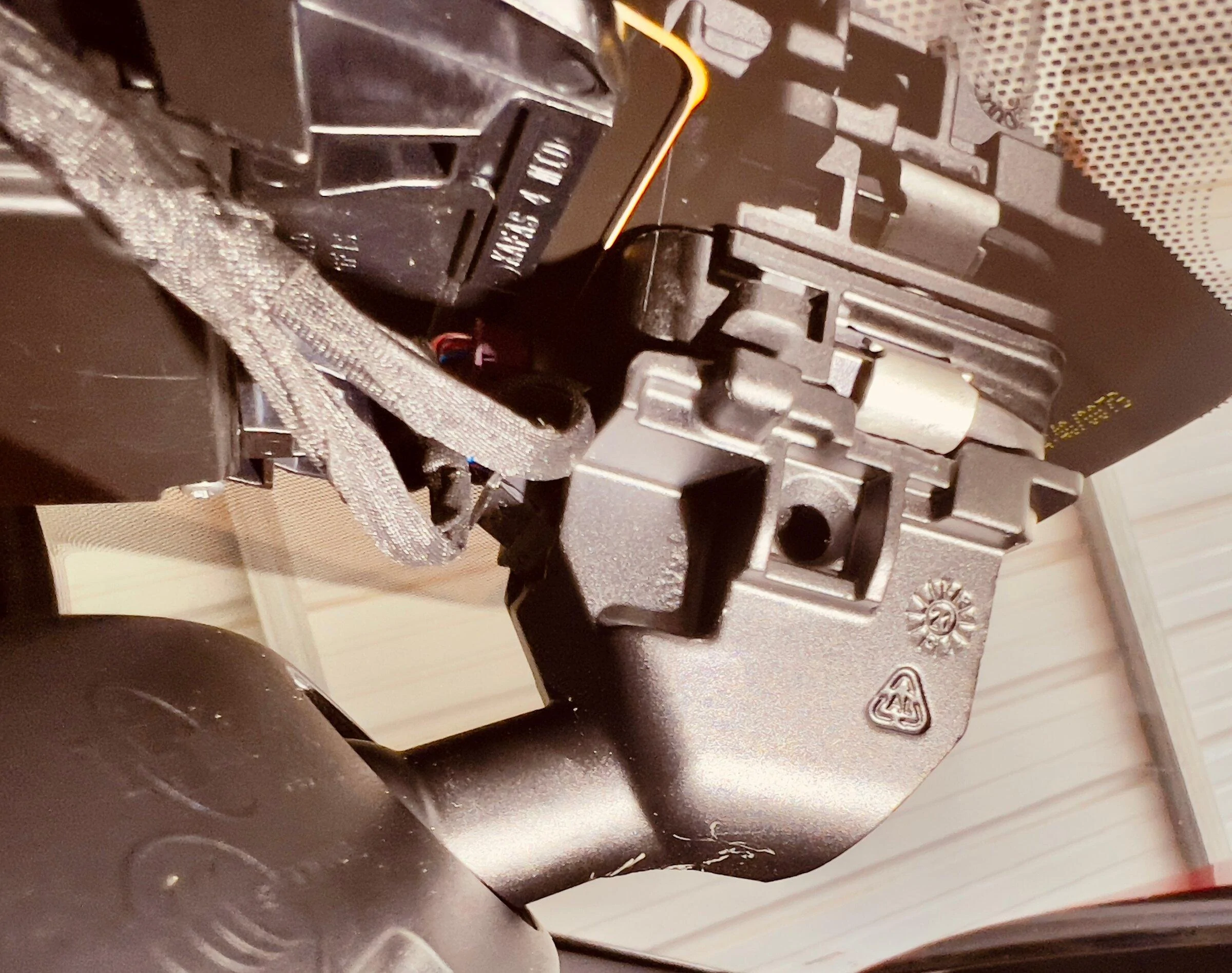

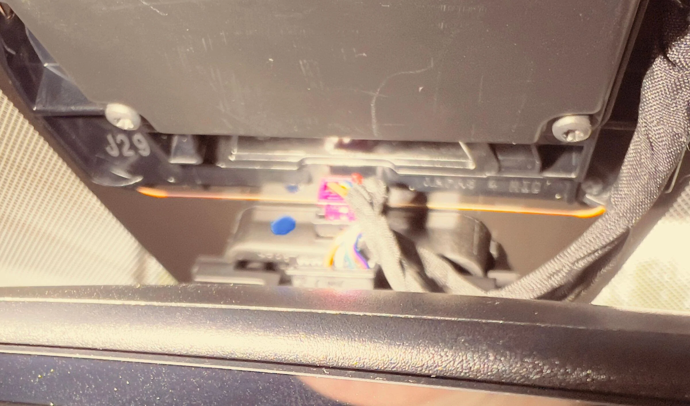

OK, got the shroud off but I can't get the connector out. Can't remove mirror that is solid. What's the trick in removing the connector? Thanks. I've had to go thru this with every new car and it's such a pain in the ass.
Man, this is so frustrating. The video doesn't show how to remove the pink connector.

I just stuck my mirror tap prongs into the pink harness. I didn't bother unplugging it.
