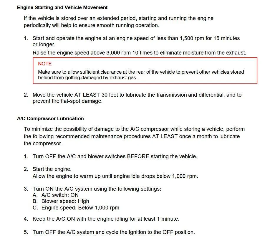

I would avoid doing that. Starting it up and idling without actually going for a drive will wear out the battery more and causes condensation build up in the drivetrain.
Im leaning towards pulling the battery in this case. The rear hatch issue (where it needs power to prop itself up to unlock) seems to be solvable by attaching a battery/booster to the connection point under the hood when I am ready to hook the battery back up, according to this reddit post.
As per the TSB to prevent the moisture you're mentioning:
