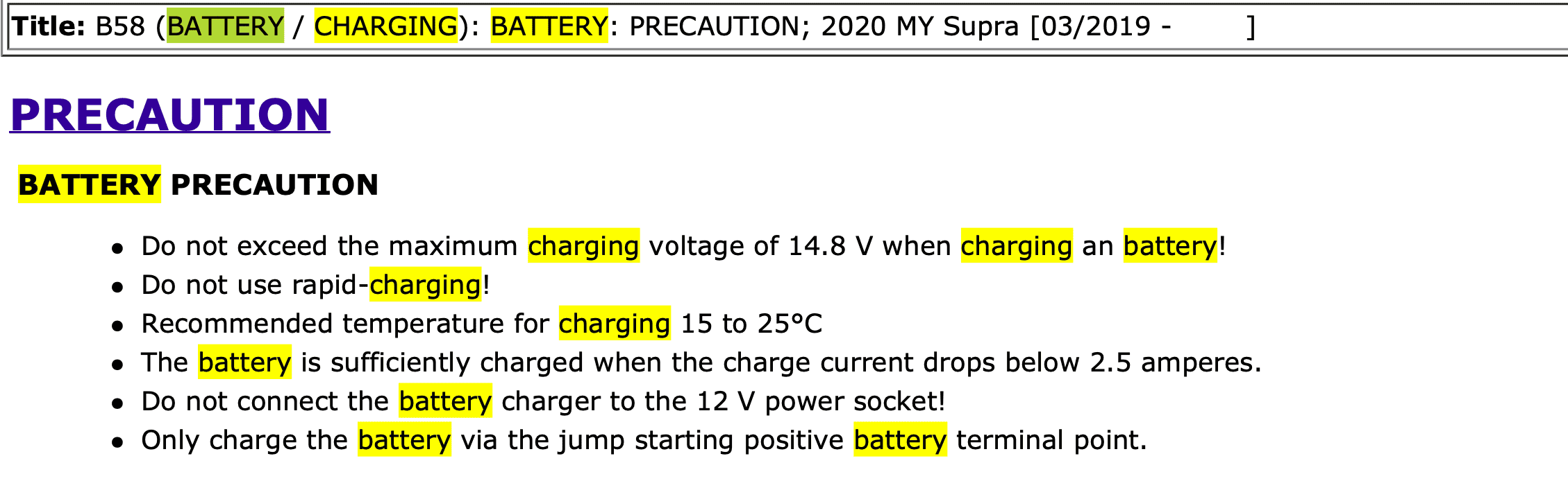

Does anyone know if it's safe to charge from the back? (As in directly in the battery terminals) Or should it be in the front? I heard the design was made to be charged from the front so I wonder if it's true or if it matters.
Thanks!
consultadrone
Jan 23, 2020
495
492
Southern California
Thanks!
Short answer:
It’s true and it does matter. Always charge/jump from the posts under the hood.
J29DB03
Dec 14, 2021
2,319
4,708
2021 3.0
Thanks!

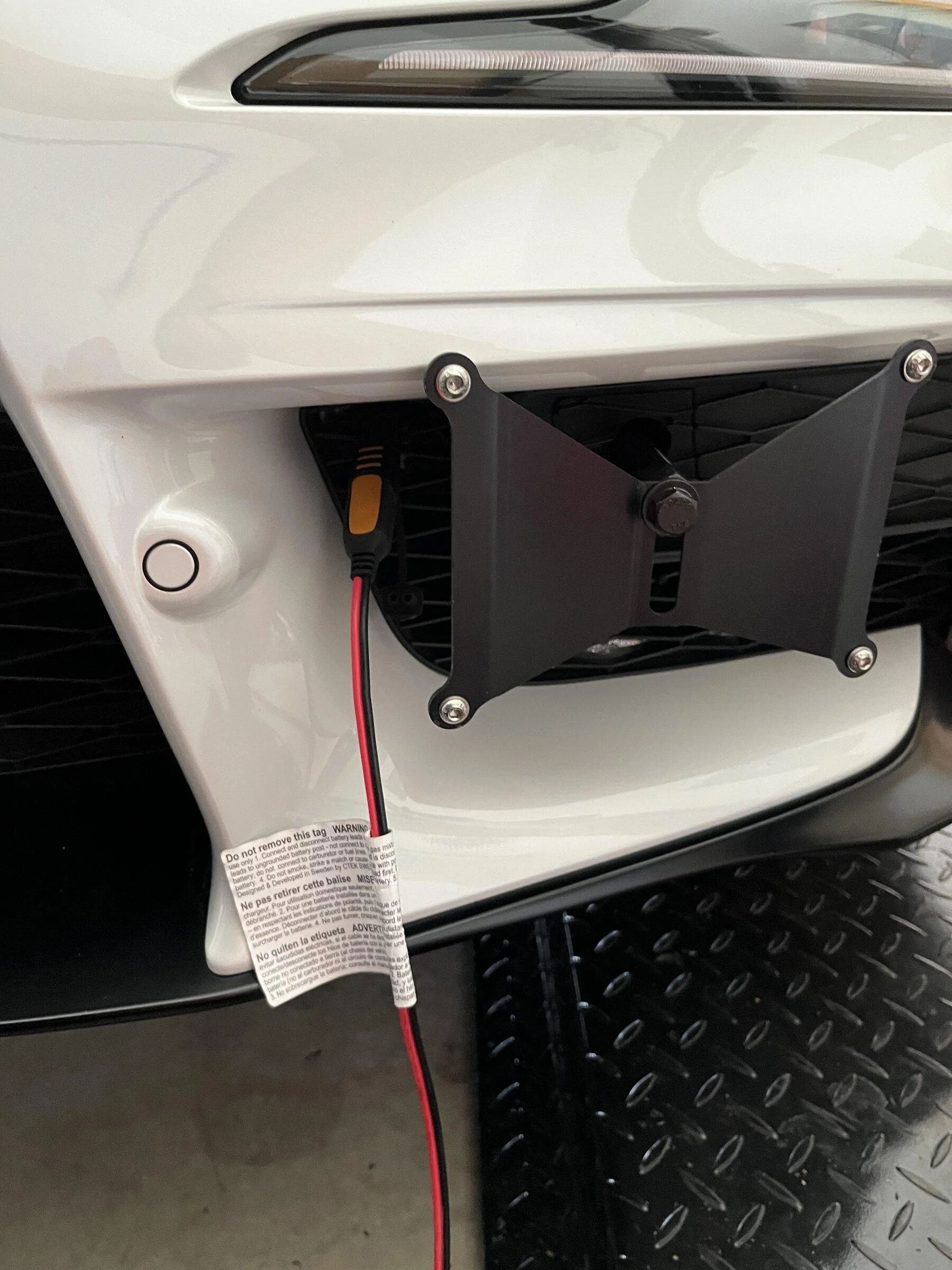

Firstly, the front is the ideal and, according to BMW, the correct placement for a charger. That being said, some have used the battery directly and I haven’t heard of any issues. Someone correct me if I’m wrong but the reason they say to not charge from the battery directly is because chargers and AGM batteries sometimes don’t play nicely together. However, if you have a charger that has an AGM setting (CTEK 5.0 for example) then it would be OK to go direct to the battery. I have the CTEK and still use the front to be safe. Plus, the front allows me to latch the hood and not have the wires smashed causing a “hole” in the weather stripping.

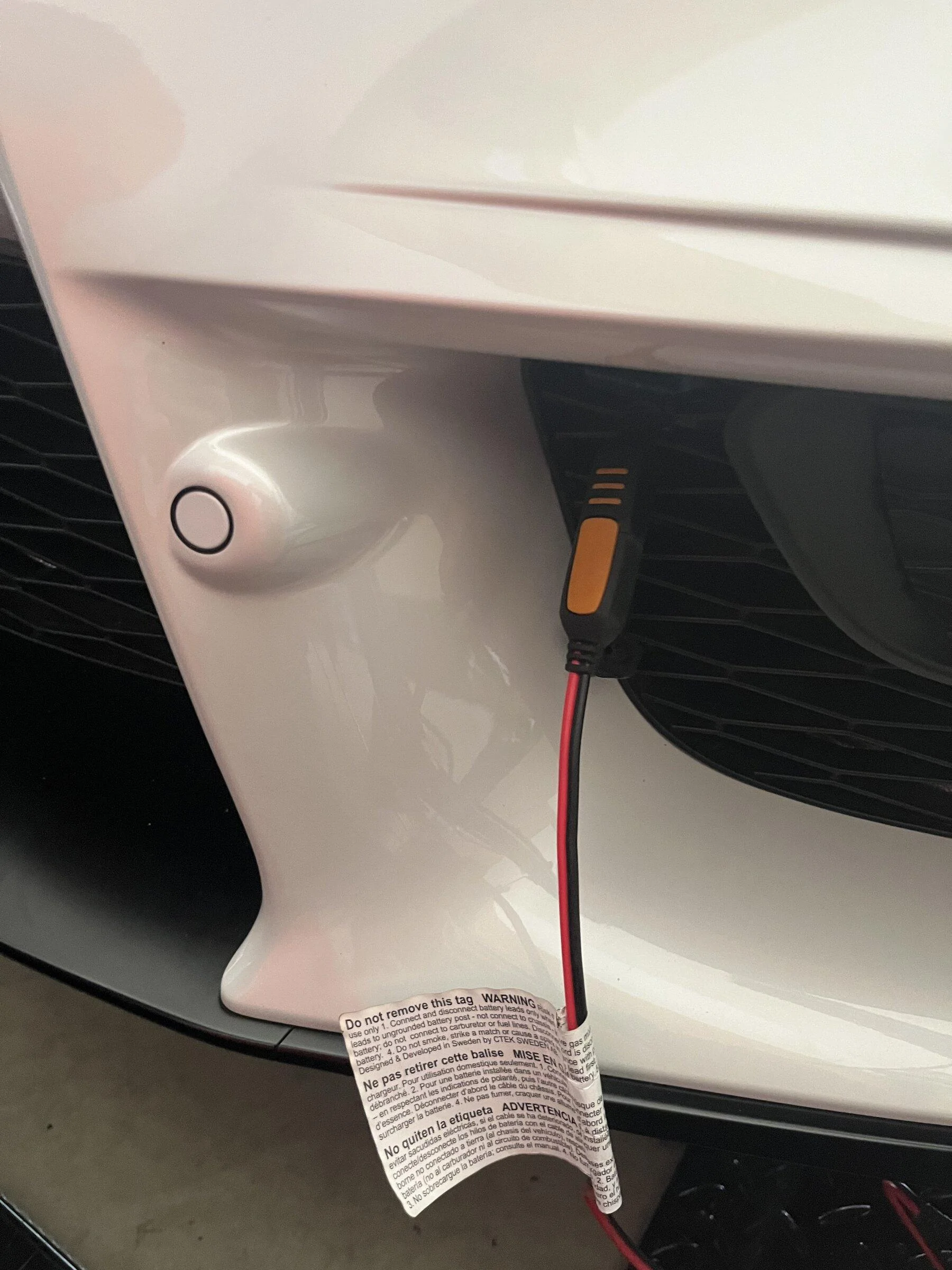

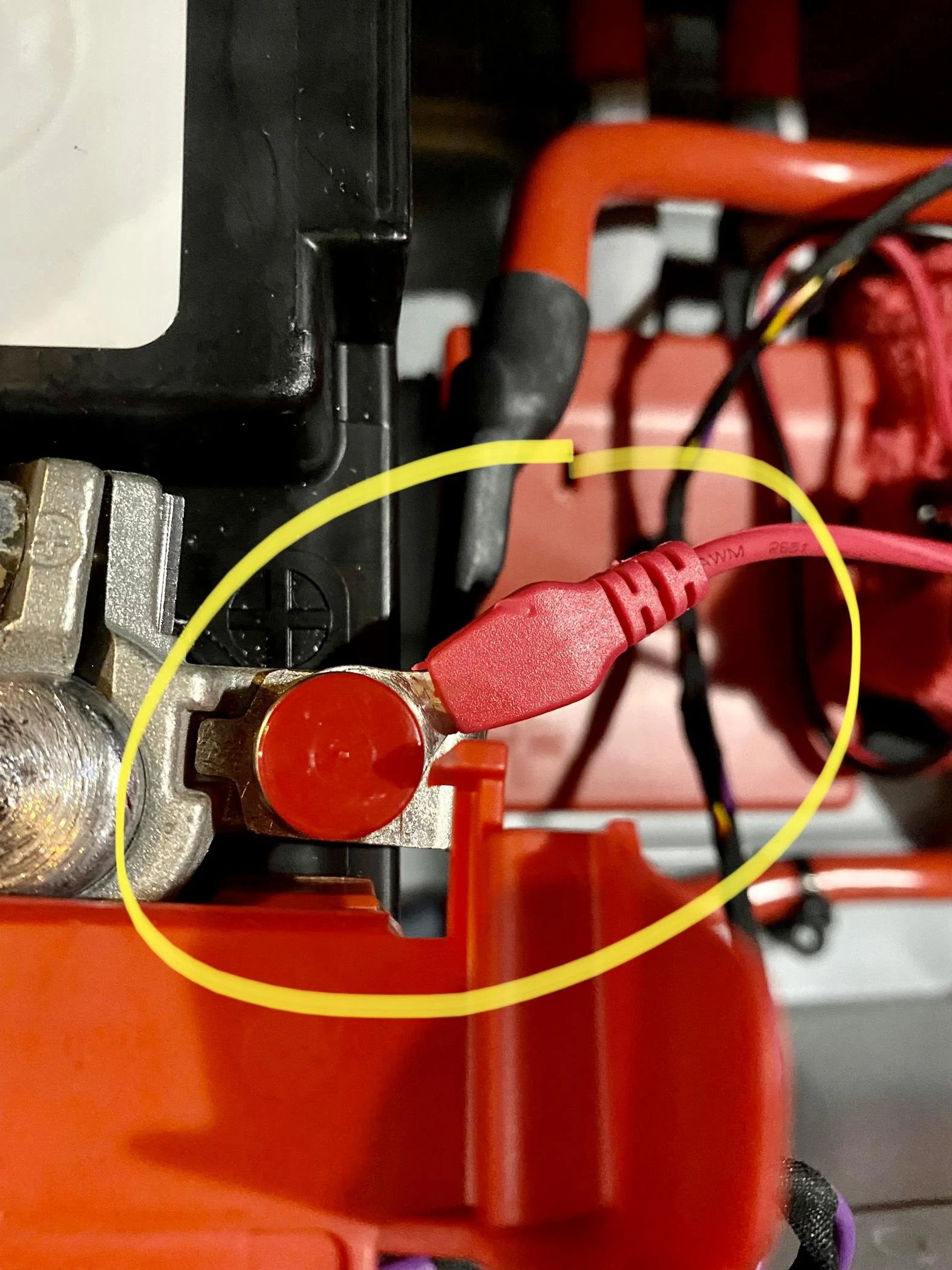

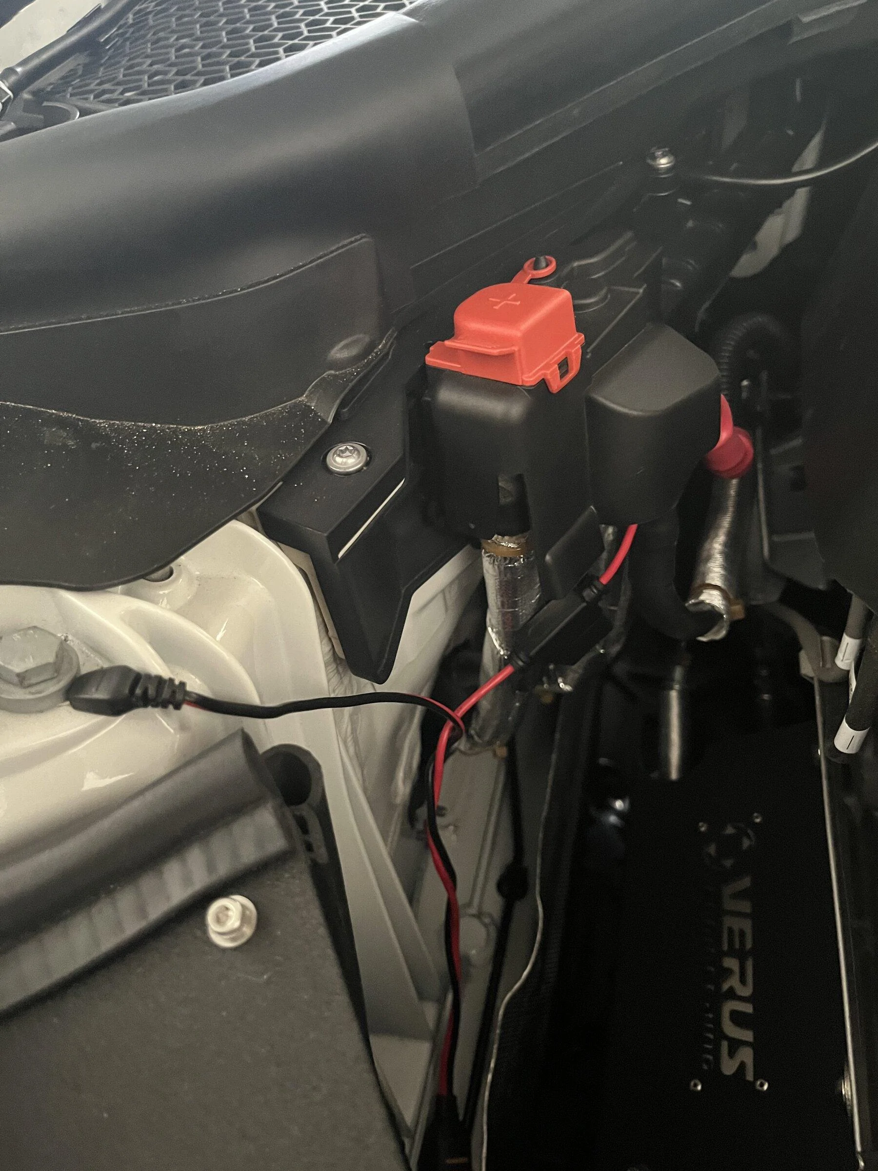

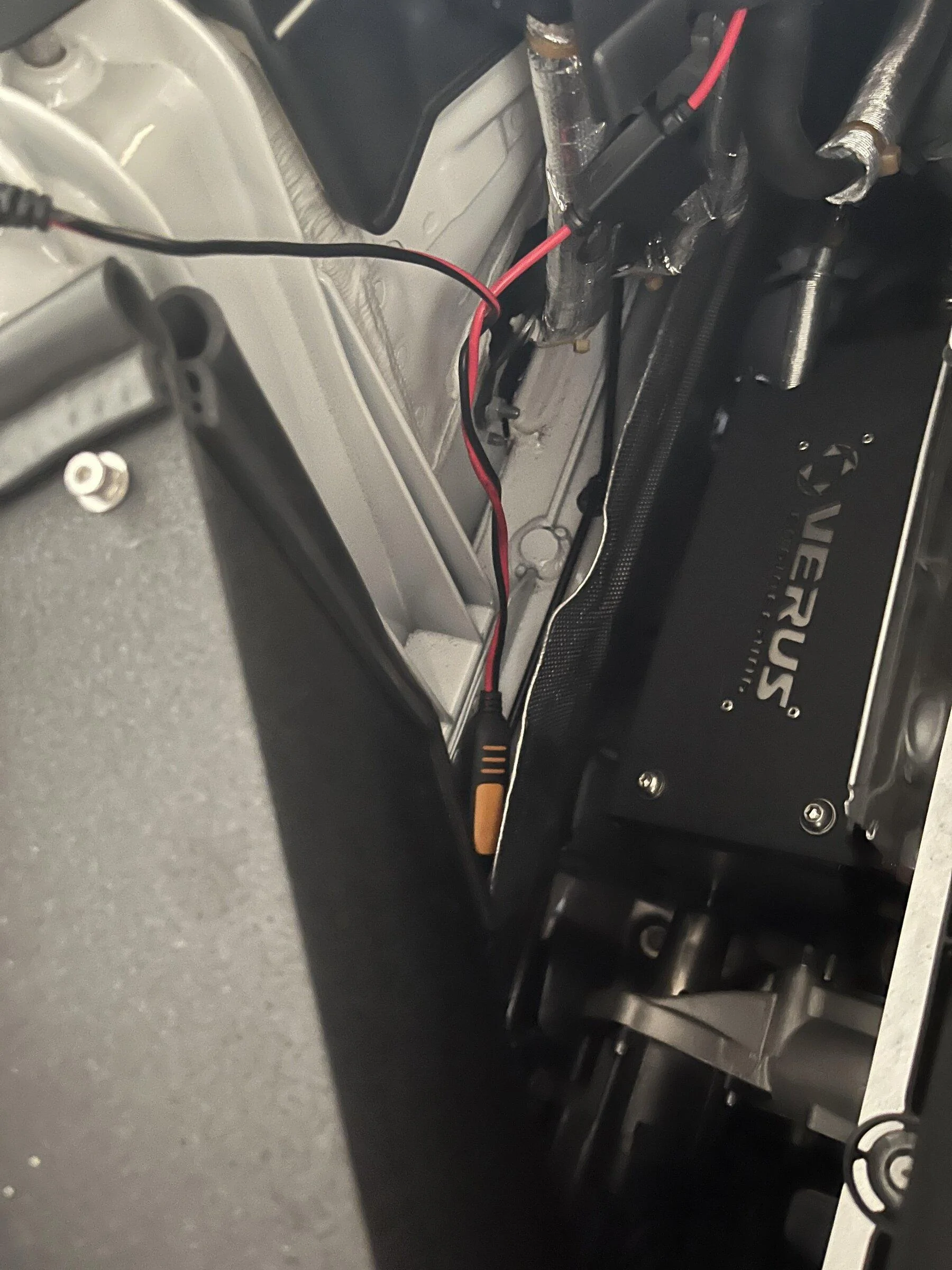

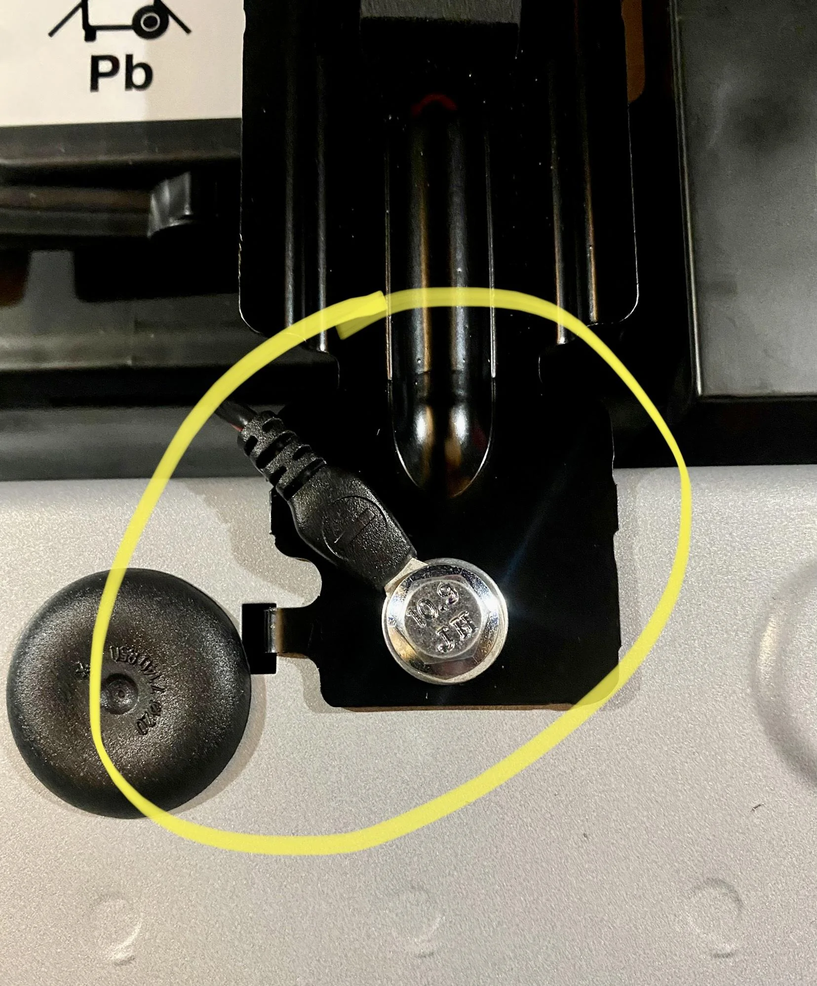

I have elected to trickle charge mine from the rear battery area. I just leave the cables attached (safely sealed off with provided caps) and plug in when stored for the winter.
See photos below of my mounting points.

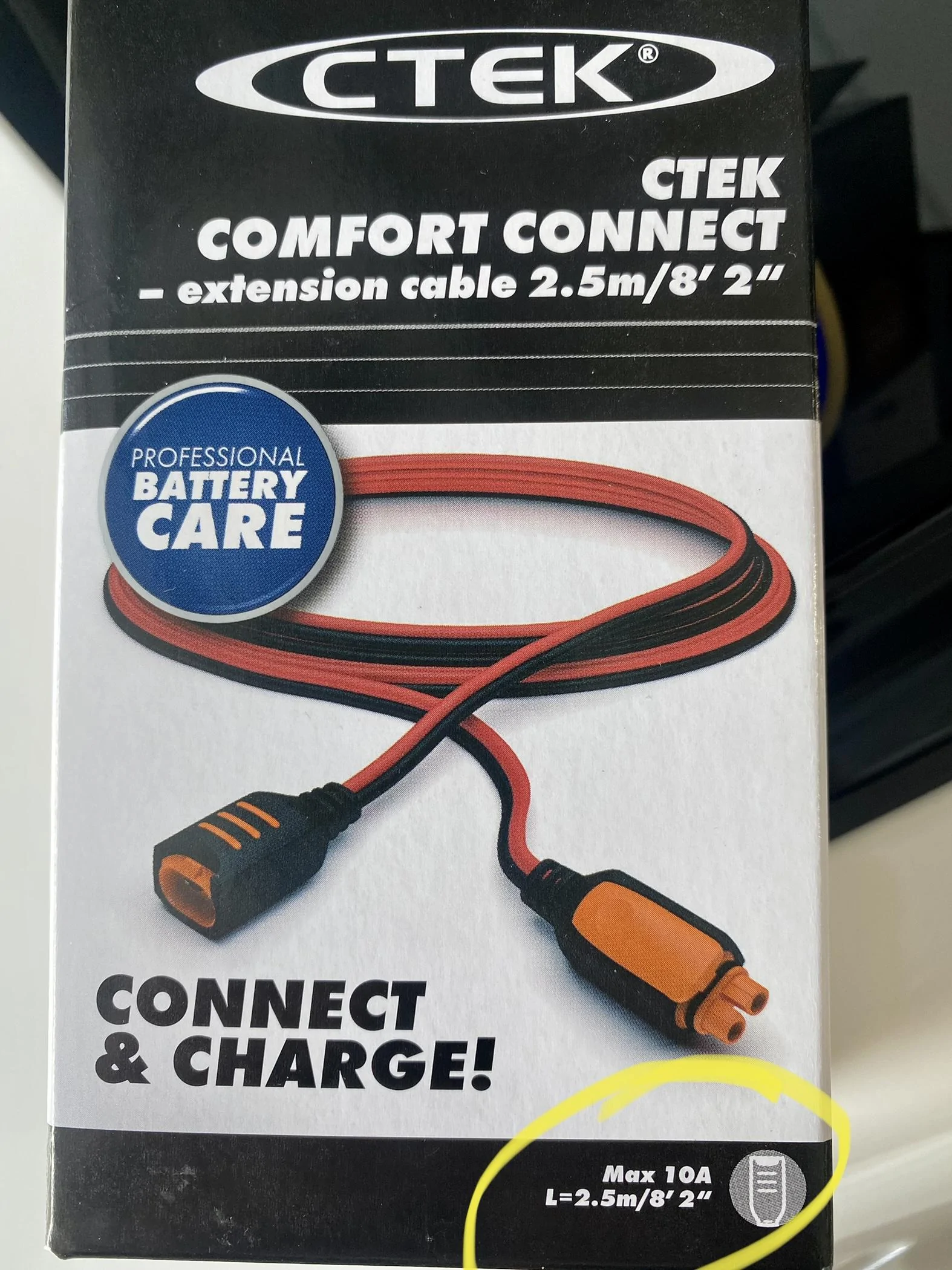

I used to do what Andrew4Supra did until I heard about this "only do it at the front" idea. I haven't noticed any issues having done that for months but it could be not recommended because it could risk something happening later
Either way, I've moved it to the front now. It's just less ideal for where I'm storing my car because the charger and outlet position is awkward for the front. Maybe I'll get that extension cable.

Just purchased my used 2021 A91 (had it two weeks) - Bought the CTEK MXS 5.0 and will be hooking up in the next few days. I will be using the same setup as some on this thread(+ lead to bolt beside the main + charging lug and the - lead to bolt adjacent to the bolt for the strut brace. My question though - has anyone tried to take off the actual + charging to hook the charging lead beneath it? More curious than anything else.....

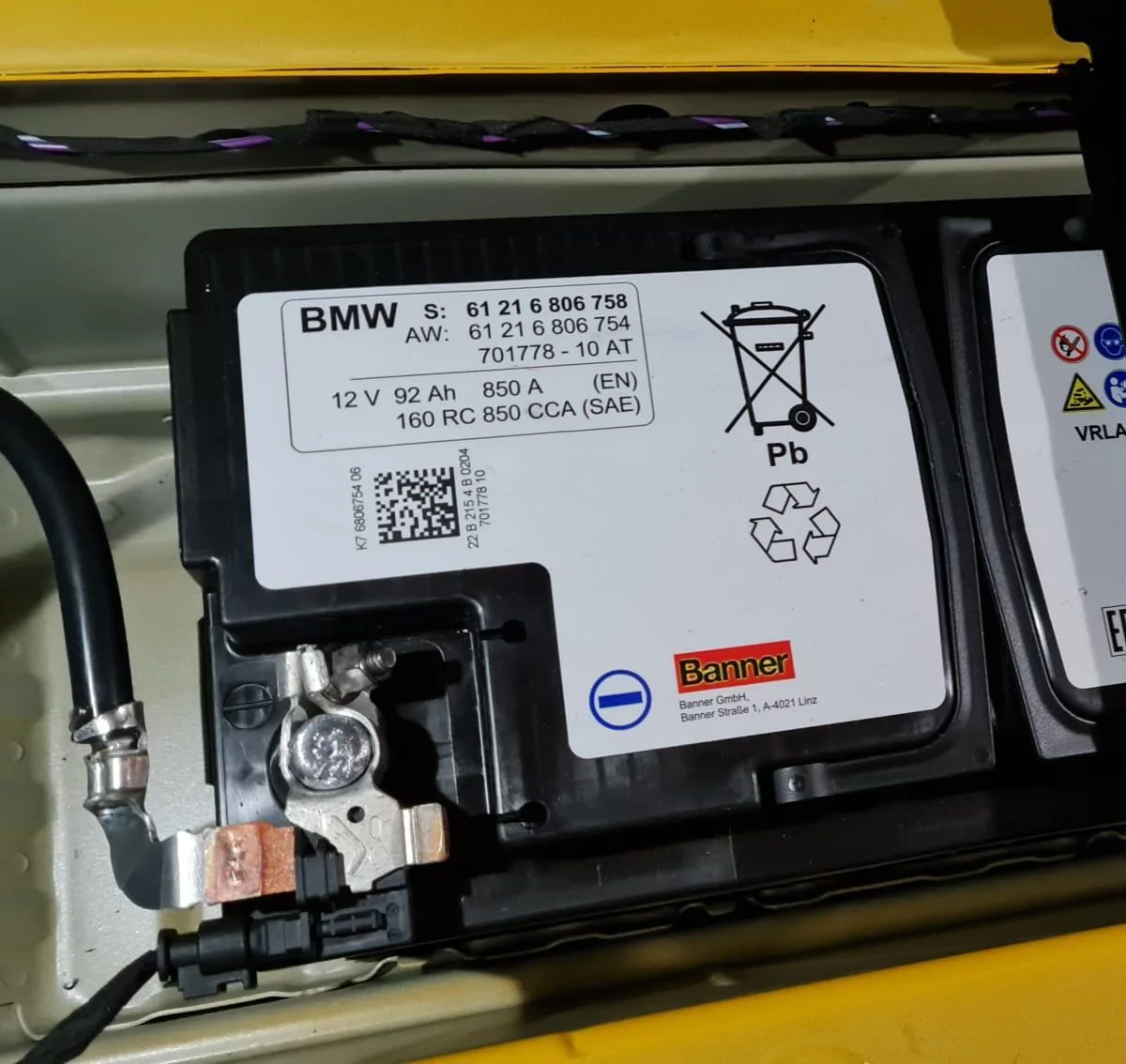

Hi Guys can someone help please, I'm looking to buy a CTEK MXS 5.0, but, just wanted to double check as I saw lots of photos on here with their battery's saying AGM, but my battery looks a bit different, it has lower Ampere, and also I can't see the AGM writing on it. So now I am not sure what Mode I need the CTEK on, would it be normal car, or AGM? And like, what happens if I get it wrong?
Dealer isn't answering, and I read whole owners manual and zero mention of this stuff. Is anyone able to share official instructions?
This is a '23 MT UK spec 335bhp 3.0 (not pro).
Thanks
EDIT: I JUST noticed on the right side of the battery it says "VRLA / AGM" ---> is it safe to assume this means it's an AGM and I should use AGM mode on CTEK?
badwolfe
Sep 11, 2022
172
119
NC
2021 A91, 2021 Jeep Gladiator
Yes. You have an AMG type battery and you should be good with the AMG mode on the CTEK. I don't have the manual in front of me but I think I read that it would auto detect but can't be sure about that part. Cheers on the new MT!
