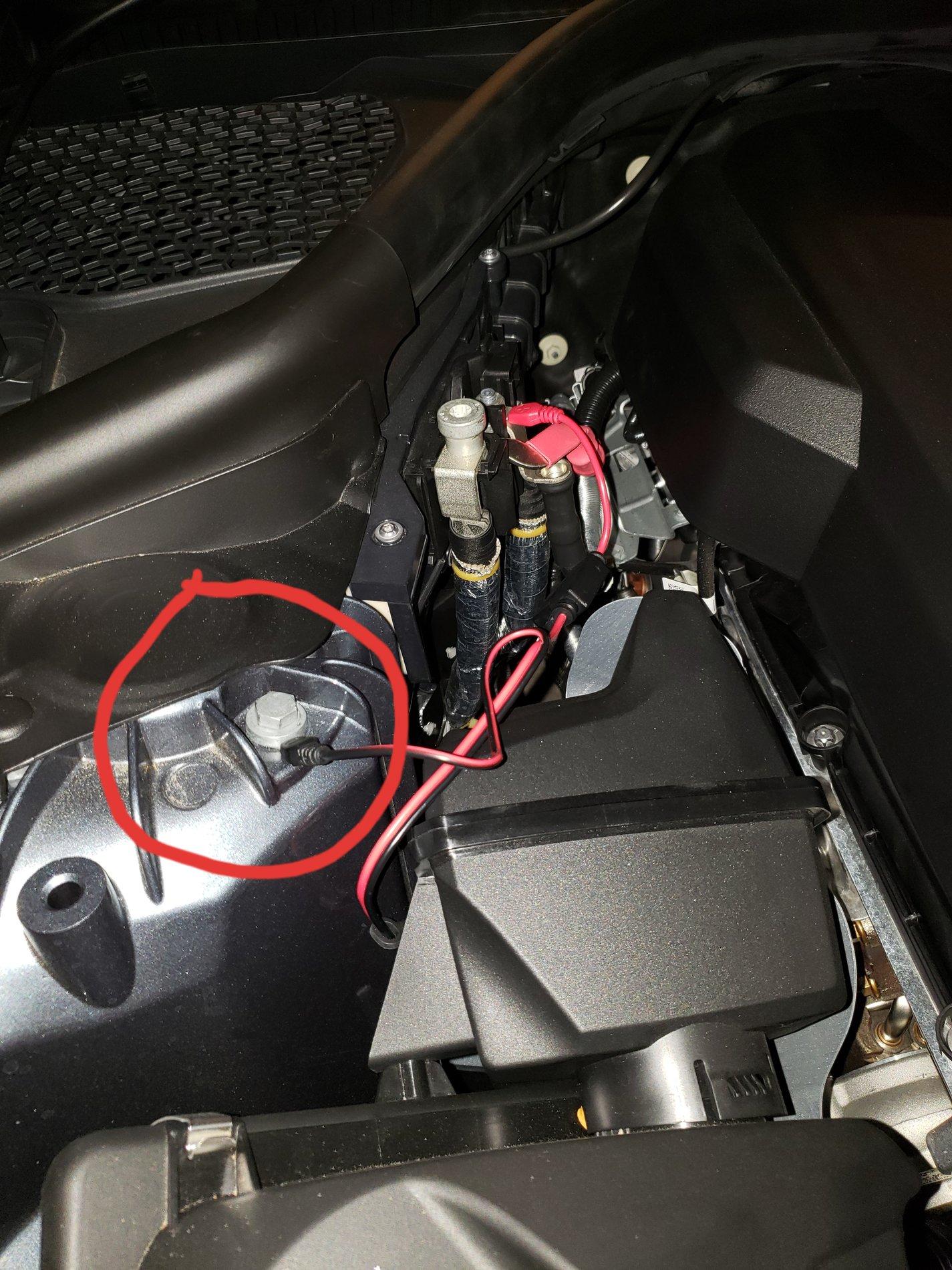

I used the bolt circled in red for ground so that the hood can be closed completely with the charger connected.
@ zamiel - let us know how the charger is working for you when using that bolt for the negative (ground) connection. I tried jumping my car (yes already had a dead battery issue) between the red terminal and that bolt and it didn't work. When I used the lug on the fender as ground connection, everything fires up right away.
Did you get a “replace battery “ light ? After charging did the light turn off ?

@wesa - nope. There was no warning. The battery was defected. Check out this thread.

I use that bolt for ground. Works fine for me. I suppose one can take a voltmeter (just set it to volt) and probe between a known good ground and that post. If they get '0' volts, then you know it's good.
I've had no issues so far using those points to maintain the battery over the winter.

I used my DMM (digital multi meter) and checked the impedance between the fender lug and the bolt on the frame. They is very little resistance between them (less than 1 ohm). SO they are practically electrically equivalent. Good enough for charger but not for jump starting because of the amount of current required to turn over the engine (I guess).
