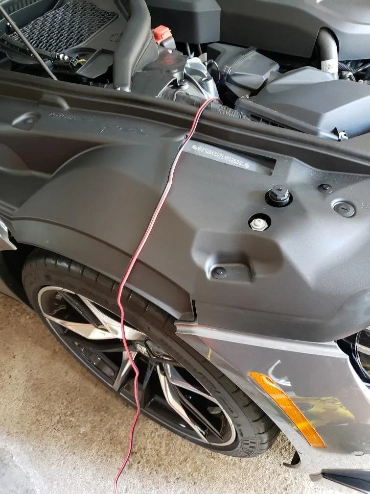

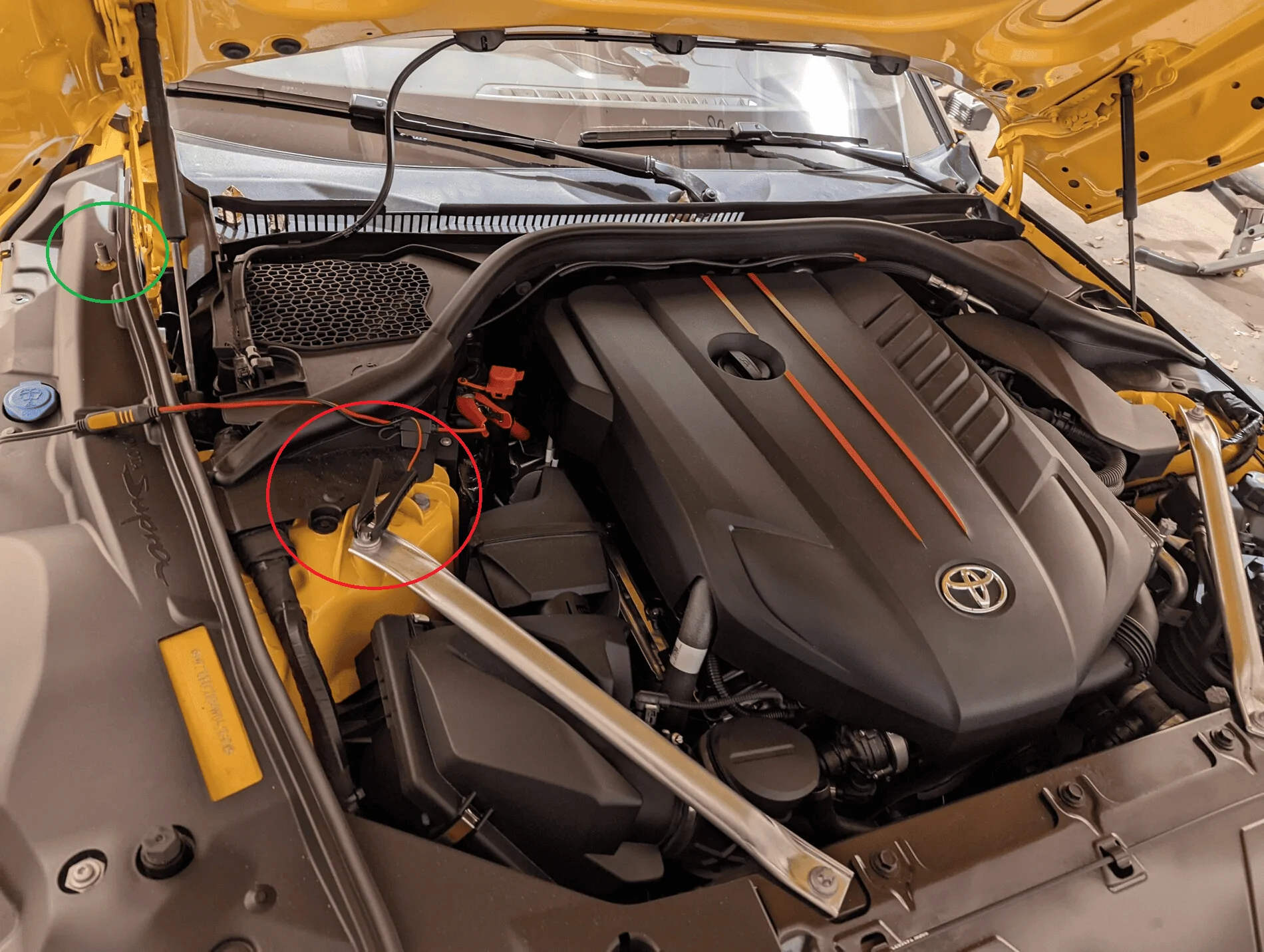

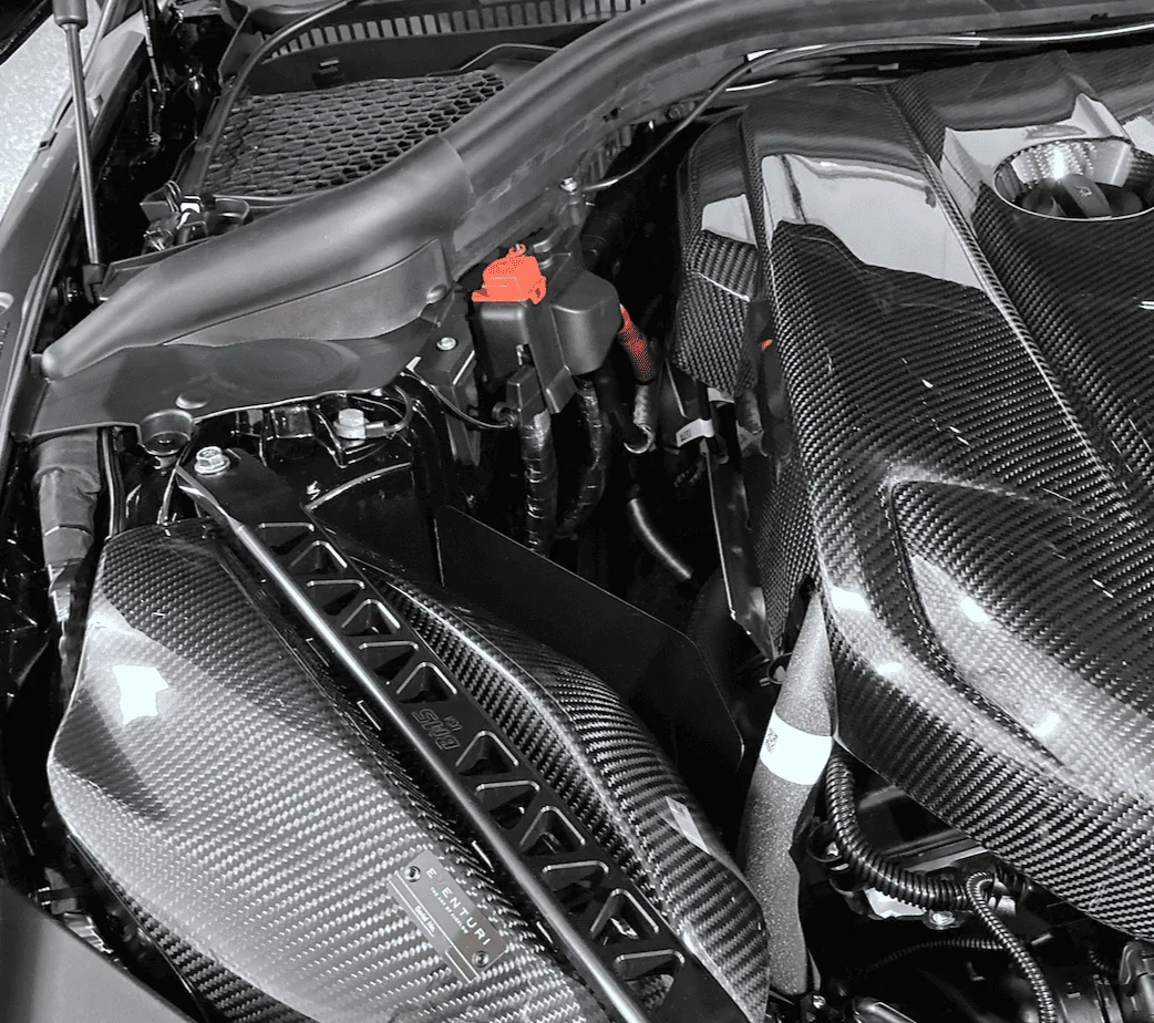

I use that bolt for ground. Works fine for me. I suppose one can take a voltmeter (just set it to volt) and probe between a known good ground and that post. If they get '0' volts, then you know it's good.
The first thing I do after buying a new car is to charge the battery until it floats.
so you don't have to remove the battery terminals from the battery to charge
Where is the battery located and is it safe to charge the battery while it is still in the car and attached to the terminals? NO damage to any other electrical components in the car while the battery is still connected to the terminals and in the car?
I heard that if you remove the battery to charge it on some BMW models you will get a CEL next time car is started and has to be reset?

Yes, from reading online here you need the dealer to reset your battery if a new one is installed.
The battery is located in the boot and is under a cover. It is an AGM type battery.
Best points to recharge from are from up front at the terminals as shown by @zamiel
My question to zamiel is did you remove the bolt and place the o-ring terminal under the positive bolt? I gather this is a permanent fixture; how do you store the terminal with electric tape?

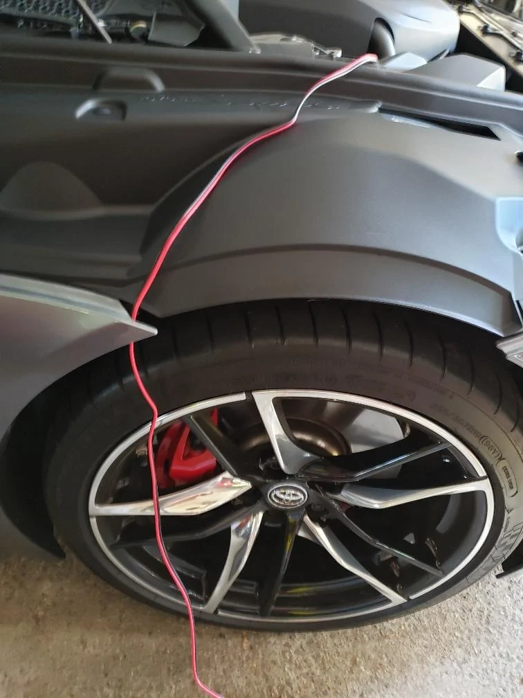

Hey guys

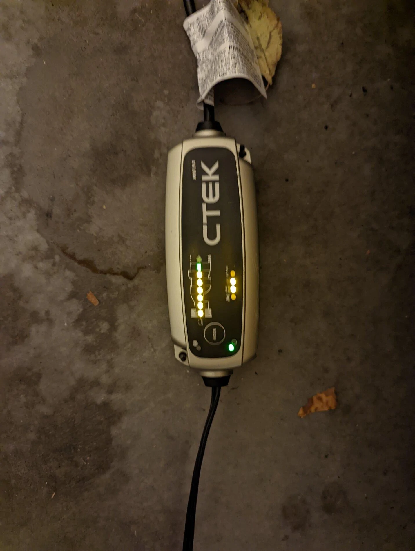

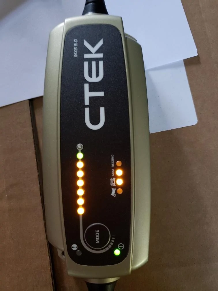

I'm new to this winter storage thing. My car is plugged in to a CTEK MXS 5.0
Ground cable is too short to reach Supra's ground connector so I improvised with this chassis bolt on the body (see image)
CTEK:
* Green light (no flickering)
* Set to car and AGM
* Car is locked with no lights on or devices connected
The CTEK status lights are on 4. I've been charging it for hours and nothing has changed. Shouldn't it go to higher number eventually? (Worried my ground connection is wrong)

Should be fine; it takes quite awhile to get to the last light. It also gets quite warm, so don't worry about that either.

I would separate the ground cable a little further from the positive cable. It looks like you have room to do so all the way to orange junction section. It should reach then.

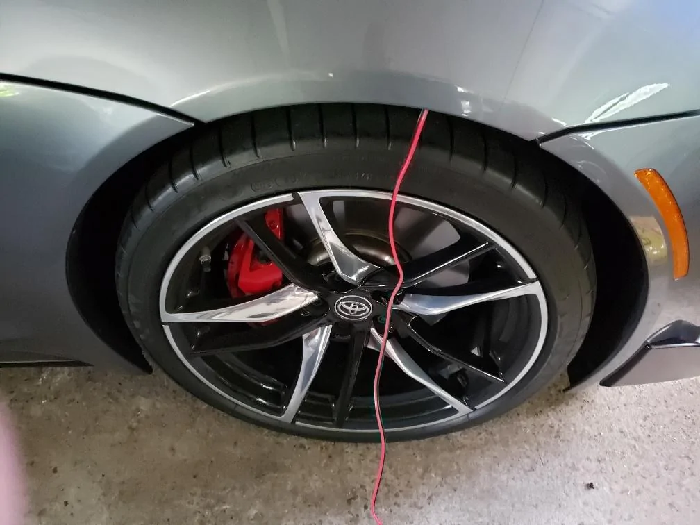

Hey @Loco38SUP yeah it looks like the red and black parts of the cable will part at the orange junction cable but (difficult to see in pic) it actually only splits at the top 40% the length of the connector.
If you imagine a typical car battery with negative on one side and positive on the other, it is that exact width apart.
The Supra distance between positive and the ground ports are probably about 2 car batteries wide. I didn't have much luck finding a wider proprietary cable from CTEK to solve the problem.
Ha my dad gave me some jump leads and said clamp them to the CTEK connectors as an extension but I didn't fancy another DIY variable on my first go doing this.

yep... I have a CTEK and thought I couldn’t split it any longer. Should be able to separate them and get the negative clamp over to the correct terminal

Your negative port is on the fender you have it connected to the brace ...?

I am setting up my charger, the CTEK 5.0
I know select car and select AMG
but what option do we select “7” or… does the charger itself just work it’s way across the numbers?
