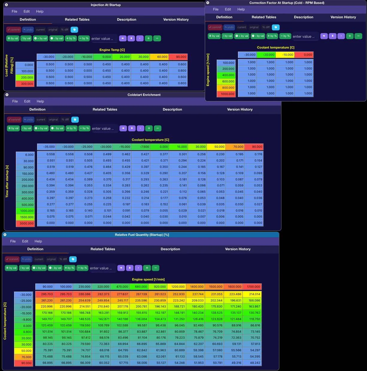

@razorlab says cold start fueling tables could use work. Others say it's normal because of the E. Trying to see if it's something I need to address/something I can do to fix it.

Not normal, but you know, I can keep saying this until lazy ass tuners do shit. Honestly, it's two tables and done...
Would you mind posting a screenshot or a detailed post of what the tuners need to be looking at?
I have always seen with many ethanol cars in the past that cold starts have always not been as quick as "regular" cold gas, so I just assumed it was inherent. Its good to know that it can be modified out :)
