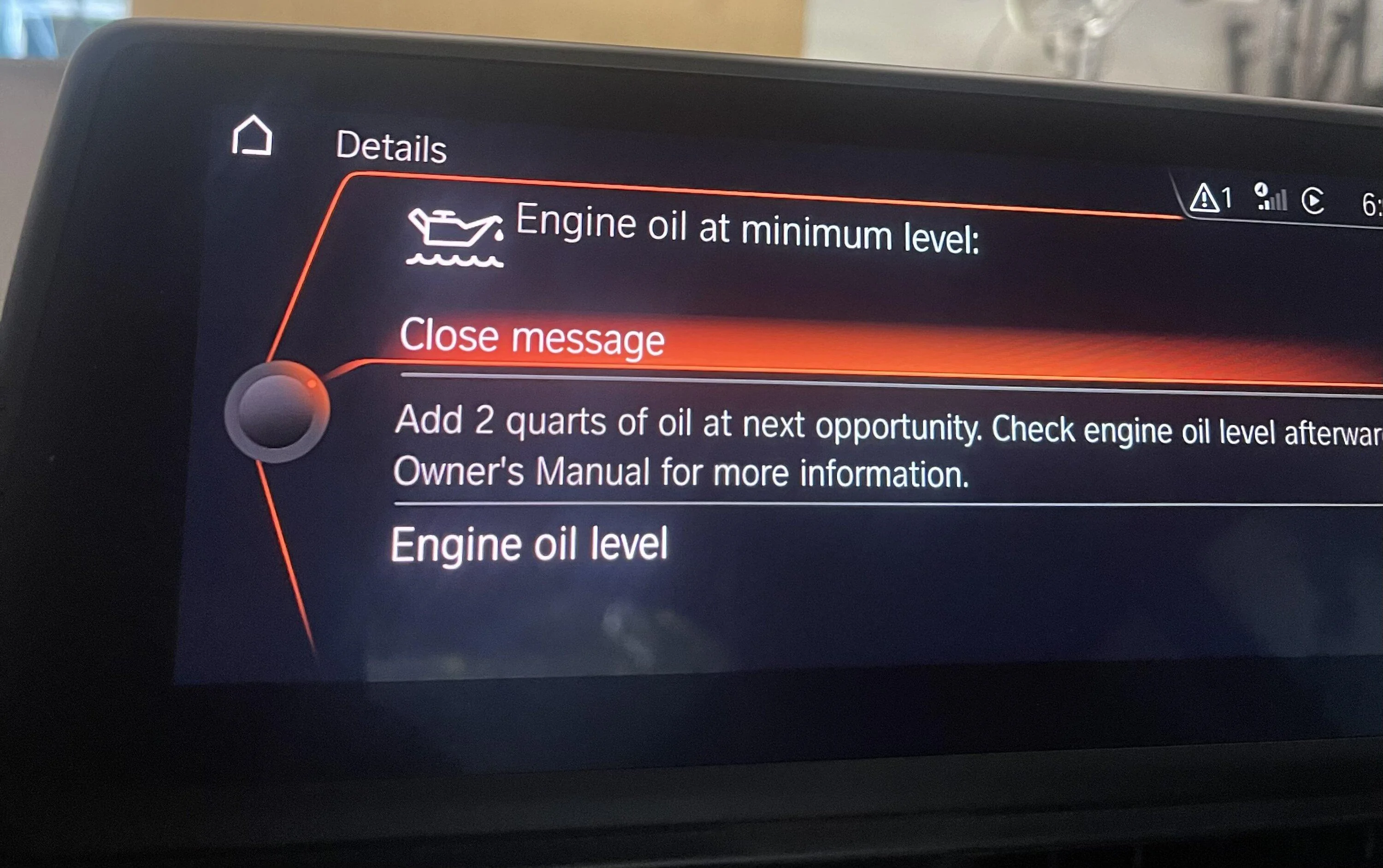

UPDATE: Looks like my oil pump is failing according to Toyota. Coincidentally I got a low oil light saying to add 2 quarts after driving for 1300miles right before I brought it in.
Toyota is saying that they might need to replace the oil pump before they can complete the oil consumption test. Hopefully this doesn't mean I have to redo the test...
Would this be the error message you received?
