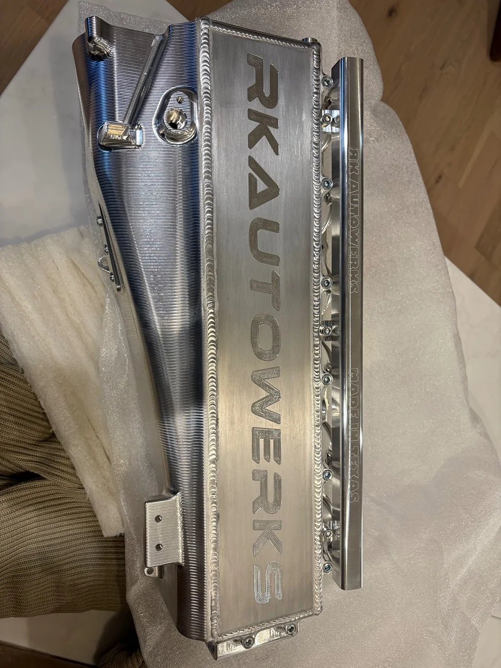

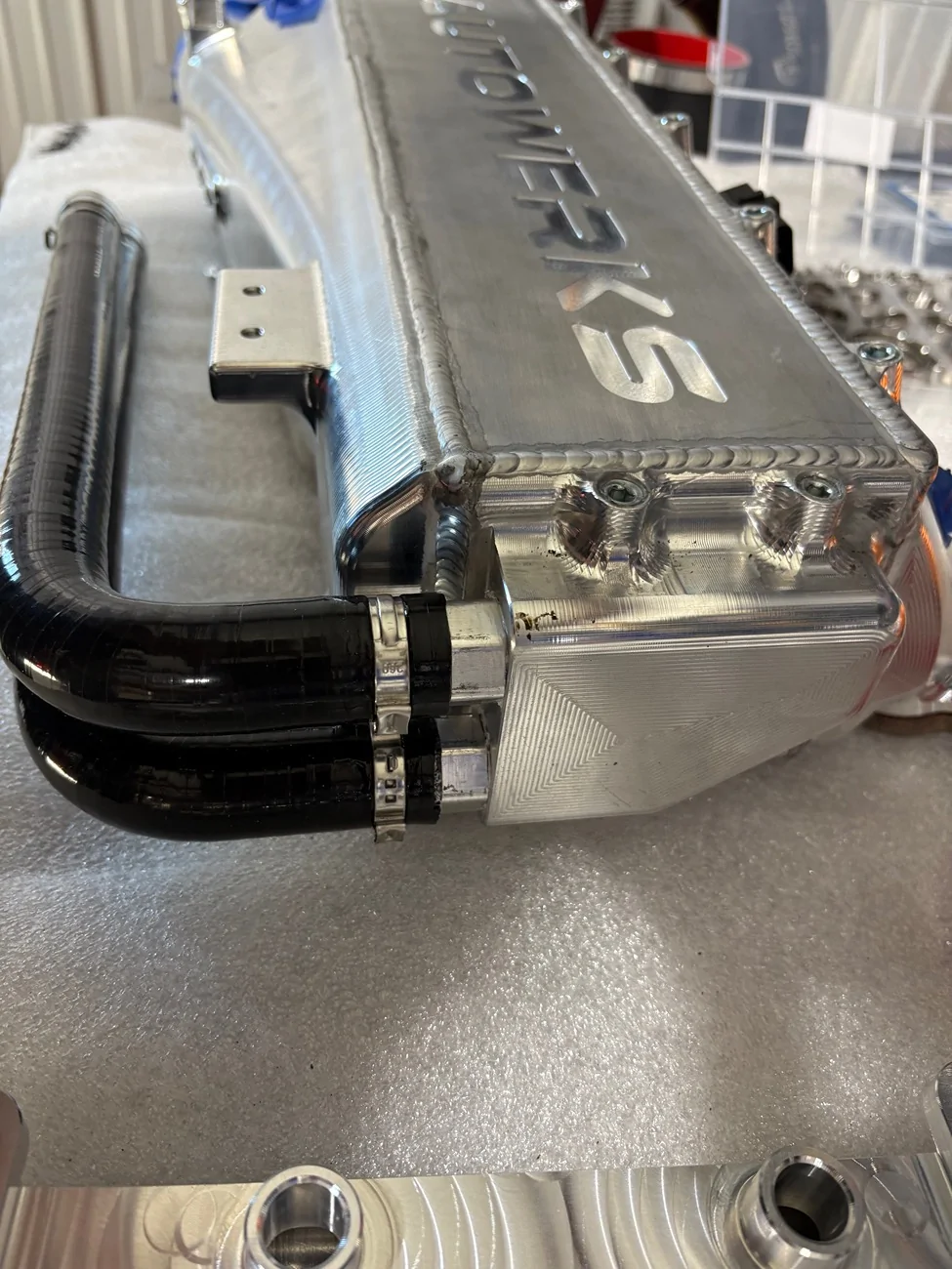

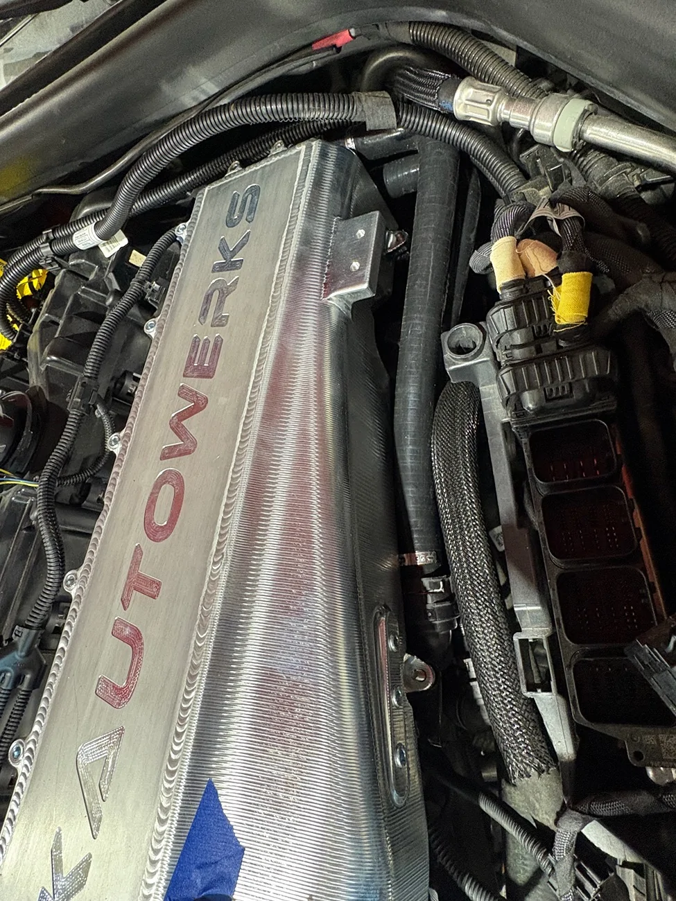

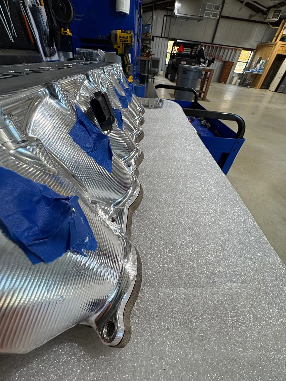

I have a brand new, looks like V2, RK Autowerks intake manifold I’m installing. Pics are attached as this one looks different than ones on website, and box says V2. Not sure exactly what they changed

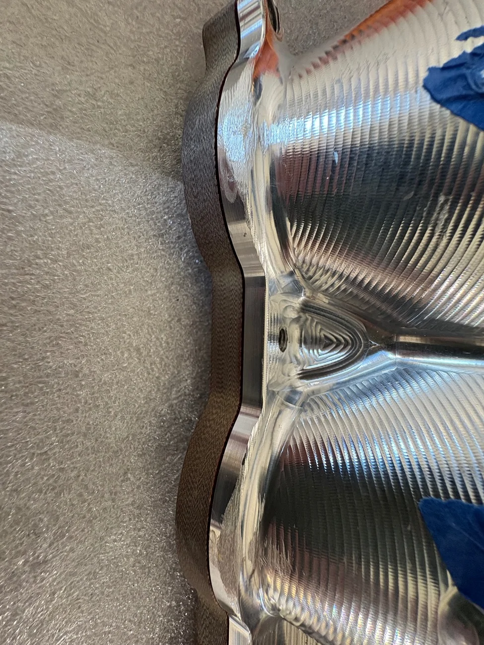

In any case, the manifold doesn’t seem to fit quite right. With the phenolic spacer, it seems to make the flange of the manifold sit too tall to fit under the bosses on the cyclinder head. I’ve read where folks with other manifolds have had a similar issue, and sort of “wedged” it under but I have not had luck with that approach. Further, it doesn’t seem the manifold lines up well either the rear brackets. In fact, it looks like I am going to have to cut about 1/4” off the rear bracket to get the manifold to sit flush. This is a separate issue to the phenolic spacer, as even without the space I will have to cut the rear bracket as it is essentially too wide for the receiving tab on the manifold.
It looks like I am just going to have to call them and see if I can get my money back. There is no way I would have spent 3000$ on this manifold if I knew I would have had to do this much work to get it to fit.
Anyone use this RK Autowerks intake manifold and run into similar problem? I’m away from the shop at the moment but will post pics likely tomorrow.

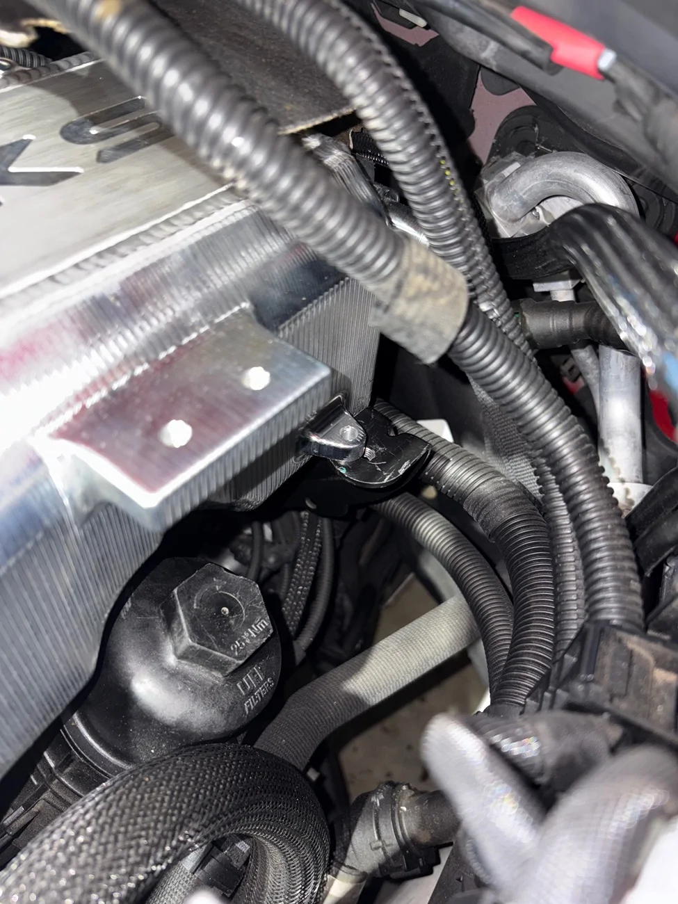

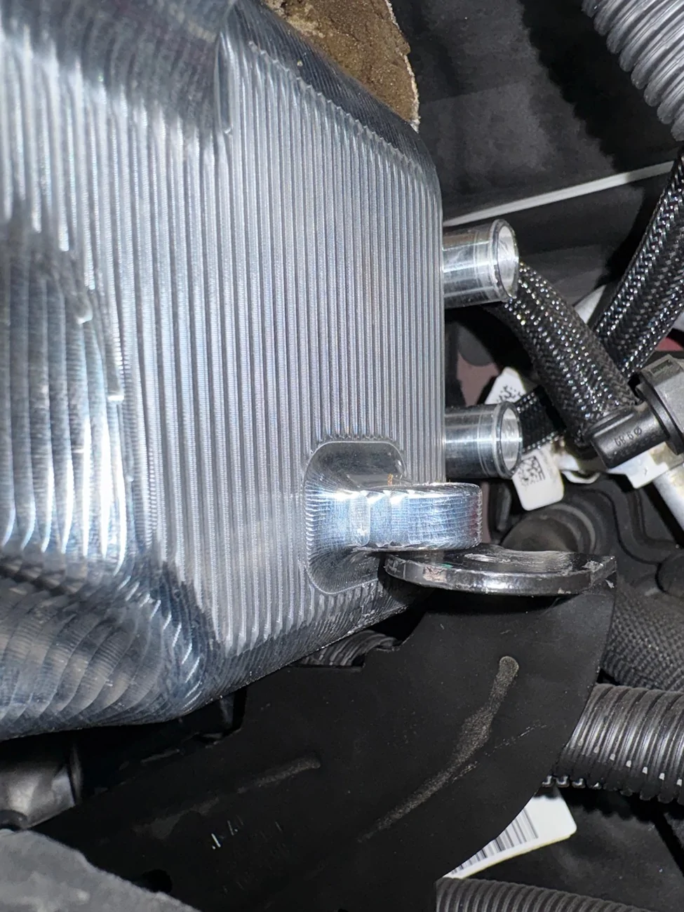

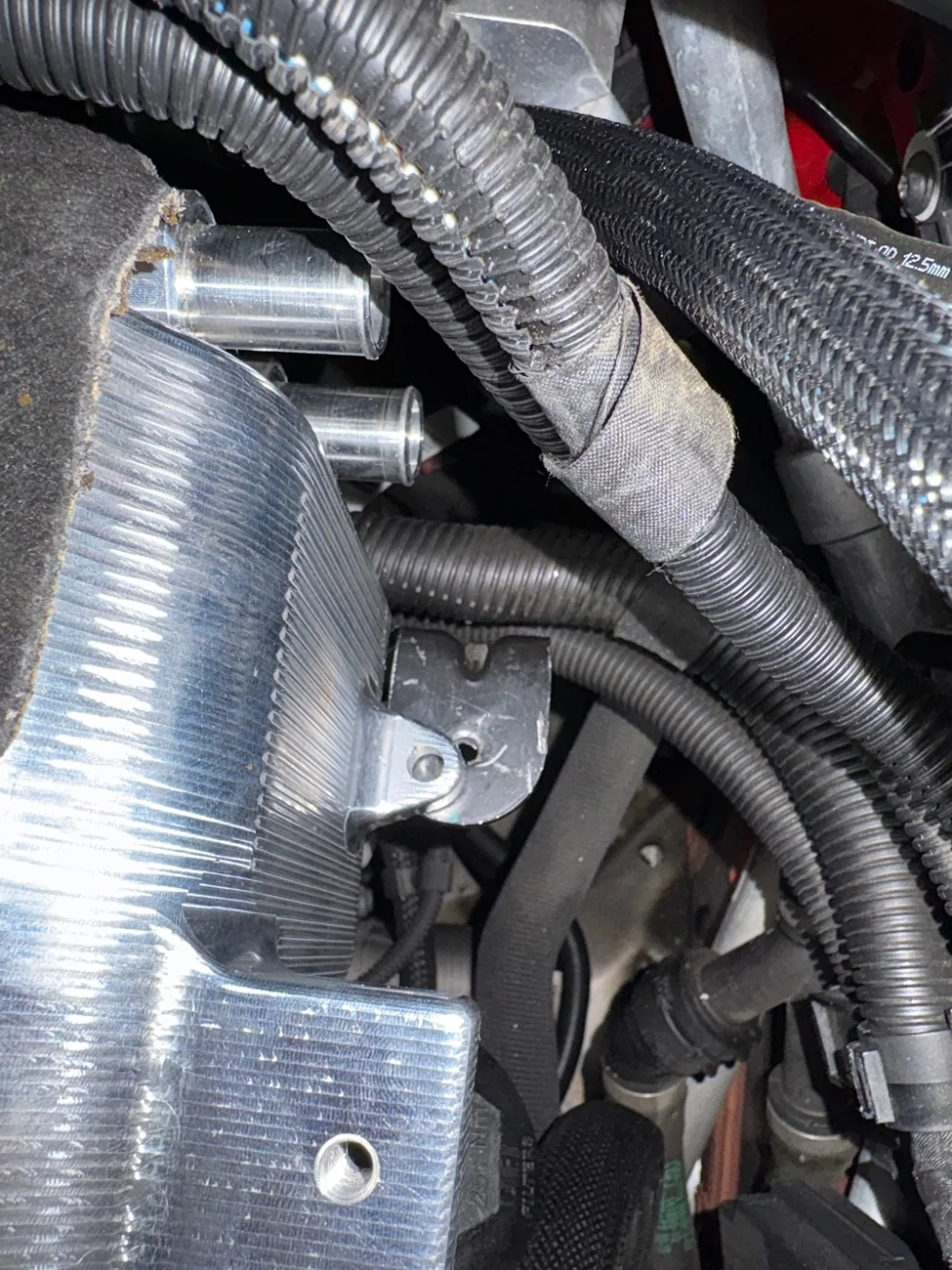

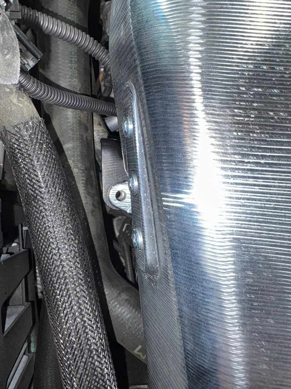

Attached are photos with NO phenolic spacer on, and the bolt holes for the top of the manifold line up perfectly, but as you can see below the rear support bracket has zero chance of lining up. First pic is the front support bracket, last three are the rear.

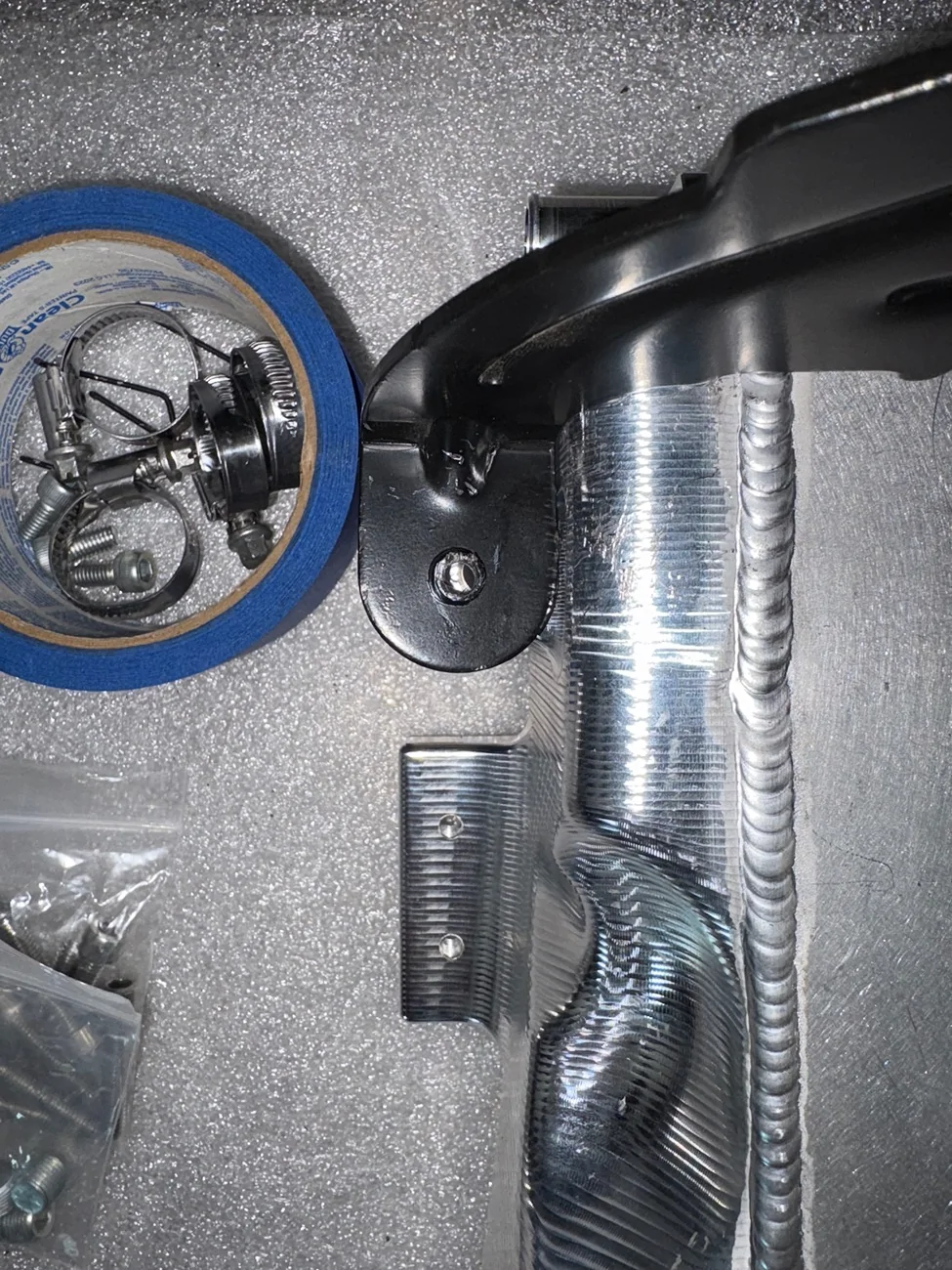

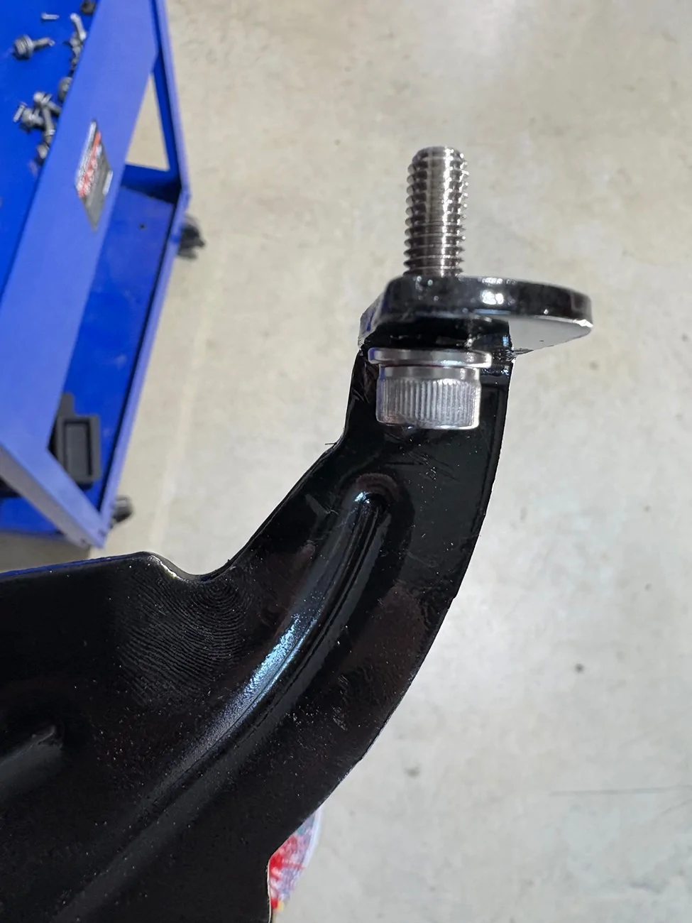

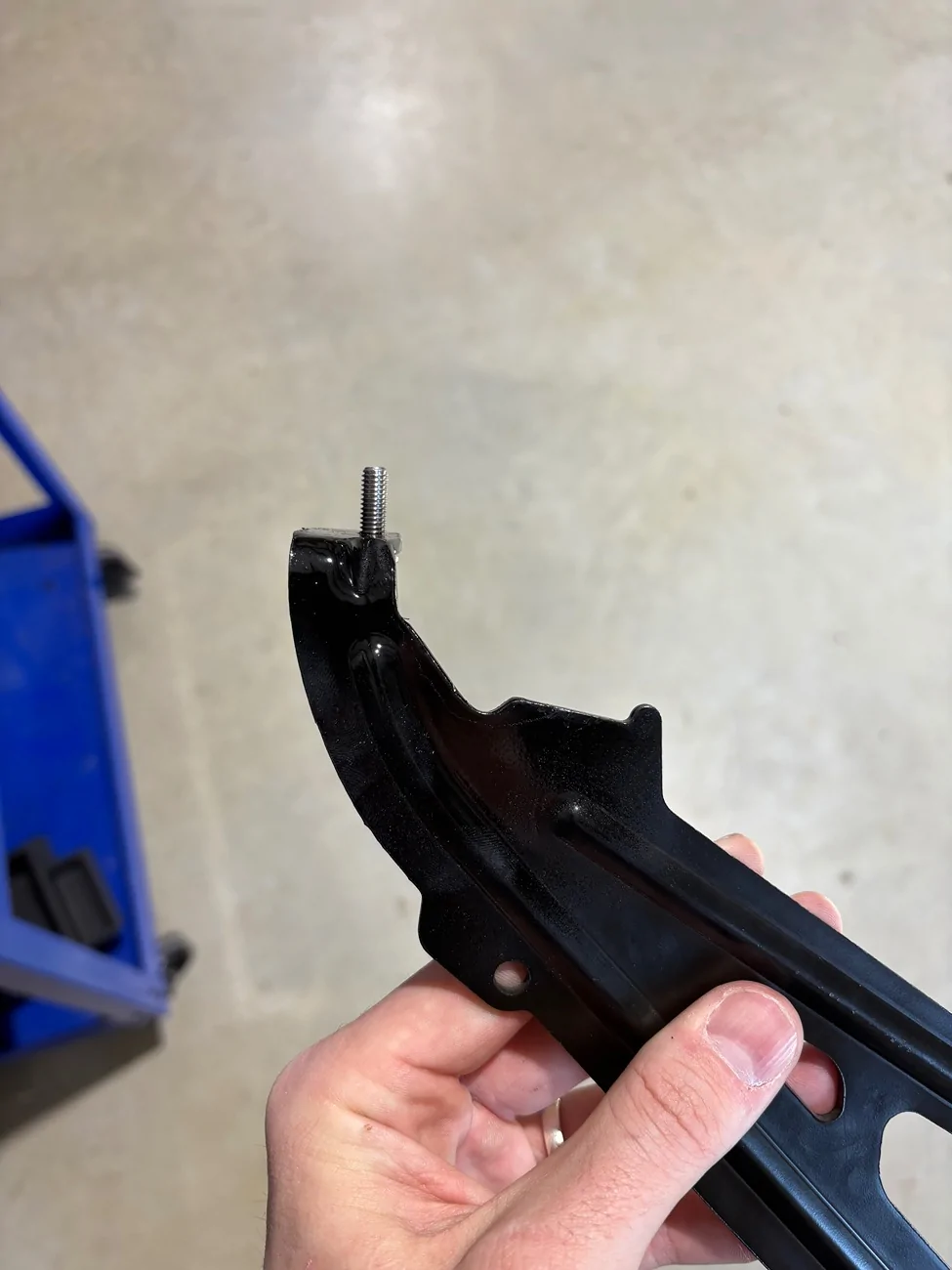

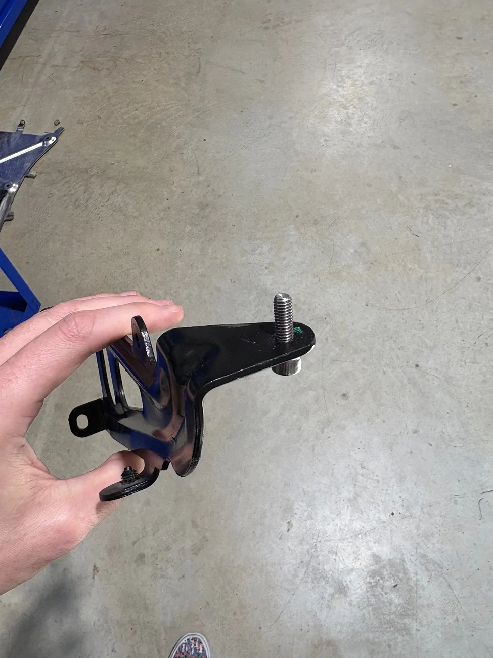

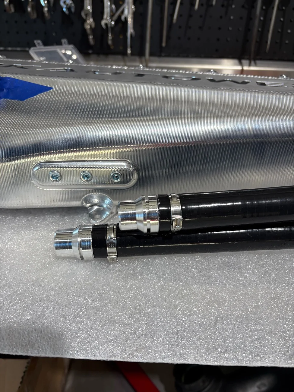

Here is another pic, bracket removed and out of the car. Unless there is a spacer that is supposed to go with this, it’s not going to fit without cutting this bracket. I find that inexcusable for a 3000$ manifold.
I’ve emailed them…. maybe extra parts were left out of my shipment or I’m doing something wrong.

The reply from RK is “you’re supposed to remove the rear bracket, it is not used on your vehicle.”
Seems easy enough, but also seems like maybe a “solve problem quickly, make customer happy, move on” answer. It will definitely fit without the bracket, after some grinding on the manifold, but I hope that bracket doesn’t really do anything functionally. I’m going to cut it and see if it can still be used.

The manifold should be fine with only the front mount connected. If it was me, I'd zip tie the rear one to that rear mount.

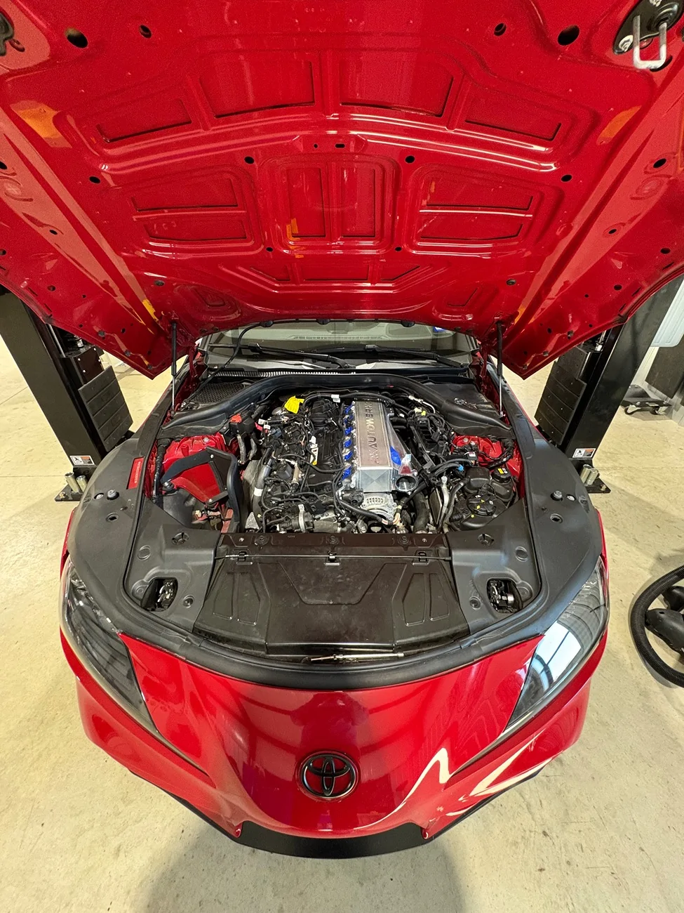

Well, it’s in there. I did have to ditch both the front and rear bracket and clearance the manifold slightly on the back runner flanges.
According to RK, this is common… customer service leaves a lot to be desired.

So does it matter which of the coolant hoses on the back of the manifold connect to which of the others? Not sure if there is a check valve or something in the manifold.
As you might imagine, this thing did not come with any instructions.
Hot saws
Cade
Jun 1, 2023
32
Dallas, TX
For future reference, it does matter, and the outlet from water pump goes to top line on back of manifold.

We spent a little time getting fitment perfect. We ground some clearance on the flange portion of the intake manifold which helped a lot.
We also had to cut the rear bracket to make room for the manifold.
Also ran the bolts up through the bottom with some locktite/lockwashers to make some studs which made it easier to get everything to fit right.
