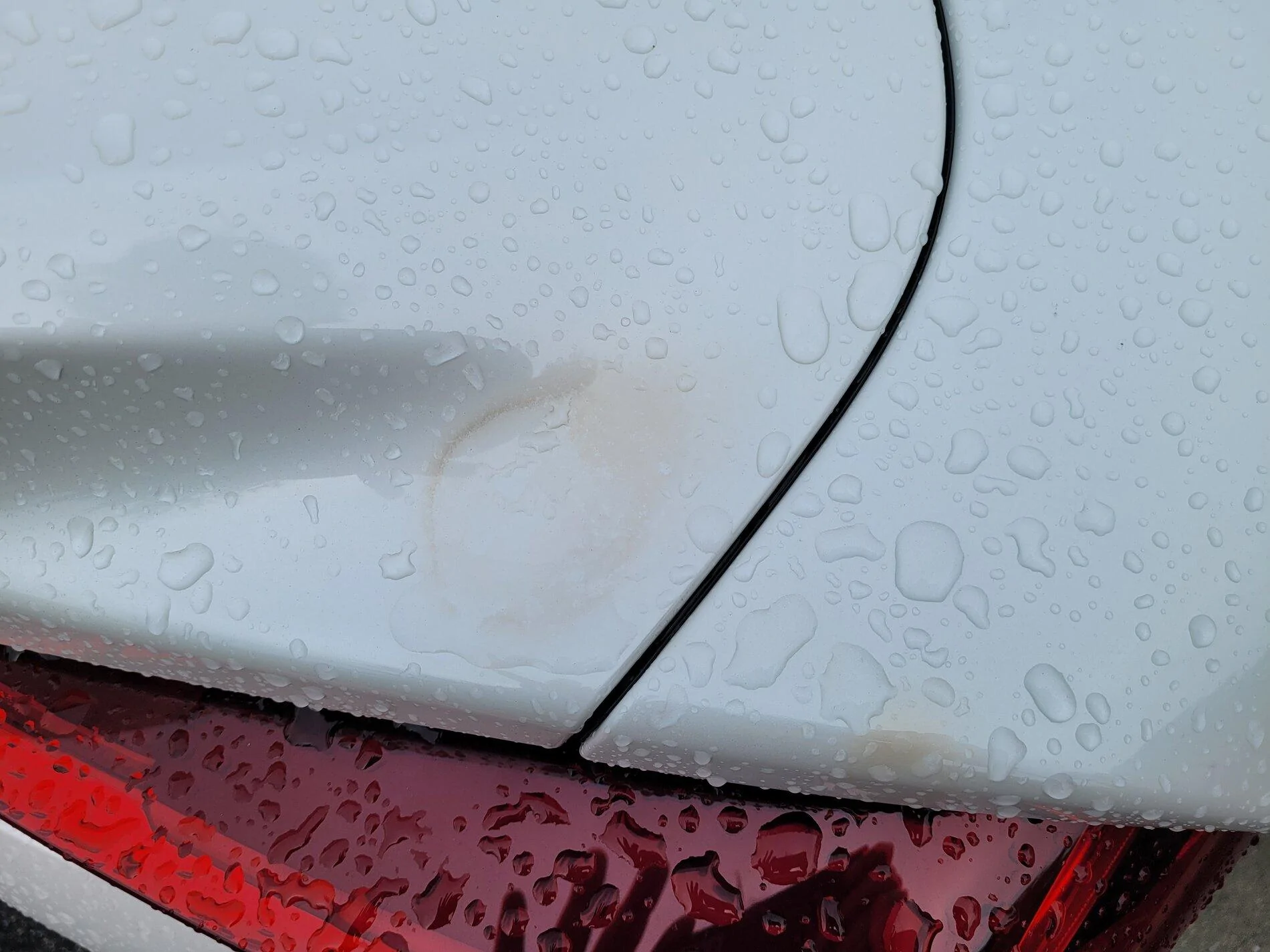

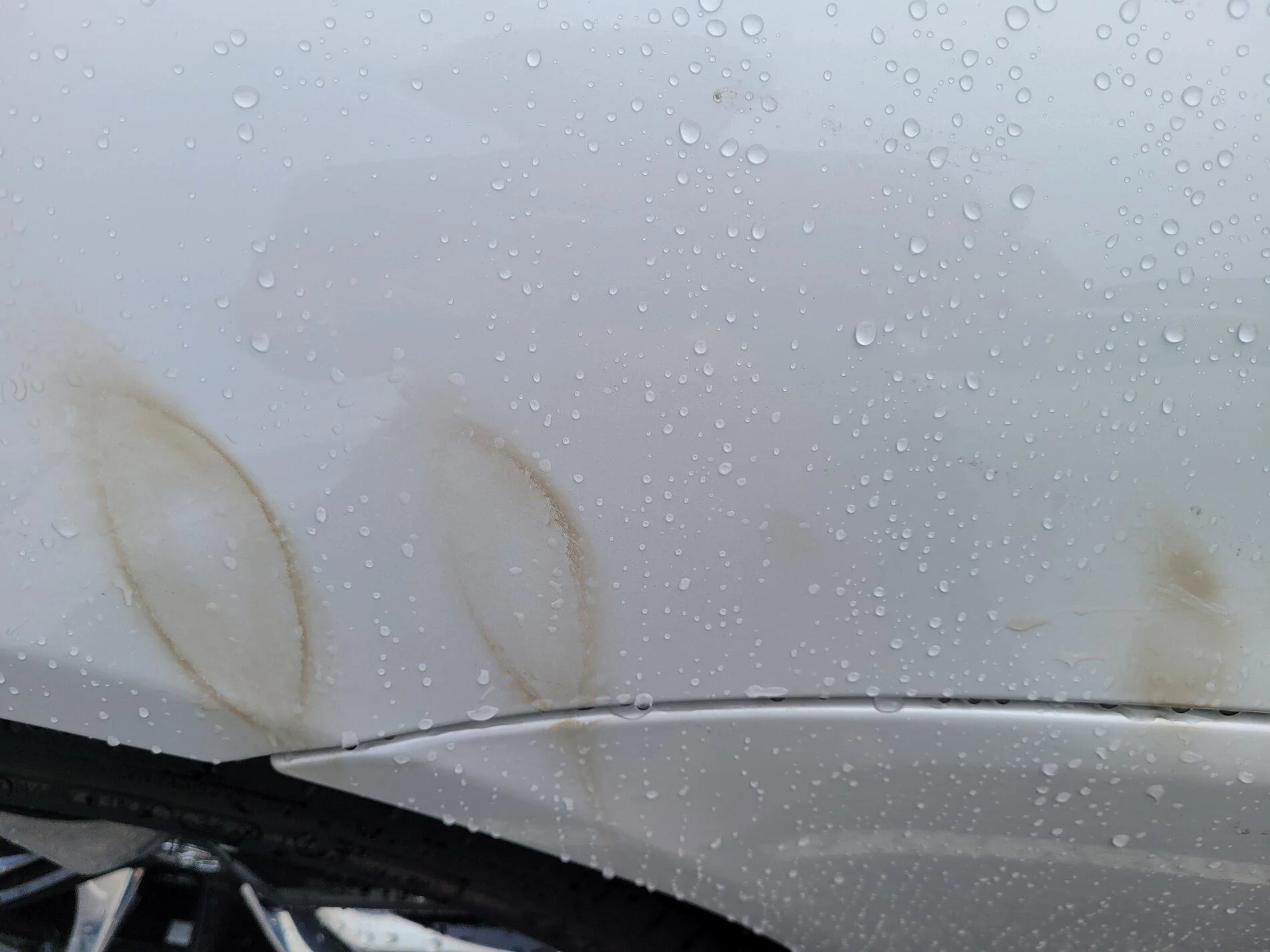

Okay. I already cleaned the part with some q-tips with a dab of vinegar and here is the result (see attachment).
most of you guys said that the part is not made of metal. If this is a rust stain, would it be possible that the brackets/bolts are the one that is rusting?
That almost looks like dried cosmoline?

Just an update.
Mar 27 (Sat) - I brought the vehicle to the dealership, showed them the problem, Shop Foreman says that they need to inform the corporate in regards to the issue. They cannot do anything without a go signal from them since there is no TSB nor a recall.
Mar 29 (today) 11am - I received a call from them stating that the corporate just wants them to clean up the rust :rofl: and return the vehicle to me. then if it comes back, I just need to bring it back so they can do the 2nd step (I dont know what is the second step).
3:20pm - They got back to me and I thought they will tell me to pickup the vehicle but instead, they said that they are going back and forth with the corporate. They tried to clean it but they said that I already took out most of the rust (stains?) :rolleyes:.

OP, did you buy the car brand new? Did you take delivery at the dealer or did you have the car transported by any chance?
In the picture after cleaning it looks like something corrosive was dripped onto the area. Like maybe a corrosive solvent. The white paint looks like it was attacked and dissolved by something corrosive. The small area of paint looks partially dissolved by paint stripper. Or maybe brake fluid. Brake fluid will dissolve paint.
How are Supra's transported to the dealers? Are they wrapped? Are they loaded on traditional double level automobile transport trucks? I wonder if the car was on the bottom level of a transport truck and the top car over it dripped some break fluid? Maybe brake fluid dripped onto the glass and ran down into that channel/edge?
I did buy the car brand new back in Jan 2020. The car was already at the dealership when I bought it. I remember that it has those plastic wrap on the wheels and plastic wraps inside the car. It was not transported from another dealer. I drove the car home.
Bring the car to a qualified body shop for their opinion. Have them write up a statement of what they think it is.

I had somewhat similar stains on my car when it arrived at the dealership before I took delivery. Not in the same spot but I dont doubt it could have been. It looked like rust had dripped down on my car and settled into the paint in big drips. I asked about it and they told me it happens at the port. Mine looked very mild compared to how dark yours was. My theory would be something similar happened at some point.
diablo2112
Nov 24, 2020
176
297
Southwest USA
2022 BMW M3 Competition
That looks like drips from the ship itself. Any steel-built ship is a huge, floating rust machine. Requires constant repainting and maintainence, and you'll always be dealing with rust, especially as water seeps through the whole thing and drips. Just a thought.
