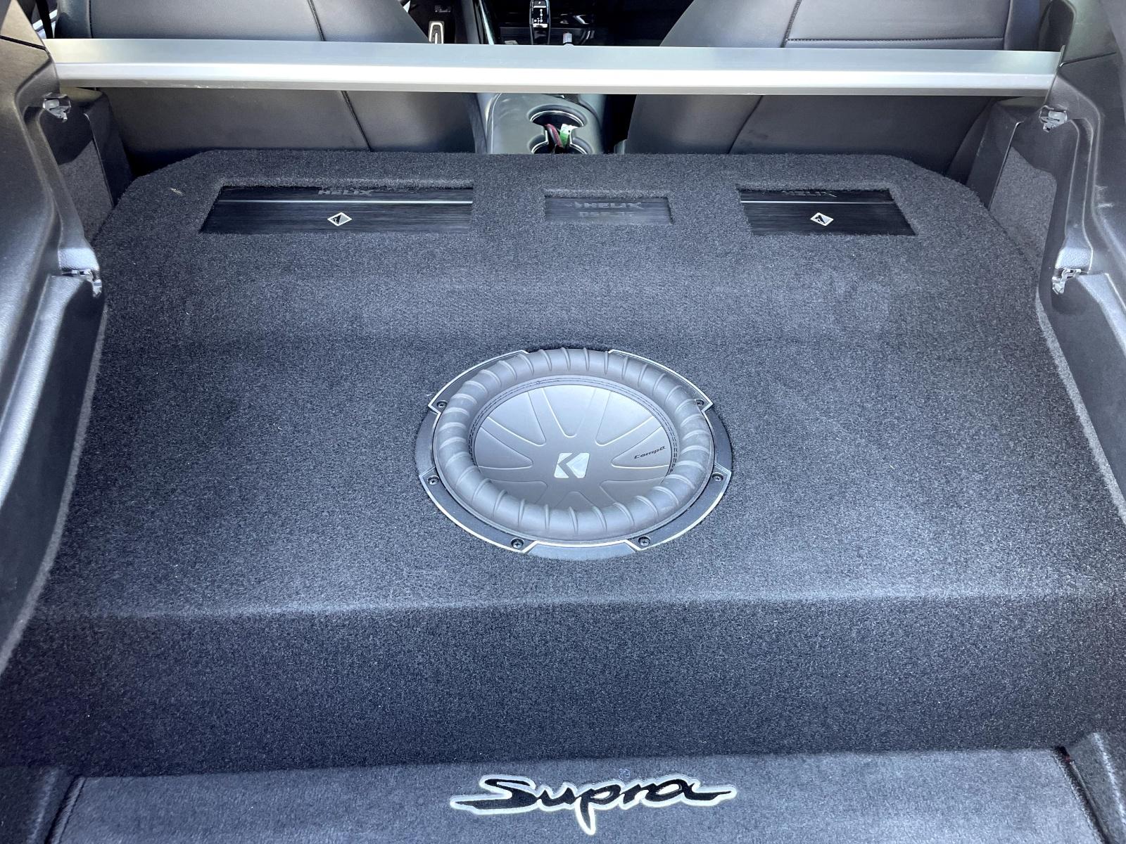

A few weeks back I had my audio setup installed in my 2021 Supra by way of Monster Customs here in Atlanta.
- Blam Signature 4' Components (Front)
- Blam Relax 4' Coaxials (Rear)
- Helix 4 Channel
- Helix Mono
- Helix DSP
- Kicker 10' Q Series Sub
During the installation something happened to the DSP which is being replaced on Tuesday. So since I've had the car back I haven't experienced the stereo with the DSP and basically everything is running from the head unit EQ. Honestly I am not super impressed right now with my sound quality. The sub is awesome but interior is sub par as I'd consider it a minor step up from stock. I have never owned a DSP. Am I going to be blown away once the DSP is hooked up? Do I potentially need to have some 6.5's installed or some 8's to get some mid bass going?

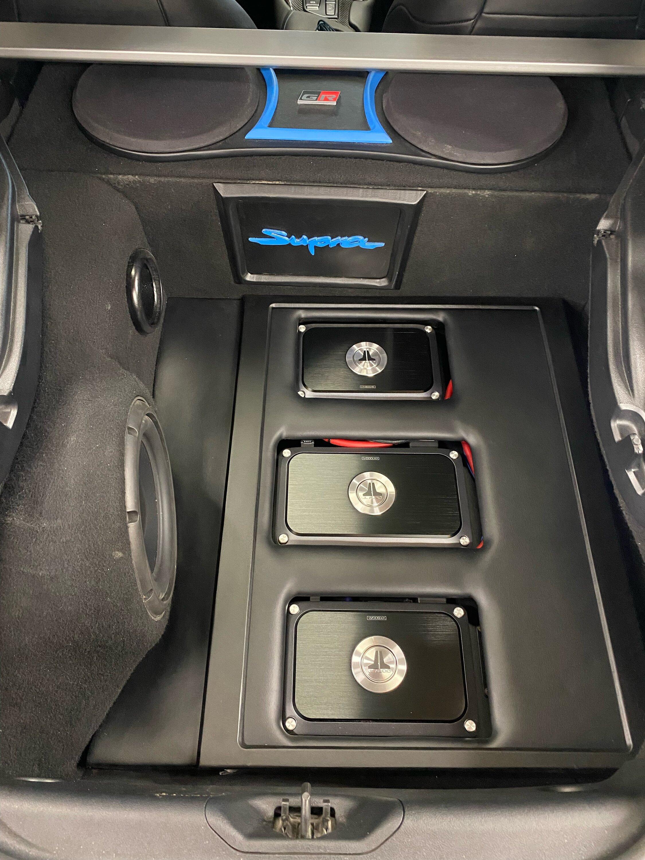

The problem is the 4” speakers your using. That’s no where near enough to bridge the frequencies from mid range to sub bass.
A few of us have had this problem.
The ultimate solution is 6.5” door pods. But expensive.
Is it possible to add 8” mid bass speakers back behind u again.

Honestly. Metal has done it best.
But I’m running all audiofrog up front. 4” and 1” components. Active.
Then 4” rear fill. AF
the difference is the Audio Development 8” mid bass. And the tuning that brings it all together.
For the sub. 10” AF GB10. Which is absolutely incredible
All through JL VXI amps.
So for you. You should throw in 8” mid bass in Rear. OR. 6.5” door pods like metal did.

I would honestly stick w 8” mid bass for rear. More cone area I believe.
But yes you can do that. You just gotta be creative w tuning to get your staging correct. I would pay for that part actually

There’s a lot of good options for 8”. Honestly the Steven audio 8” mb8 are a great speaker for a great value.
You will definitely need the tuning part because the 4” speakers up front Do Not cut it. You need the time alignment to setup your staging. Believe me. I have 2 tunes on my car. 1 seat and 2 seat.
The 1 seat tune is incredible. The 2 seat tune is more like the 90s
