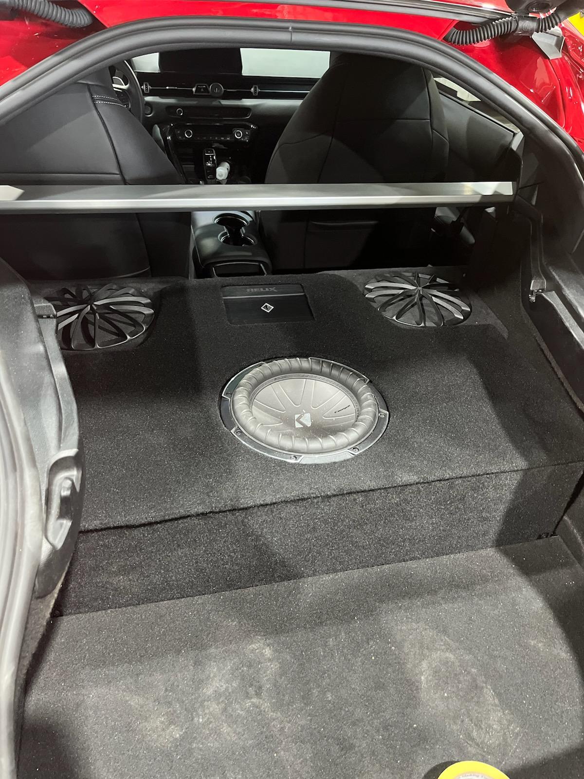

Picking up the car tomorrow at 3pm. I'll gather as much data as I can regarding the install. They sent me this pic earlier with the redo on the sub box.

So how does it sounds now to you? If you are a critical listener you should learn how to tune the DSP yourself. Also regarding the question of mid-bass, yes you absolutely need to have dedicated 6.5" or larger woofers for mid bass. The 4" are only good down to 250hz max and you DONT want your sub trying to pick up the rest.

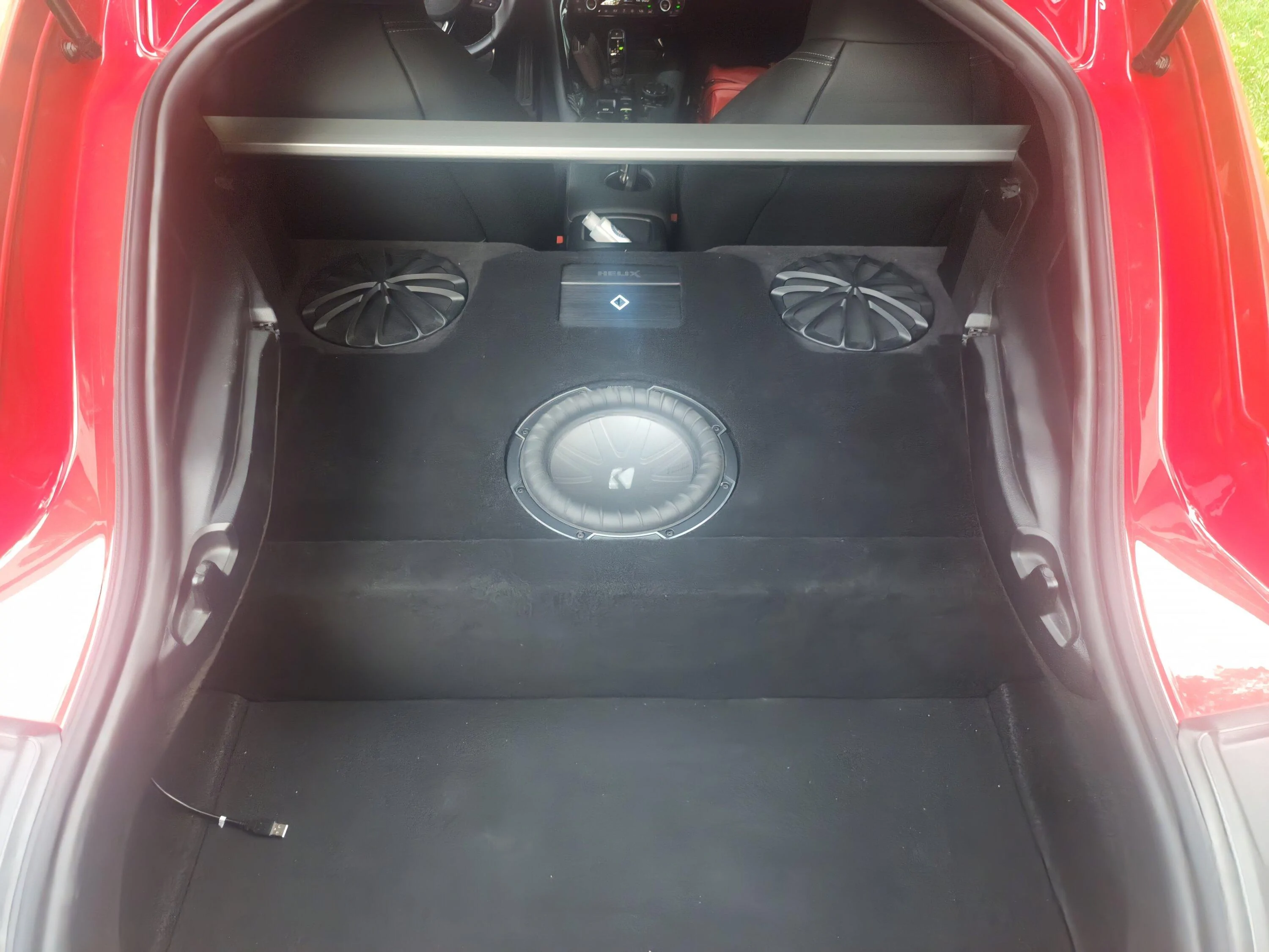

Here is an updated picture of the more "finished" box build.

Very curious to where this mid bass is coming from. Did they do anything different from your initial equipment list?
I upgraded the two rear 8inch subs to the "Match Brand" subs. However, the guys programmed the DSP allowing me to experience good mid bass from the 8 inch subs (i dont really want to call them subs anymore) and deep bass from the 10inch sub. I am getting the highs I need and the lows and they dont seem to be getting mixed up together in the music. I do know they utilized a microphone to start the tuning process. The rears have been delayed and remind me of surround sound rear speakers if that makes any sense.
Zero mid bass coming from the 4 inch speakers up front or from the back. The last system I had was in a 2003 G35 with MB Quart components up front and in the back. Those were likely 6.5 all the way around and I am truly not too far off that in terms of mid bass.

I upgraded the two rear 8inch subs to the "Match Brand" subs. However, the guys programmed the DSP allowing me to experience good mid bass from the subs and deep bass from the 10inch sub. I am getting the highs I need and the lows and they dont seem to be getting mixed up together in the music. I do know they utilized a microphone to start the tuning process. The rears have been delayed and remind me of surround sound rear speakers if that makes any sense.
That's brilliant! You found a shop that actually knows what they are doing. Adding the two 8" was smart. The surround sound you are referring to is called "rear fill" where you do a 20ms delay, bandpass filter, and R-L/L-R signals. My shop had no idea what this was so I just redid all the tuning my self. You should a get a URC.3 and have the shop assign the rear fill to one of the knobs so you can adjust your surround effect to your liking on the fly.
