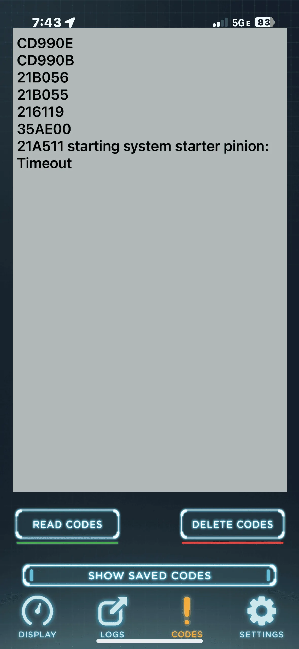

Quick troubleshooting help. Why BMW has to make stuff so difficult is beyond me but here we are. Ok new battery is installed so that part is fine. I haven’t reset the battery setting, can’t until Monday when my dongle arrives, but I can’t imagine (or I can) that would cause the starter to not function accordingly. Or maybe it can but it’s got full voltage so who knows.
It’s quite intermittent I hit the start button sometimes starts right up. Then sometimes it just clicks, then hit it again and it Starts right up. The autostart/stop will sometimes restart sometimes not. I can’t find a dedicated relay (like many cars) that controls starter function seems to be in the BDC on this car but if anyone knows that would be helpful.
Since starters cost $400 (got quotes for up to $660 fyi) for this car would suck if there was something else that might cause it. I can’t see anything but some of you guys have been deep in the Supra and might know. Since it is a 2019 build car and the starter sits next to the exhaust I guess it could be bad by now?
As always you guys are awesome appreciate any input.
I get these errors (see image)
79
8,408
13,743
216119 is a line disconnection or fault to ground on the starter motor. It'd incredibly unlikely that the motor is bad, but more so likey you have some electrical issue under the car. The starter motor is easily accessible from the bottom of the car, I'd double check the connections down there.
35AE00 is 'BDC could not start activate starter motor' this is a symptom of 216119
21A511 is 'Start system timeout' another symptom of the first two.
Definitely crawl under and peek at the ground and the harness that connects the starter motor to the rest of the car. Could be corroded, rat ate it, etc.
