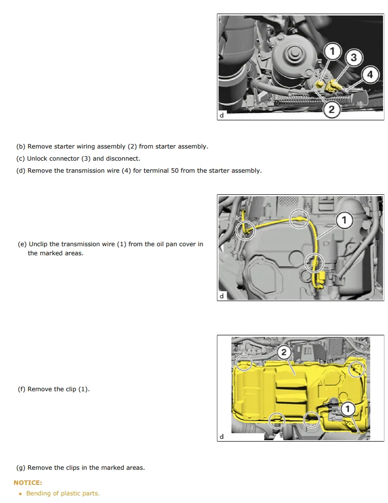

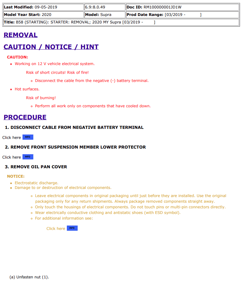

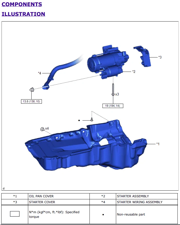

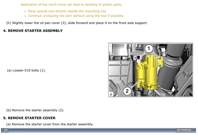

Took a look in the service manual.
Doesnt look too bad.
Part# for the starter:
28100WAA01
For reference its $400-500 USD.
Thanks for this. About to tackle it myself tonight. Wonder if that "non-reusable part" (referenced black dot in 1st image) needs to be replaced. oh well.

so i swapped out the starter. car works like a charm again. had to remove the metal shield that covered the oil plug, disconnected the two wires, removed 3 screws (E10) and swapped. had to watch some random 2020+ X5 starter motor video to really get a look at where i'm going (there aren't any supra starter tutorials that i found). bought a used starter off of ebay for 200 and did it myself. would be a super fast job the second time around.
