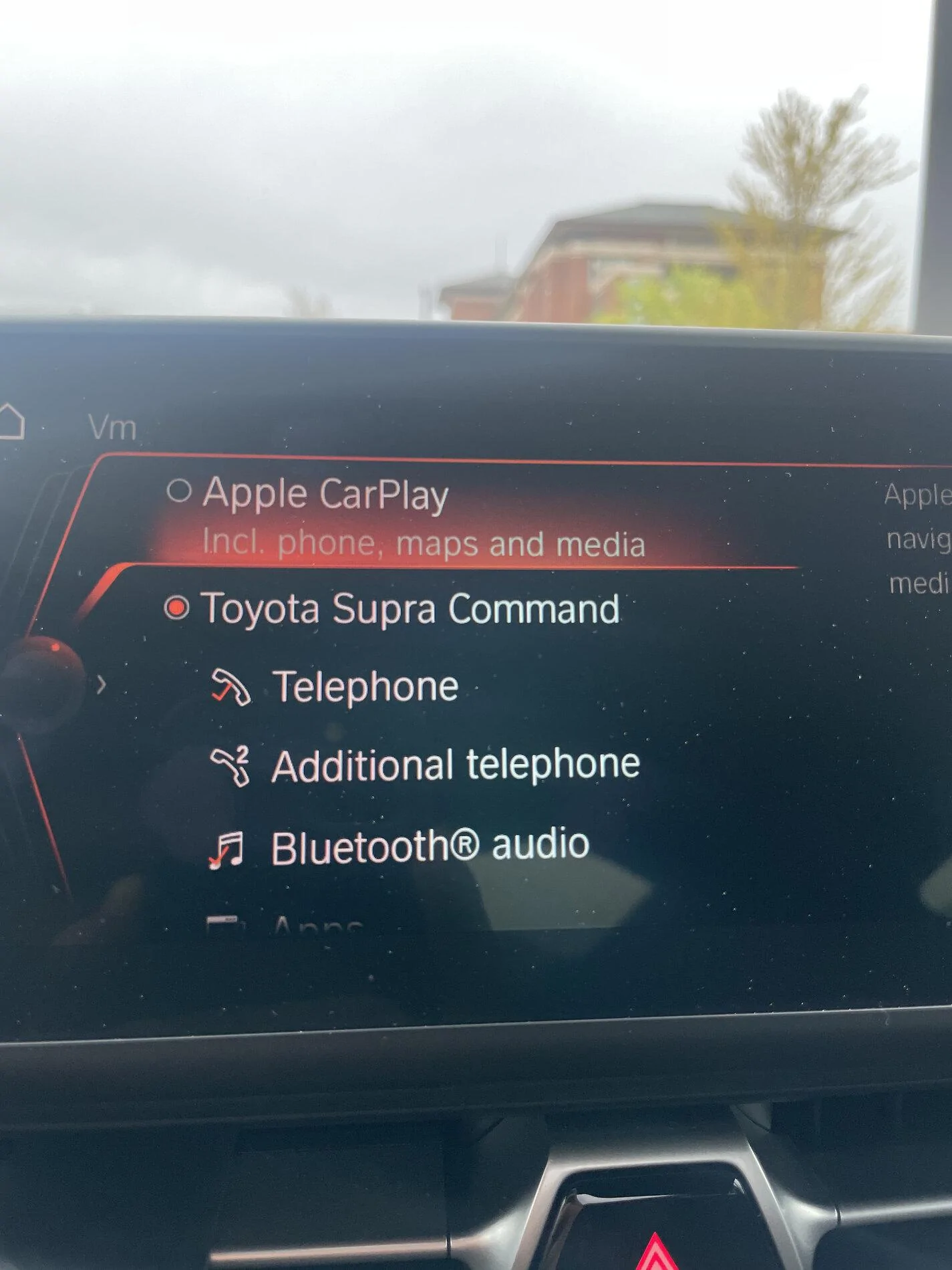

I found disabling Supra Connect made Carplay come back because my Carplay went missing yesterday when I was trying to mess with mirror link which we all know does not work with IOS.

Well, never mind. Did some looking around and found the car was set on Supra Connect rather than Carplay. Changed it back and all is good. Now, if I could just determine how the setting was changed between turning the car off last night and starting it up again this morning...

Carplay was working fine for me when I got my car, and then it stopped working. I went through the same process of deleting the device in car and forgetting device from phone and nothing worked.
This is what I did to get it to work:
1. Delete device from car, forget device from phone
2. Place phone on the wireless charge tray for the remainder of this process (do not remove during the Bluetooth steps)
3. Go to Connected Services
4. Go to ‘Manage mobile devices’
5. Connect new device
6. Click on ‘Apple CarPlay’ (make sure Bluetooth is on and you’re in the Bluetooth menu on your phone)
7. Connect Apple CarPlay and confirm
8. Click on Toyota#### in Bluetooth devices and pair your phone with the car.
9. After choosing whether you want to sync contacts (I didn’t) you will be asked to connect to CarPlay; Connect and you should have access to CarPlay now
TL;DR make sure to follow step #2 when pairing your phone to your car.
