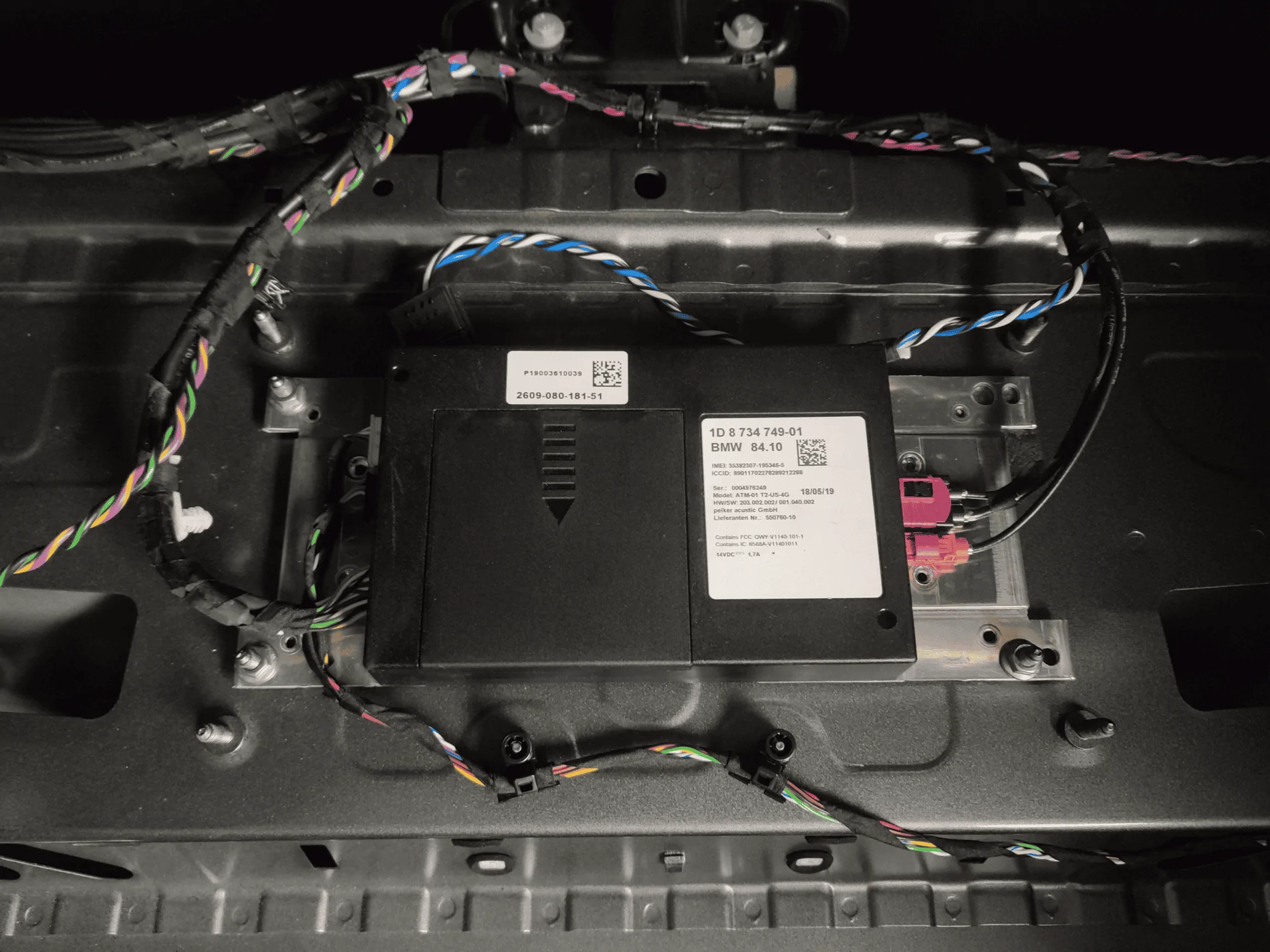

So who knows where this internal modem/antenna is???
Has to be over air.
I have no supra or toyota apps on my phone. Had not even unlocked my doors since thanksgiving. Carplay was MIA 12/5
I have not driven again this week at all. so it may be back. Just really like to put tinfoil over this antenna or whatever.
-"I may be paranoid, but am I paranoid enough?"
It's in the trunk under the panel (where the battery is) just forward of the battery. I would be careful with how much you handicap the unit, I seem to remember @Guff had some issues with the car working correctly when the thing wasn't connected.
Edit: Looks like it sits under the subwoofer enclosure, between the speakers

Over in BMW world, that was called the TCU, the Telematics Control Unit. And it does have LTE cell capability, most certainly. It's how the Emergency Call button connects to BMW Assist, among other features.
Pro tip: these contain a rechargeable, Li/Ion battery. And when that battery goes bad, it throws a non-clearable, yellow code with some vague message to have the dealer inspect the vehicle. Ask me how I know... (on a '17 440i).
FYI Guff had also mentioned and took a picture of it in the link, i quoted.
Stupid question for you. Do you think/know if alternator and battery tender recharges this battery? I'd like to think so, but since you have experience on this, I'm curious...
Yes, it is charged by the electrical system, for sure. I've seen more than a few of these go bad (throwing a code) over the last few years, most were 3-5 years old.
I'm only guessing - based on experience with lithium batteries from the Radio Control world - that BMW keeps this battery basically fully-charged somewhere around 4.2V/cell. That's not great for Li/Ion batteries long-term. At that voltage, they slowly develop problems if kept at that potential, from lithium plating and electrolyte degradation. Better to routinely cycle these batteries, like your cellphone and laptop do. As this battery isn't really cycled (that I know of), its not surprising they tend fail after a few years.
