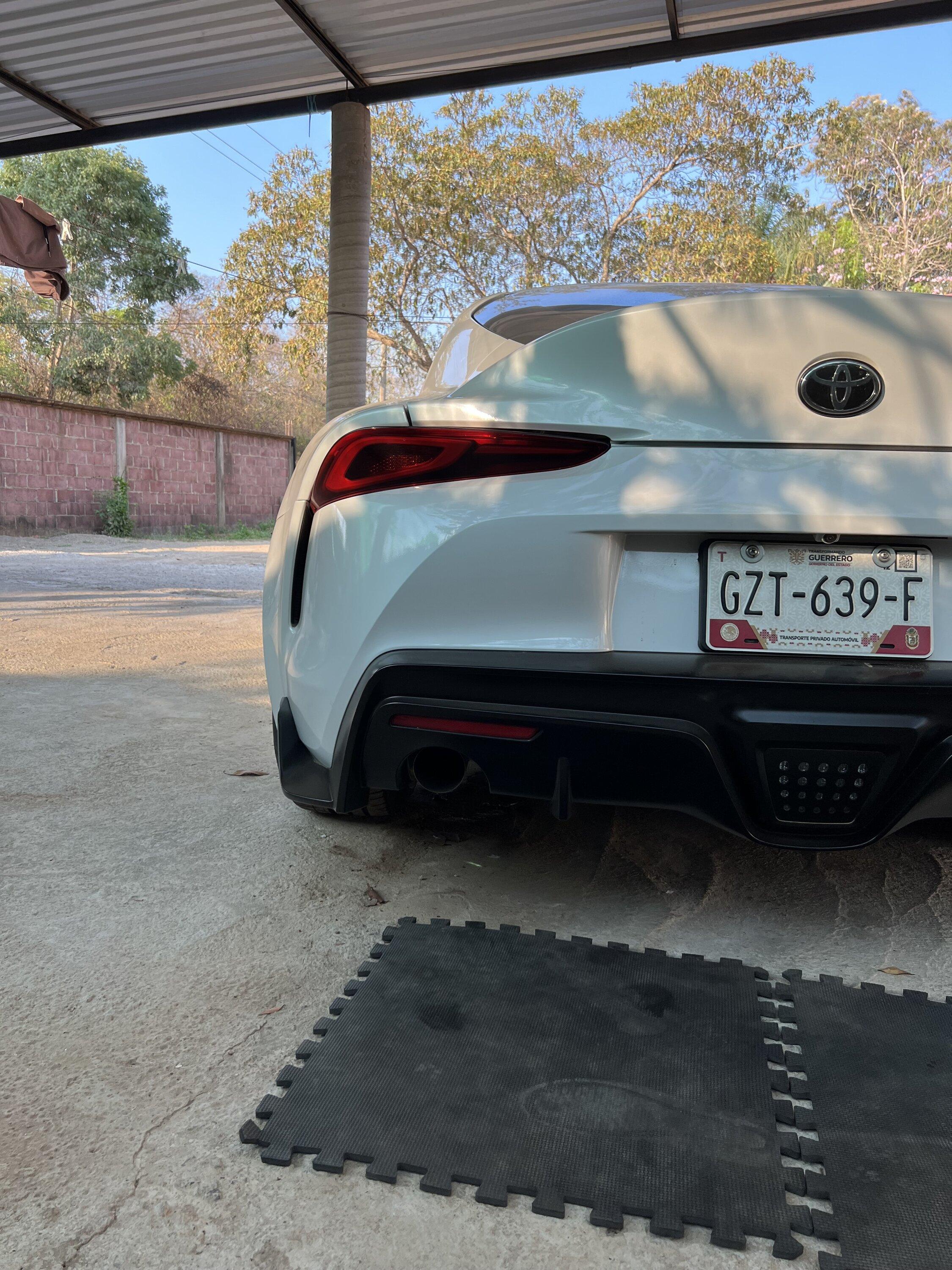

Adjust the bump stops above the tail lights. you can turn them with your hands.

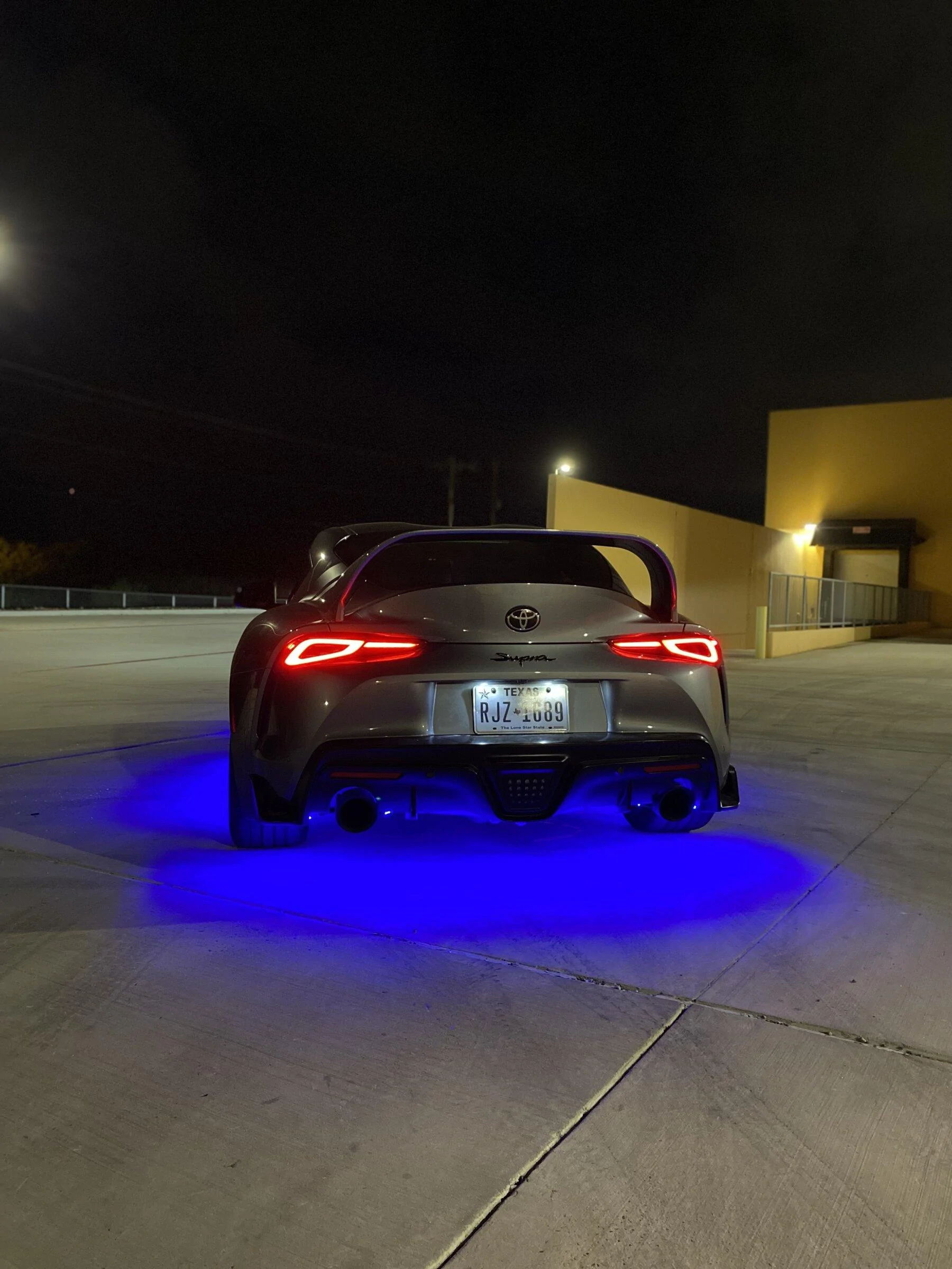

my bad havent checked this its the lighting trendz flow series with a blueghozt. pretty cool functions I dont know how to upload a video but i have a function for my turn signals and for when i brake love the look.Your underglow looks more even than most. Can you post more pics?

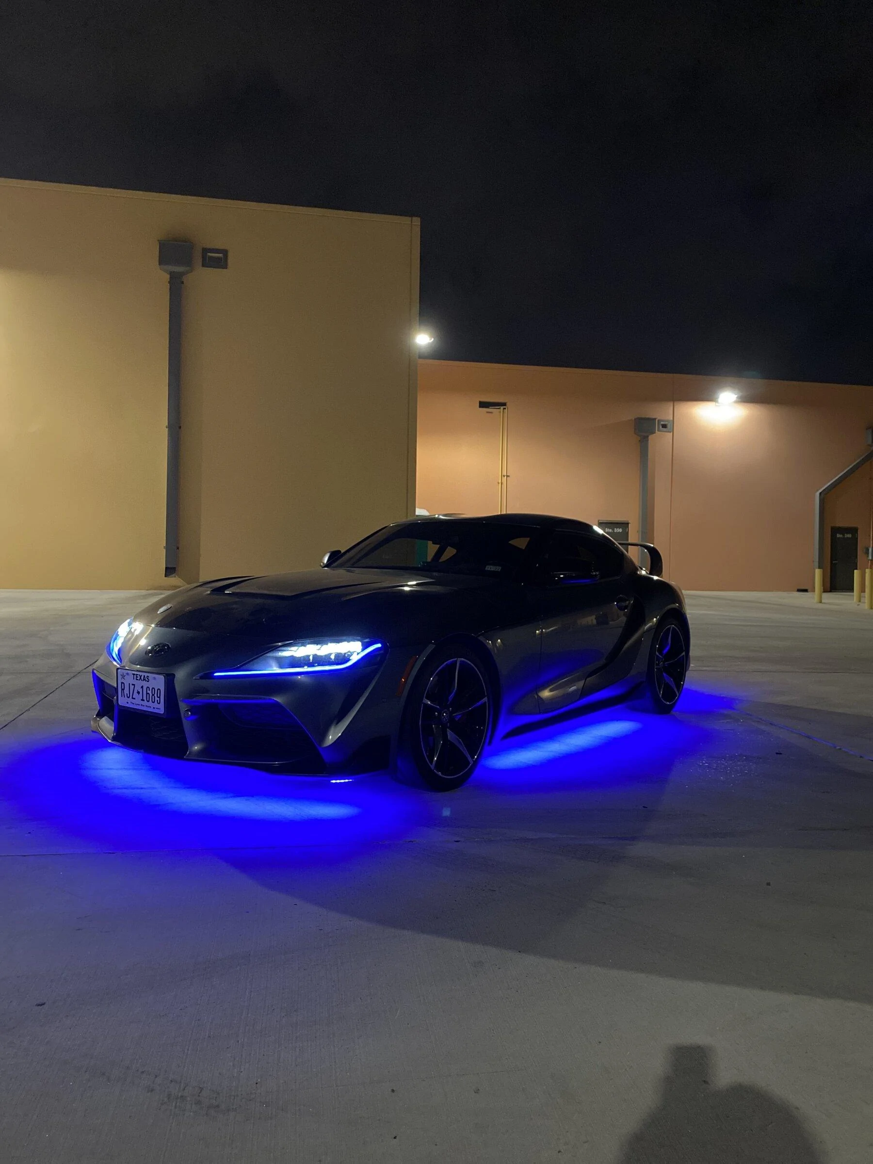

What do you mean he left something in the latch? I have the same issue after underglow installed and have a gapUpdate: got the underglow installed and trunk fixed, it seemed like he had left something in the latch area that was blocking it from closing completely. Regardless it has been an interesting few days but its finally all squared away thankfully. This is how it came out
What they ended up fixing ? Iāve read the whole story and didnāt see anything about the soluciĆ³n, I have the same problemUpdate: got the underglow installed and trunk fixed, it seemed like he had left something in the latch area that was blocking it from closing completely. Regardless it has been an interesting few days but its finally all squared away thankfully. This is how it came out
On mine the rubber around the hatch looked from the outside as if it was in completely but it wasn't. I hopped in the hatch and noticed it wasn't pressed down completely. The dealer couldn't even figure out why mine wasn't closing. They kept telling me the latch wasn't lined up correctly. The rubber around the hatch is very difficult to get it to press down completely. I used a butter knife.What they ended up fixing ? Iāve read the whole story and didnāt see anything about the soluciĆ³n, I have the same problem
Thatās exactly what I was thinkingOn mine the rubber around the hatch looked from the outside as if it was in completely but it wasn't. I hopped in the hatch and noticed it wasn't pressed down completely. The dealer couldn't even figure out why mine wasn't closing. They kept telling me the latch wasn't lined up correctly. The rubber around the hatch is very difficult to get it to press down completely. I used a butter knife.
You fixed it by just cutting into the plastic around where the latch closes ?I fixed it, notification is gone and the latch was aligned and the strip was raised so I fixed it
