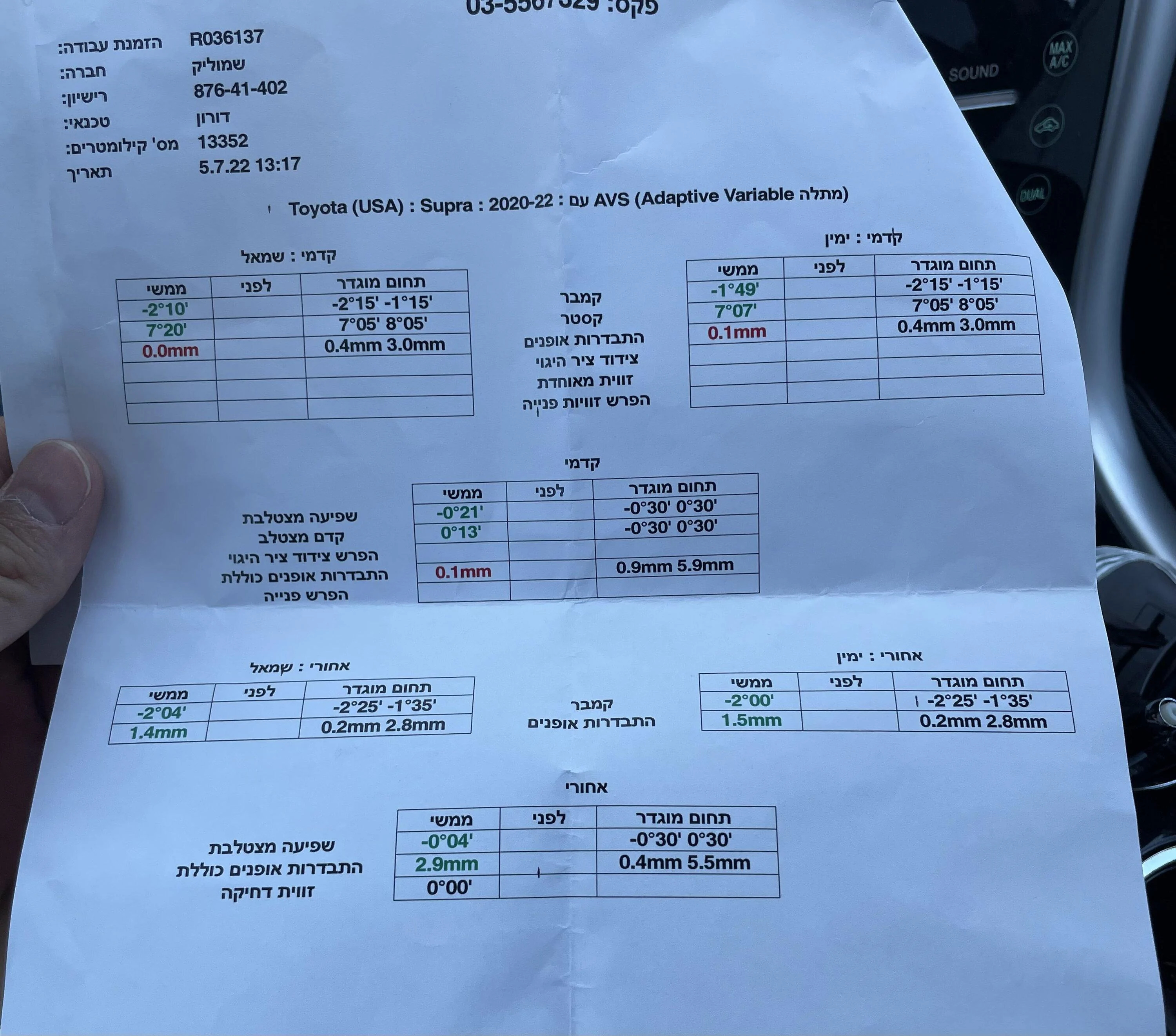

you on stock suspension?
can you share your alignment specs?

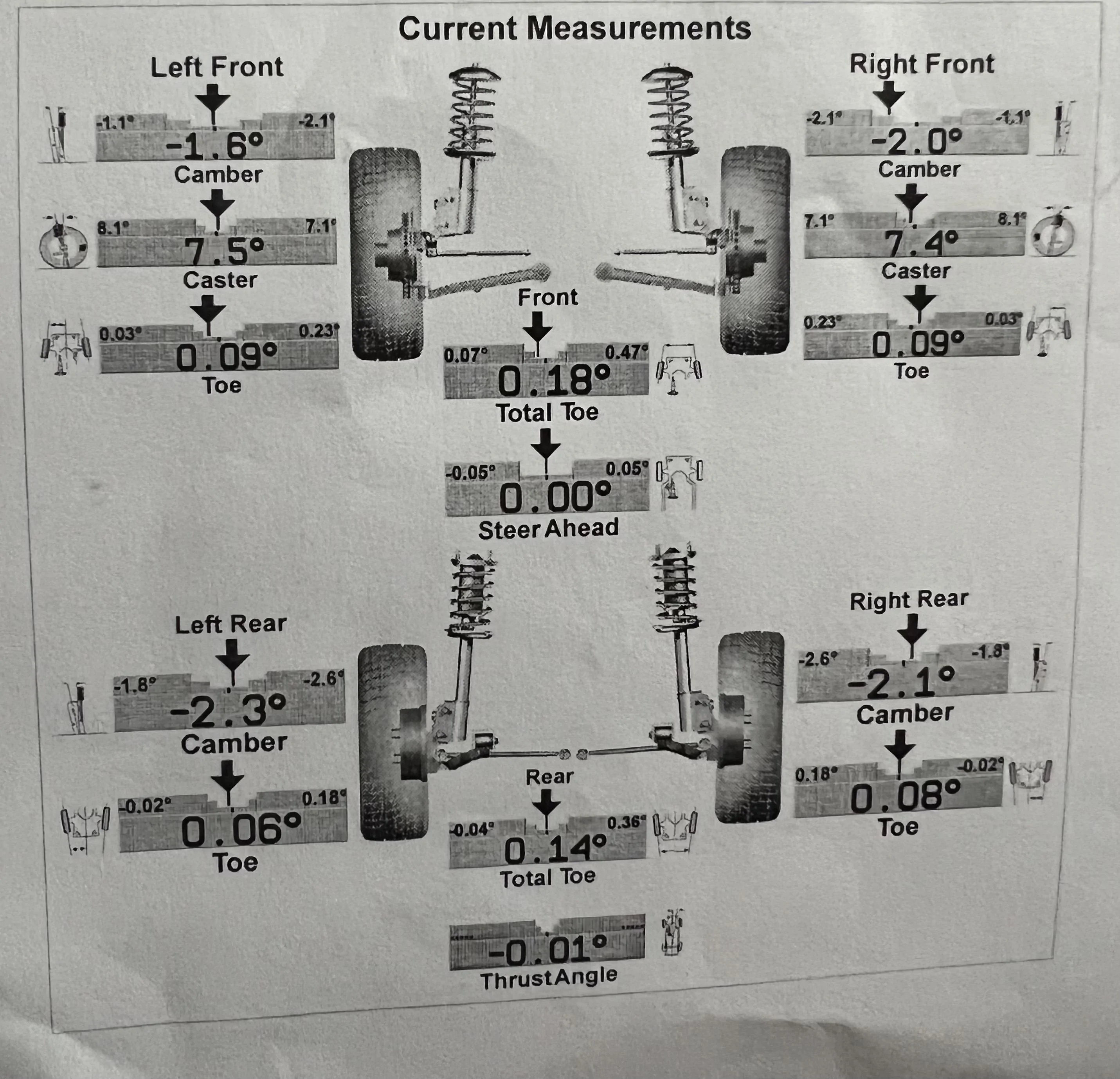

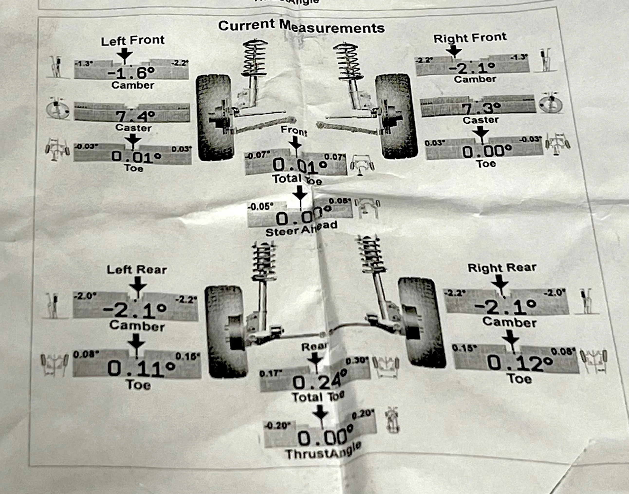

Im having this issue today at the track not sure if it was my alignment or need anti roil bars or the track conditions. 1 month ago car was perfect and was very happy. Did another alignment and attended the same track event today. Car did not show the confidence I had last time. On the my first session got off the track after 3 laps.

i did an alifnment also last week
the car feels much better
its not for track, only fast street driving
my toe in, in the back, is in MM
its 0.112 degrees each side
i hope you understand, if not please ask

This is the original alignment I did right after I purchased the car in 2021. The car handled perfect. I discussed this with Jackie Ding who races a GR Supra. He said this is with in spec to his costumers car Look at the Toe.

This is the original alignment I did right after I purchased the car in 2021. The car handled perfect. I discussed this with Jakie Ding who races a GR Supra. He said this is with in spec to his costumers car Look at the Toe.
thats perfect
almost the same like me, why did you change it?
